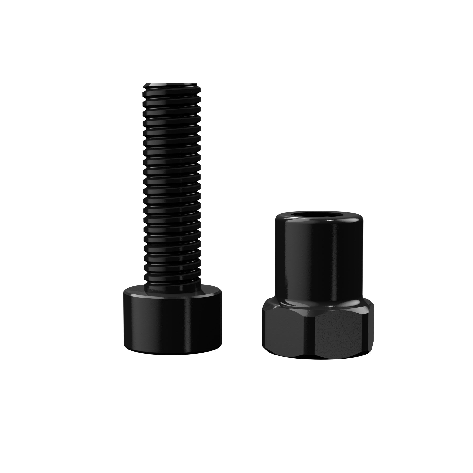

Ergon makes short grips for the Rohloff shifter.
Ergon GC1 Rohloff/Nexus Grips:​
I've used this several times to pop a perfect hole in a grip to facilitate a bar end mirror
Mac Tools MAC NO. GC950 11pc Punch Set
I just lube it with silicone grease and pound it through with the grip resting on a block of wood

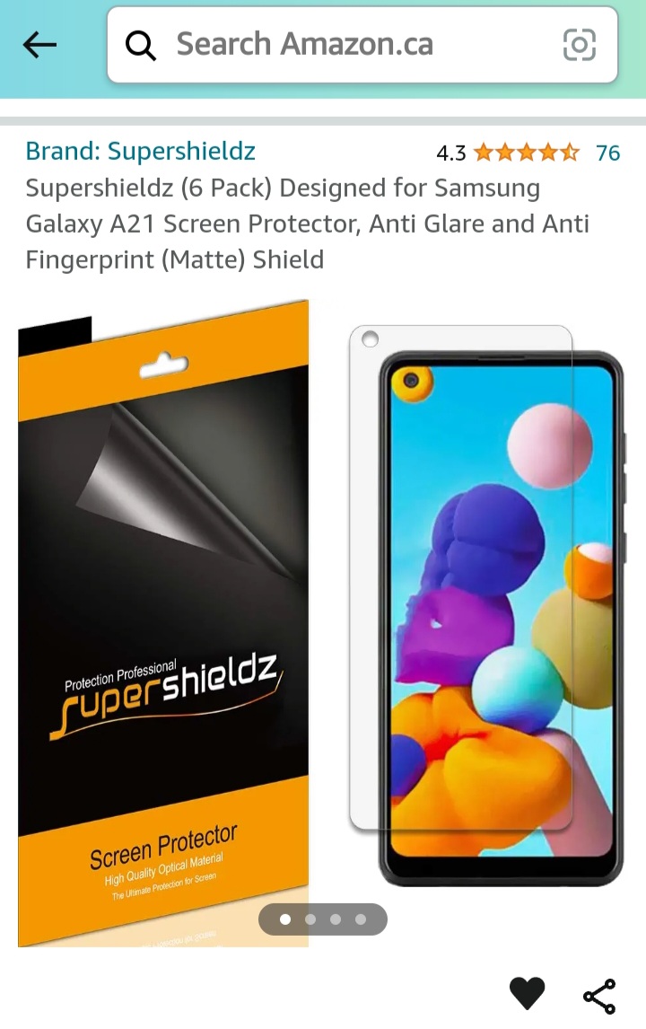

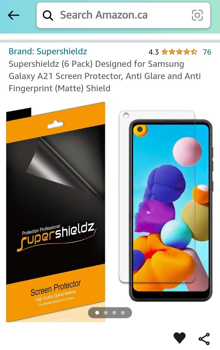

My wife's biggest beef with her Photon is the display, which washes out on sunny days.
I put an Anti-Glare screen protector on my display.
It was for my phone, but was big enough to cover my display. I just had to trim it.
It made a big difference, and wasn't too expensive.
(Make sure you get Anti-Glare, not the regular screen protector.)

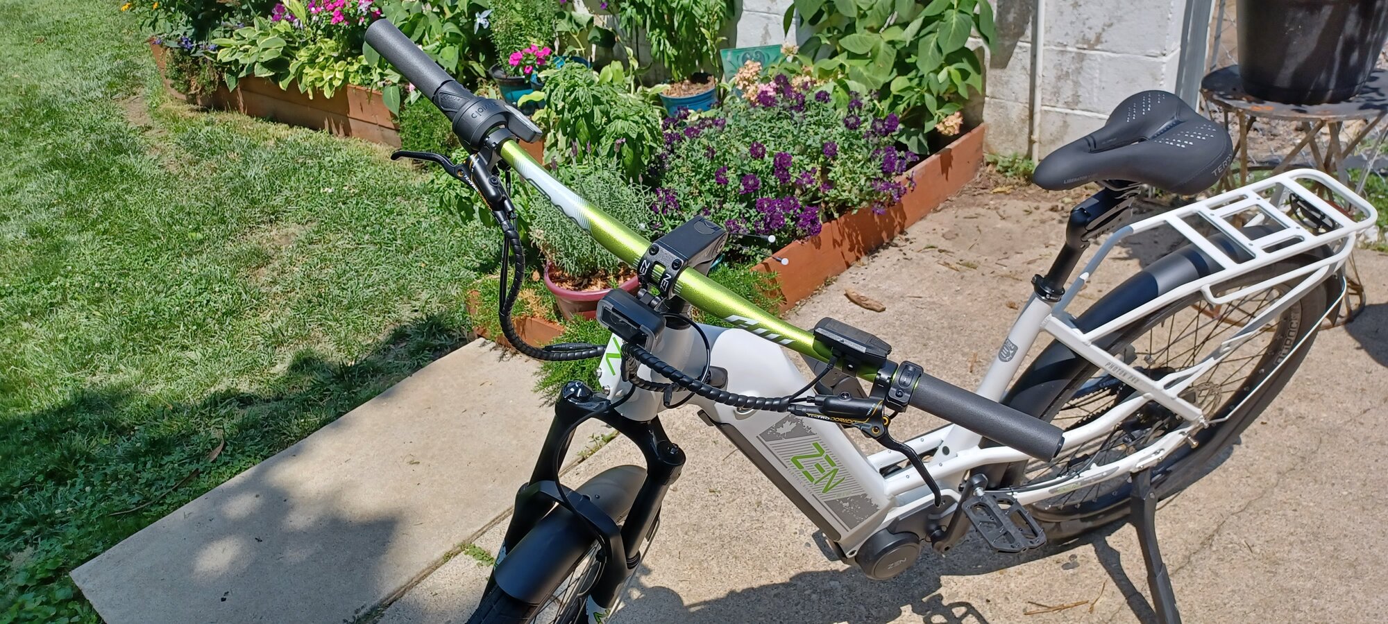

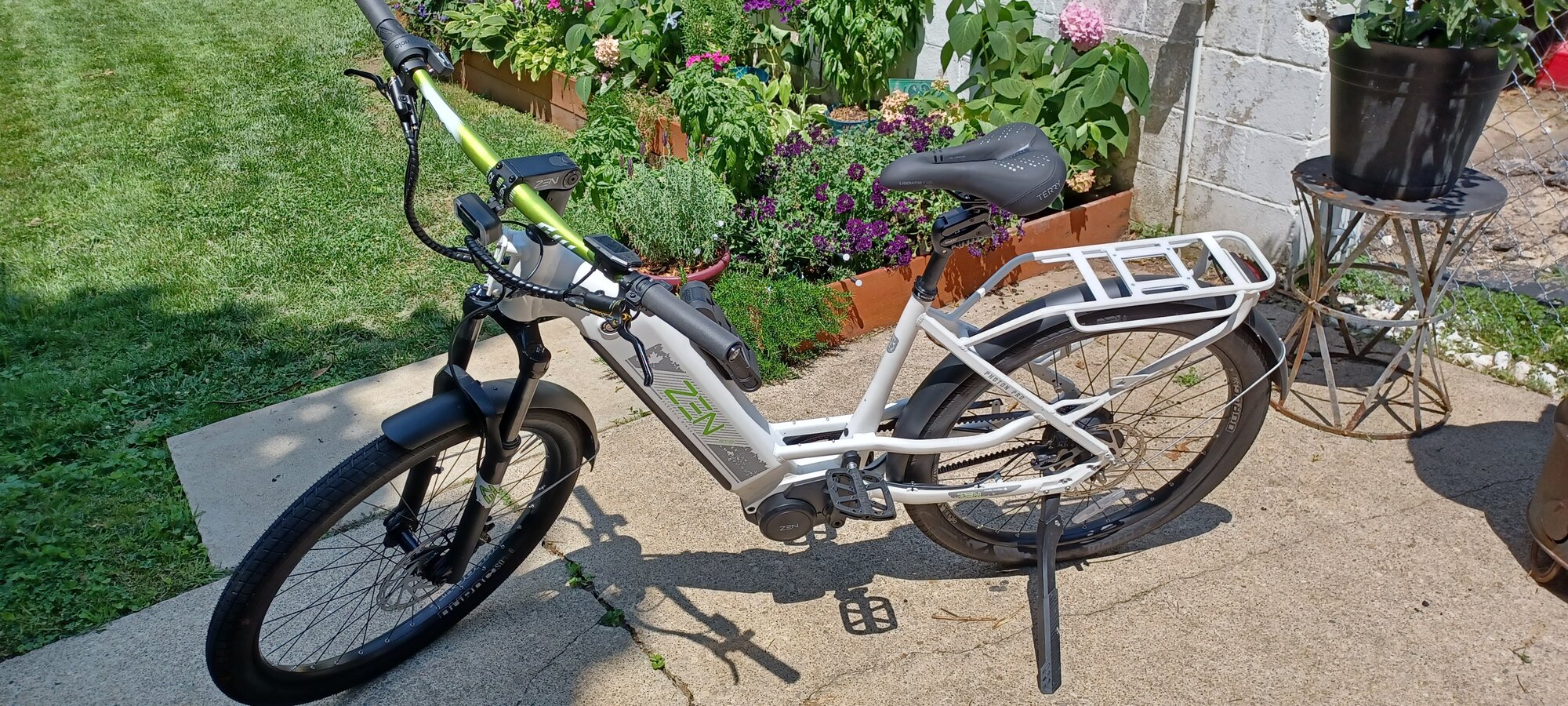

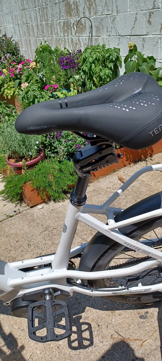

I just updated my contact points. Handlebar, grips, saddle.
Wider, flatter bars. 780mm wide, 8 degree backsweep, 5 degree upsweep.
Silicone grips.
Terry Liberator Y gel saddle.

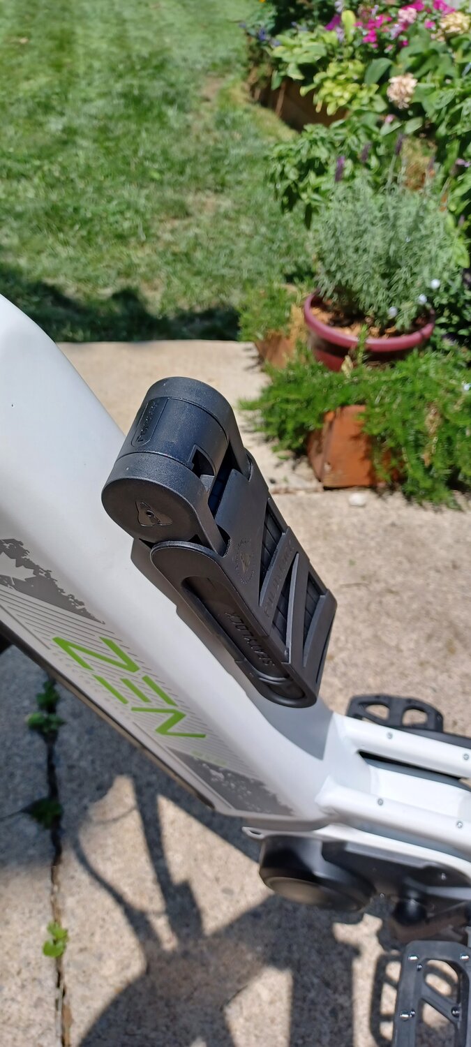

I did install a seat post clamp as well. QR would not stop slipping. Yes, greased. 😛
More reach means I'm not as upright.
Wider, flatter bars have also made the bike more responsive when turning.
I agree the pedals are very aggressive. Even more so than what I'm running on my gravel hybrid. I like them.

That’s a saddle brand I’ve not happened upon so far—looks a lot like several I did see in some other lines investigated.
You moved in the “hot rod” more aggressive riding position direction. The Photon feels about right for an upright relaxed position. I’ve been trying to do the exact opposite on my Spot Acme, turning it from more of a crotch rocket to a relaxed cruiser, with mixed results at best.
I have some more aggressive pedals on my Spot Acme, but the pedals are about 2” lower to the ground and I don’t seem to get caught up on them as easily. It is nice being able to put your foot on the ground without leaving the seat on something like the Spot and other non-electric bikes. That is a bit of an adjustment on the Photon after being accustomed to putting a foot down easily while still seated. This old dog is not as good at learning new tricks…

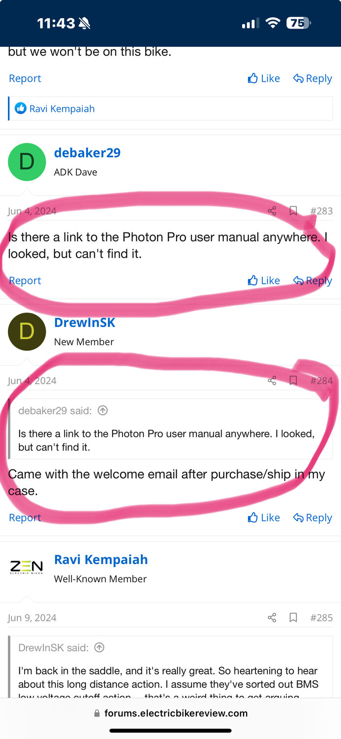

Have not done anything yet beyond turn on and toggle between 0/1/2 assist level. It would have been nice had they included an owners manual…
Apparently, it’s available to download—just asked my dealer a moment ago to see if it was included on an email to him.
Saw this on another thread:
