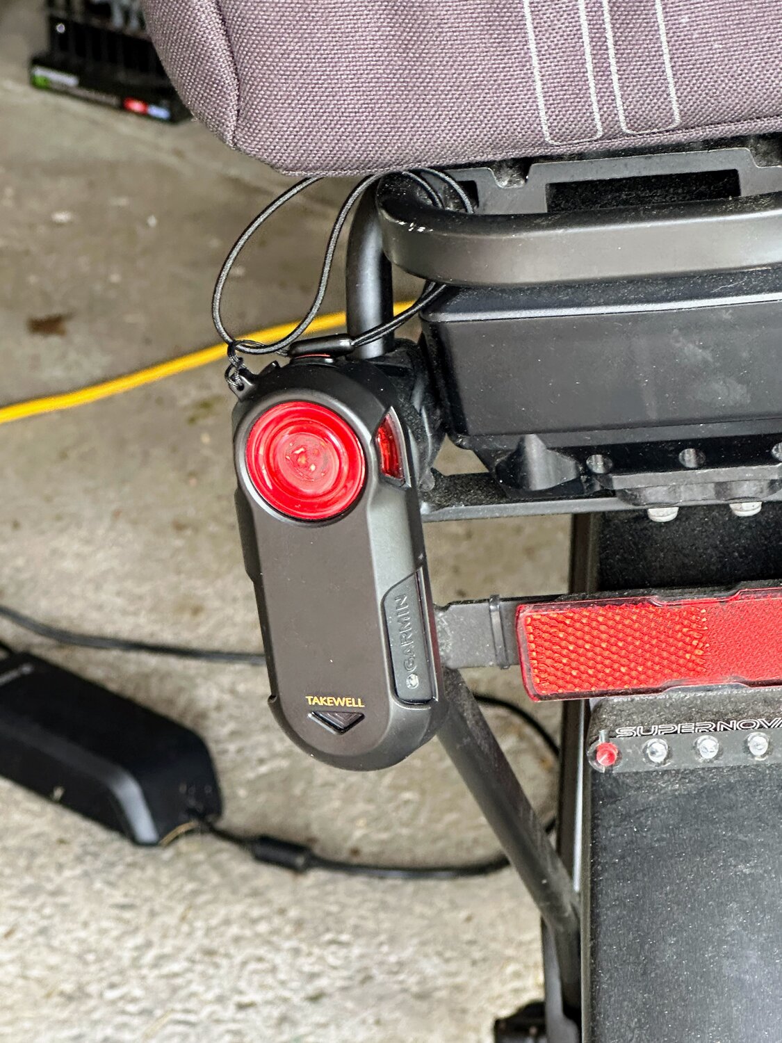

I was wondering if anyone has mounted a Garmin Varia rtl515 to their Supercharger 2 or other Riese and Muller rack? Looking for ideas.

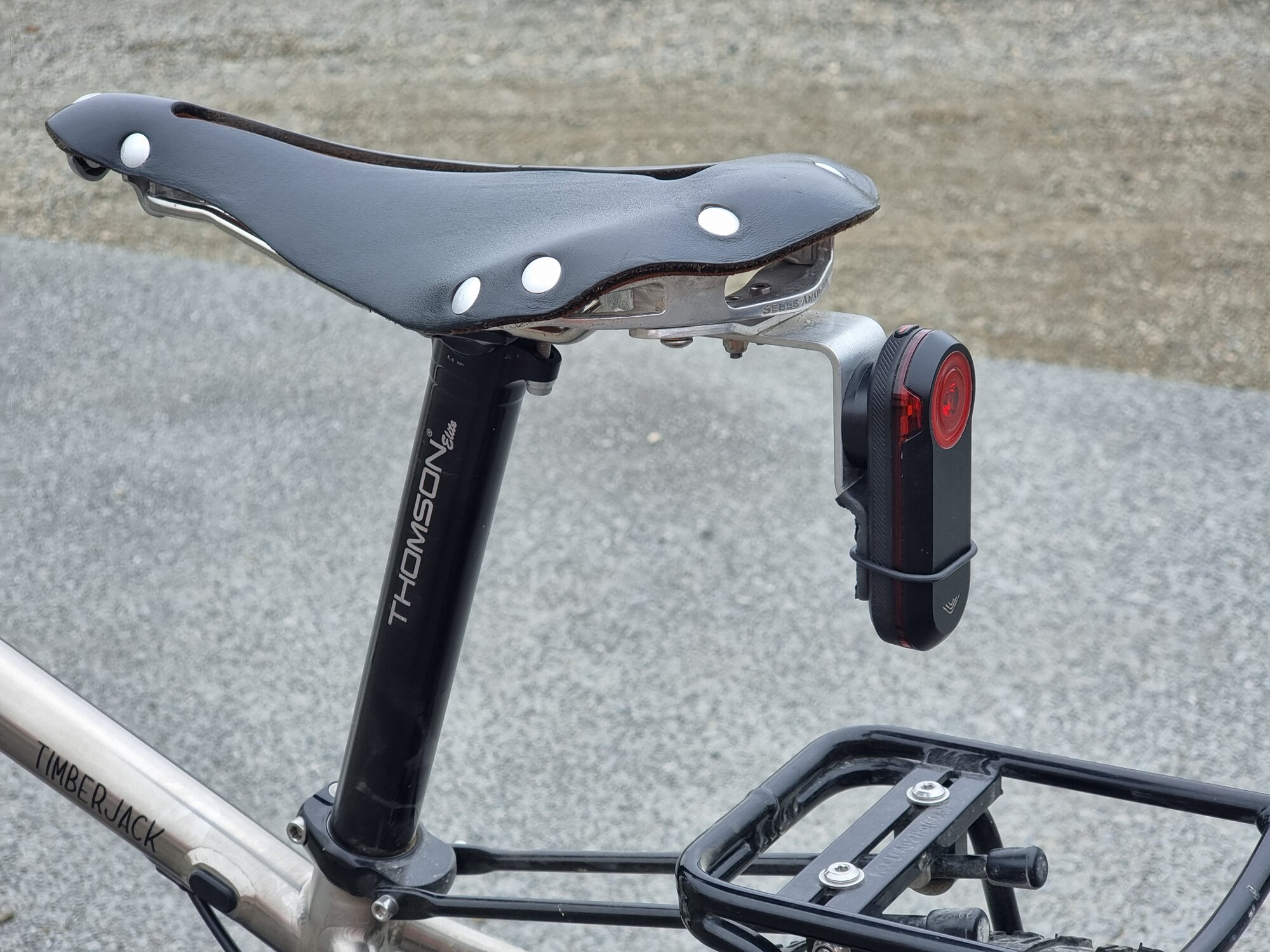

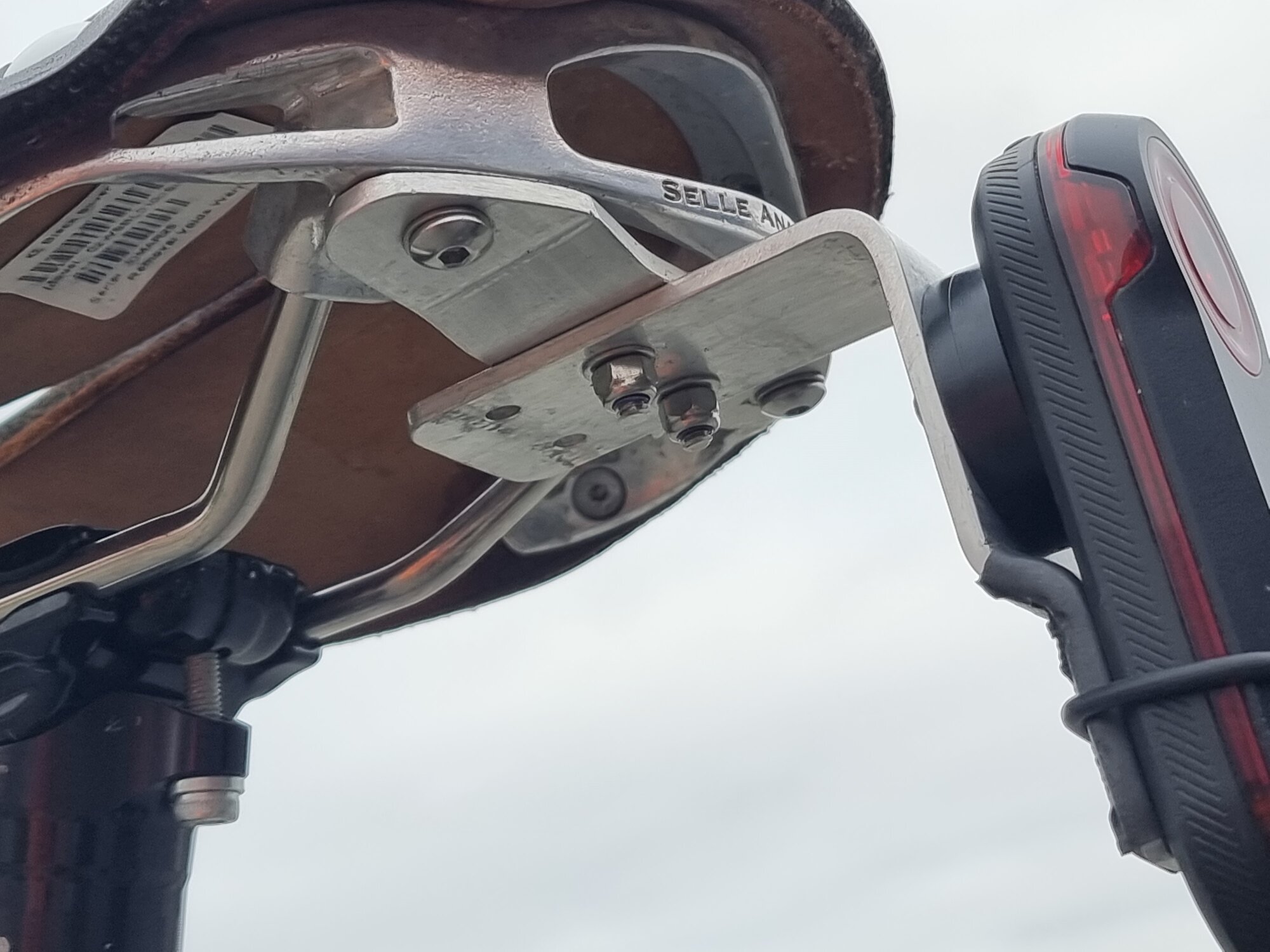

I haven't put one on the rack, but my Supercharger has 4 holes where the tail light is fitted and I'm sure you could make a bracket to fit. I've attached a couple of photos my mount I made for my Selle Anatomica saddle on my Timberjack, it was made so I could fit a tool bag under the saddle. I drilled and tapped the frame of the saddle as there is plenty of meat there. Note the kink where the light is fitted. The first attempt stopped just after the mount, but I found that the light kept getting bumped and I frequently found it ready to pop out of the mount. A large o-ring keeps it in place, with a bit of old inner tube to stop the vibration. Difficult getting the bends exactly right as I did not want the o-ring putting pressure on the mount. It works well.

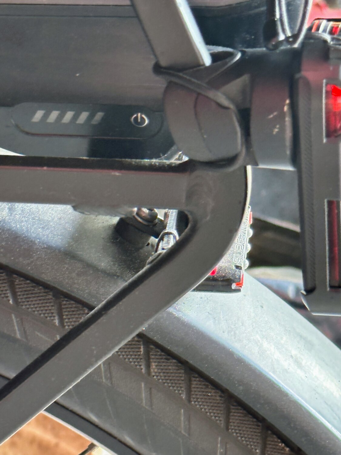

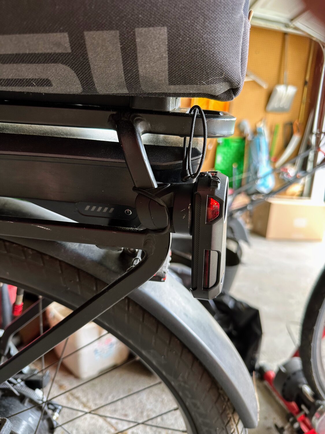

I couldn't use a seatpost mount since my trunk bag would block it. This works for me on an R&M Nevo 3. Also tethered the Garmin.

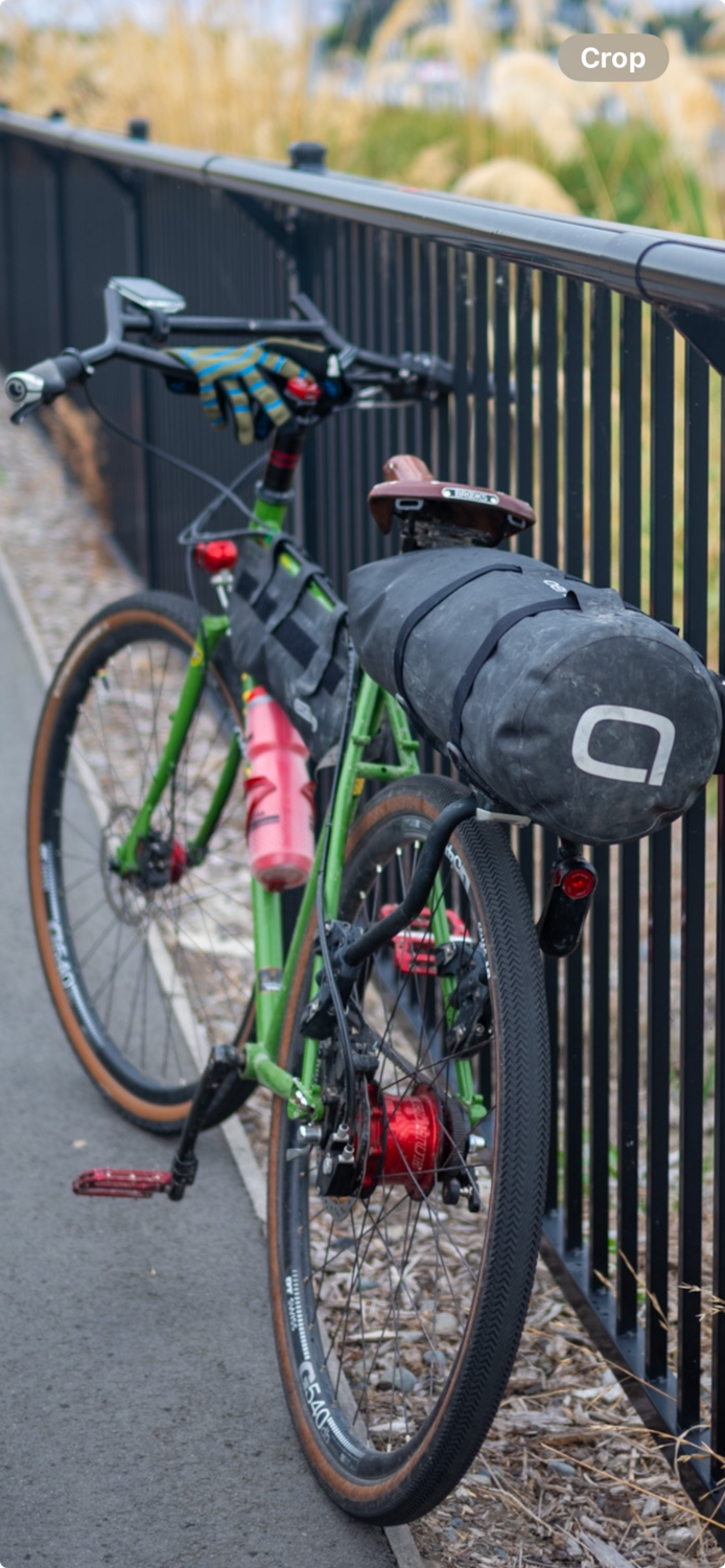

I’ve used the under saddle bracket on one of my bikes and on my gravel bikepacking rig I mount it to my Aeroe rack using a Garmin mount.
