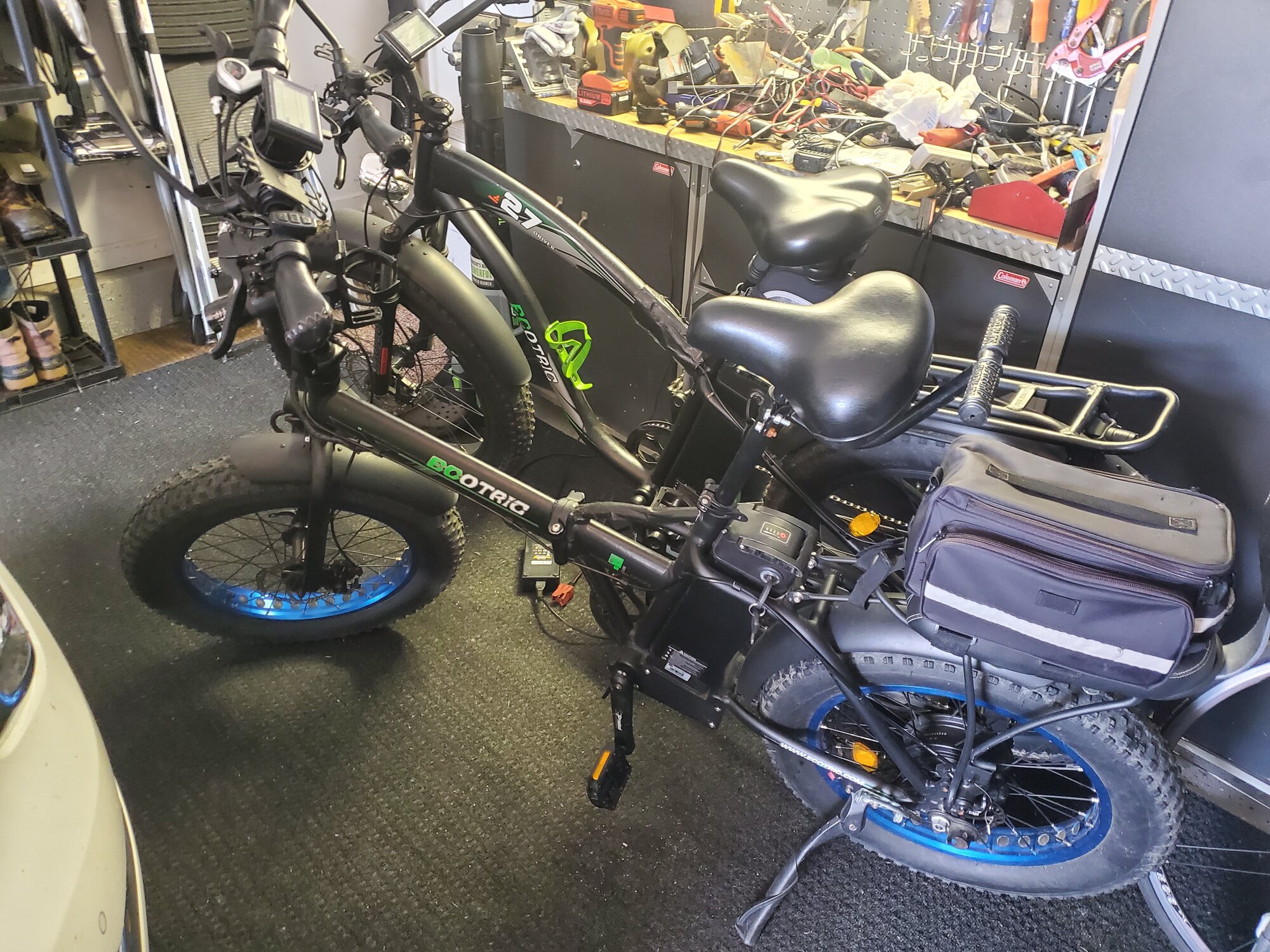

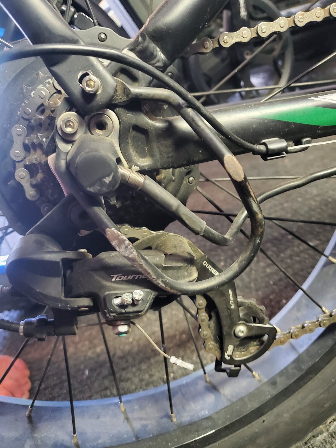

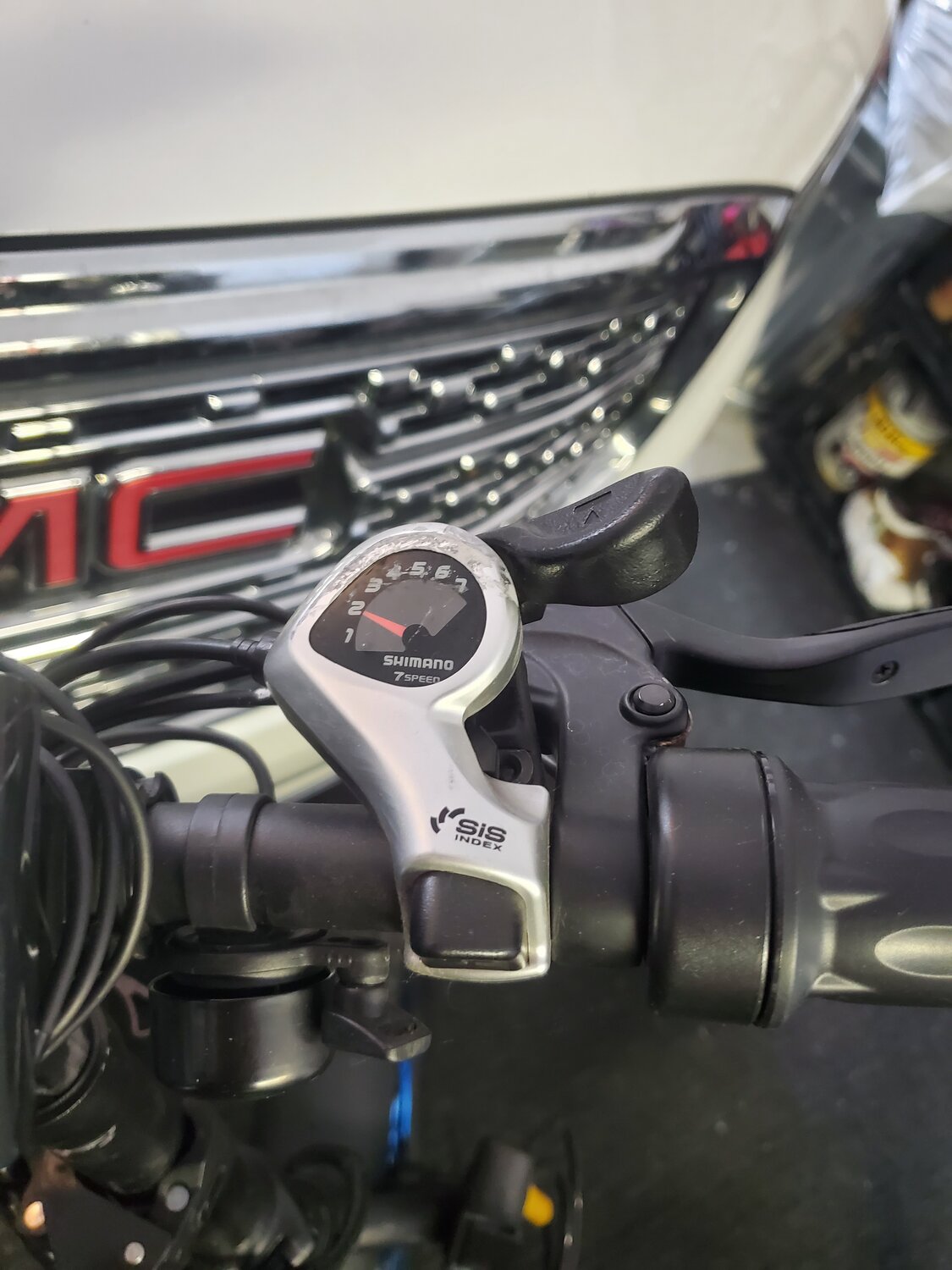

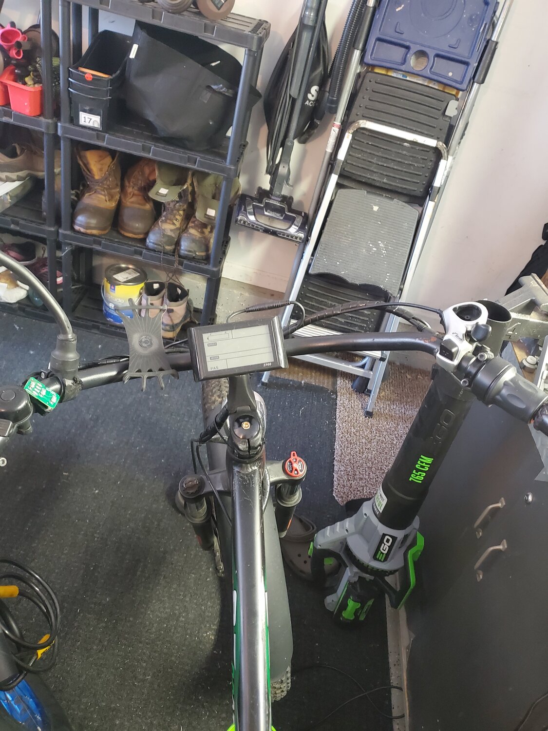

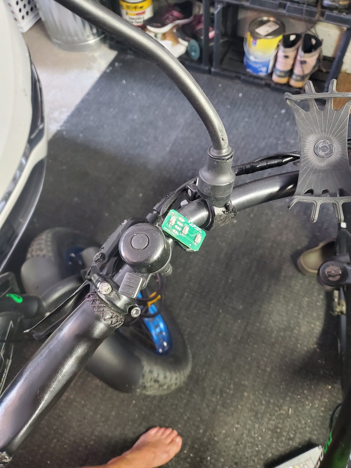

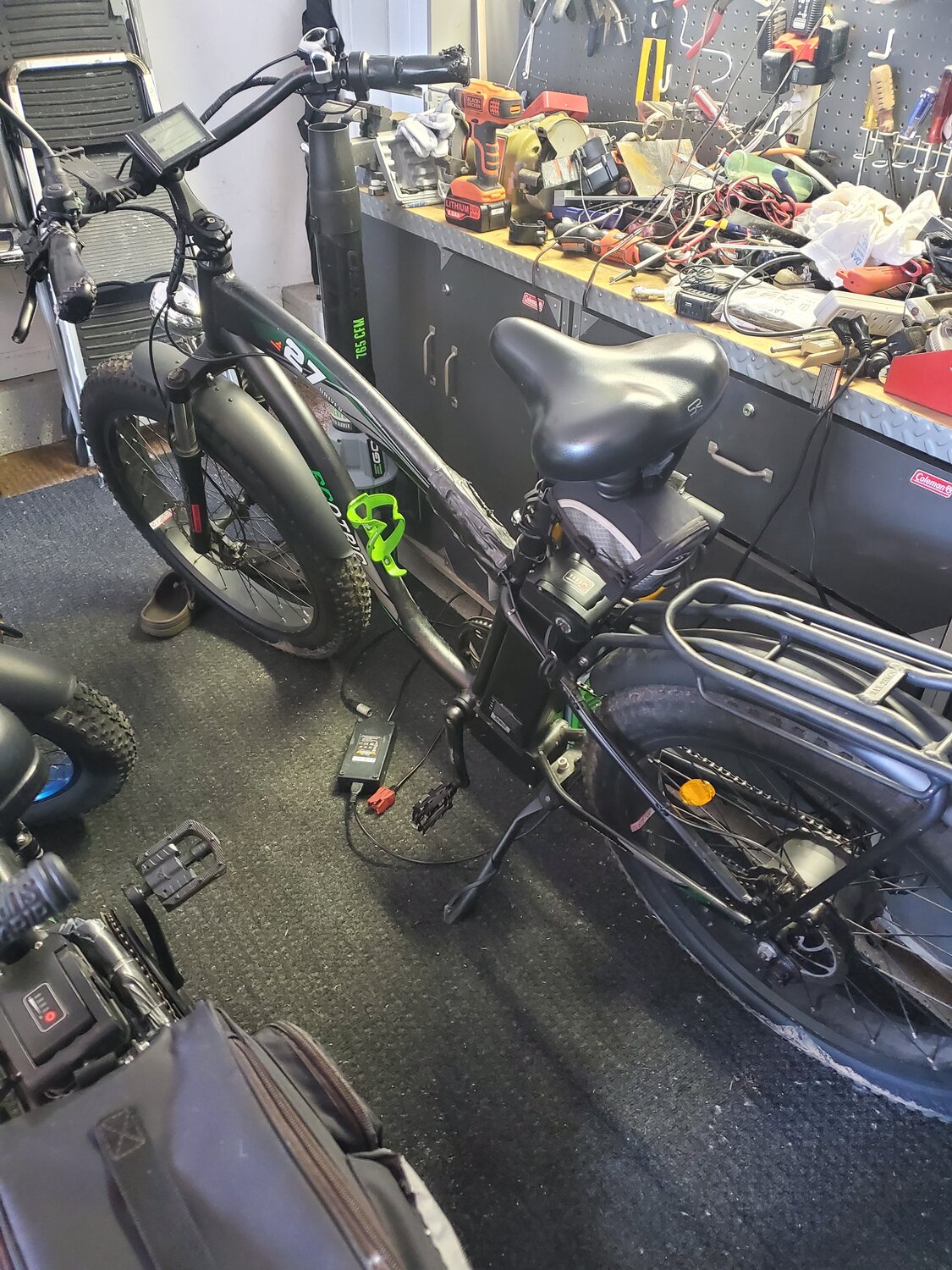

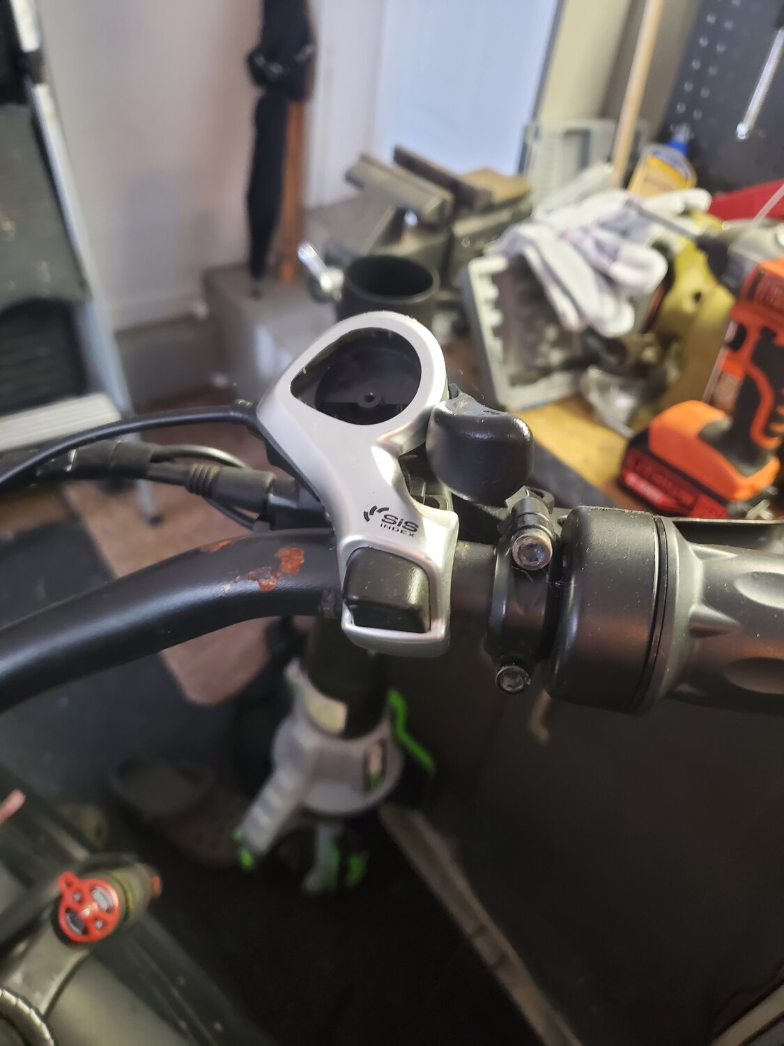

Hi,
I am 63 years old and in 2020 I bought a inexpensive Ecotric 27 Hammer for myself and the matching smalling folding Ecotric bike for my wife. My Hammer some how fell off my bike rake on the highway and not get run over. The bike is rideable, on/off/shifter button cover went missing, the gear shifter got damaged and does shift gears, I can turn the bike on but it will not stay working. When I put the Hammer battery in my wifes bike it will do the same thing and turn on but quickly turns off and not work. It seems like the battery is damaged. My wifes battery will not fit in my hammer, so I can verify that the Hammer battery is damaged.
Any advice on repairing my bike or should I just replace?

Since you are not familiar with electric bike or bicycle innards and components, you should replace it.
I build my bikes from the frame up so I could deal with something like this, but it would be a long process of diagnosis that could probably get really ugly in terms of figuring out which electrical components are damaged, if the problem is not obvious. You could end up replacing one part after another starting at the display, working down to the wiring harness and the brake cutoffs, then to and thru the controller and so on.
Then there is the cost of diagnosing and replacing the bicycle parts. While the bike was bouncing around, did the crown race get dented on the headset? Thats not immediately obvious but will be as soon as you take a test ride. Will you know what it is you are feeling thru the bars when you feel it?
If you love a long term project, thats the only way you're going to get any measure of success out of this after a lot of trial, error and research (unless you get lucky... it could be an easy fix but you won't know until you succeed how much time, effort and money it will take). Write it off and buy another bike.

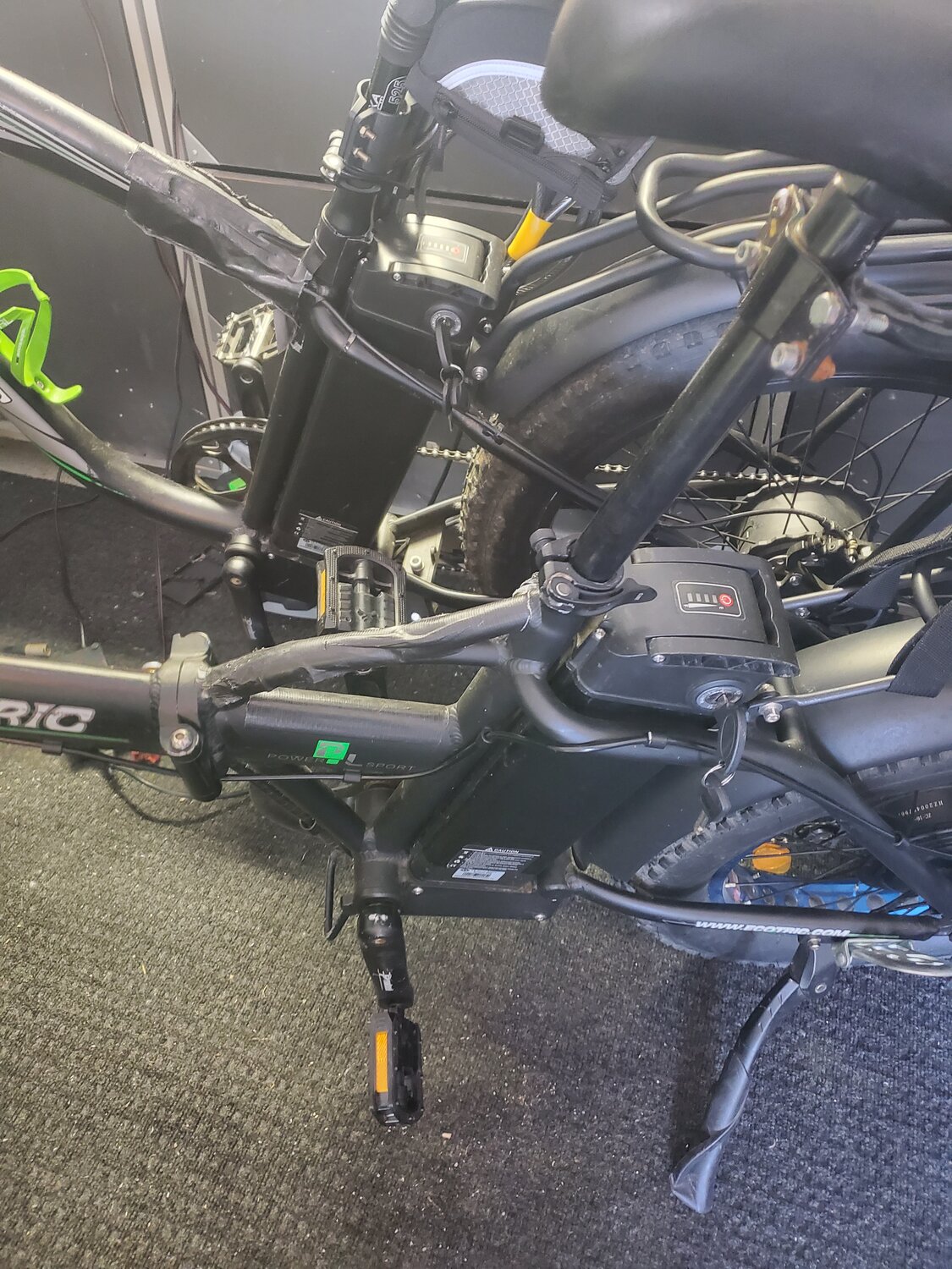

Those are commonly available silverfish batteries, so you could consider a new one for the Hammer.
These are both 48V batteries right? If your folder is 36V and the Hammer is 48V, you can't swap batteries and use that as a test. But say they're both the same. I don't see why the folder battery won't fit into the Hammer, unless it's too short for the key to turn in the locking plate. Remove that plate temporarily, Then if the Hammer powers up with the other battery, then you'll feel more confident about buying a new battery. But make sure the bike still works frist and has no cracks on the frame. Hate to see it split in half on you. A new Hammer isn't much money and you might want to try a different bike anyway,
Used to own an Ecotric 20" folder. That's why I know how the battery goes in.

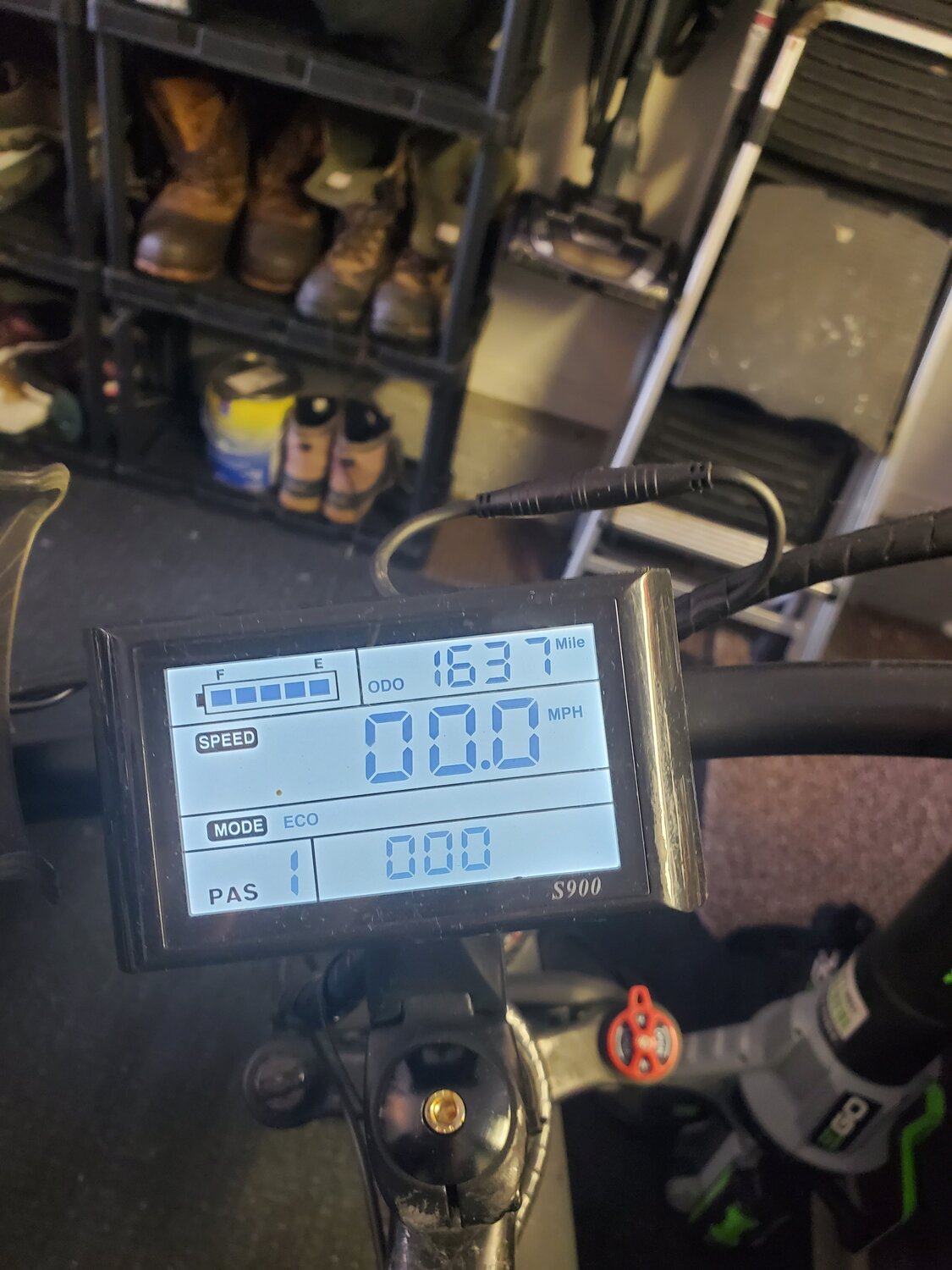

From the pictures, it seems the battery powers up, shows full charge on screen, but shuts off when you run the bike? Something broken inside. Based on what your tool bench looks like, you'll probably be looking in there. Be careful if you do. Go ask the guys at endless sphere if you want to investigate it.

Thanks for your great advice about removing the battery rail to test with my wifes bikes smaller battery. It worked great, so now I am wondering how you would recomend repairing or replacing the battery.

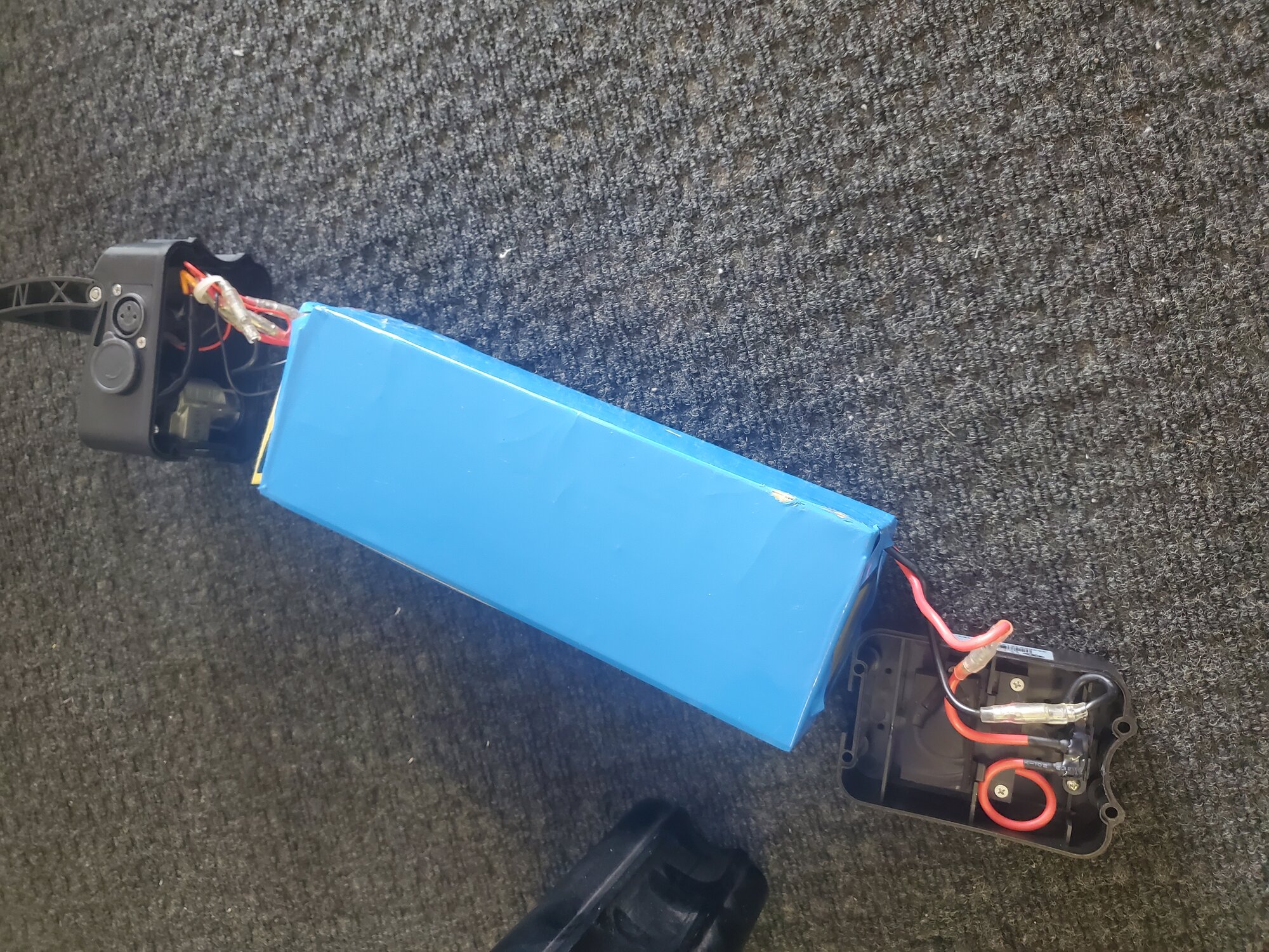

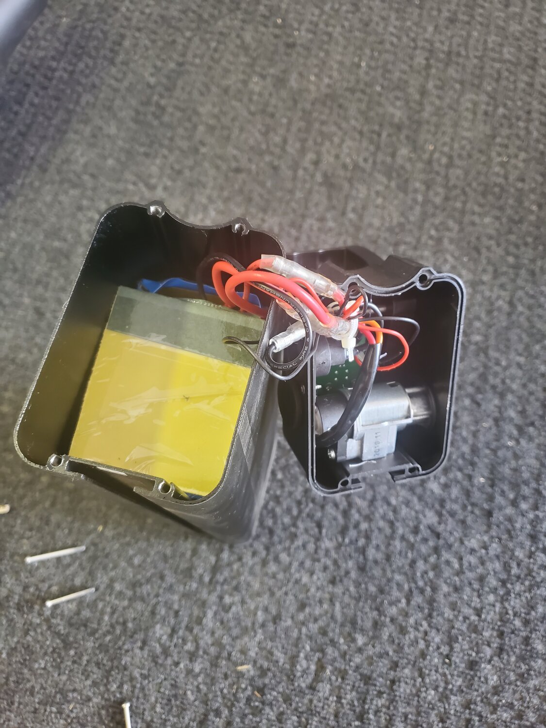

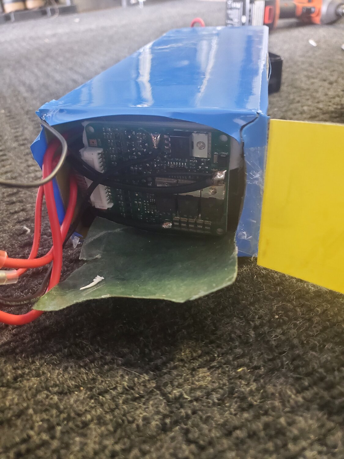

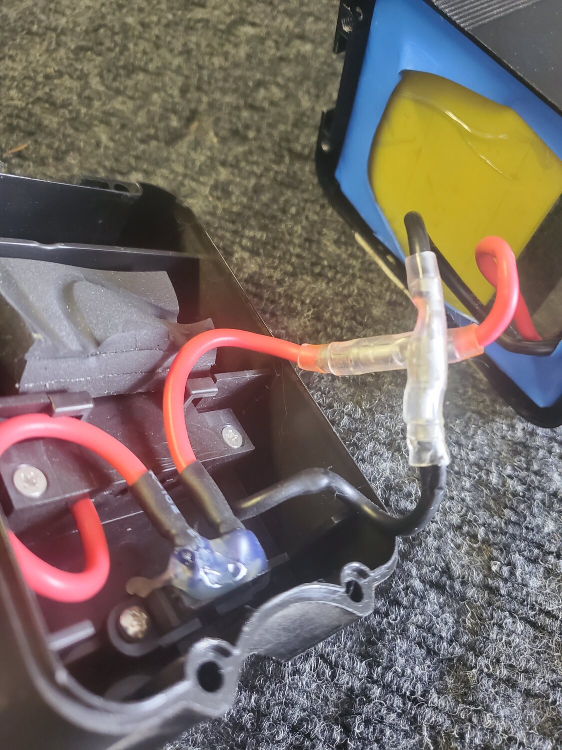

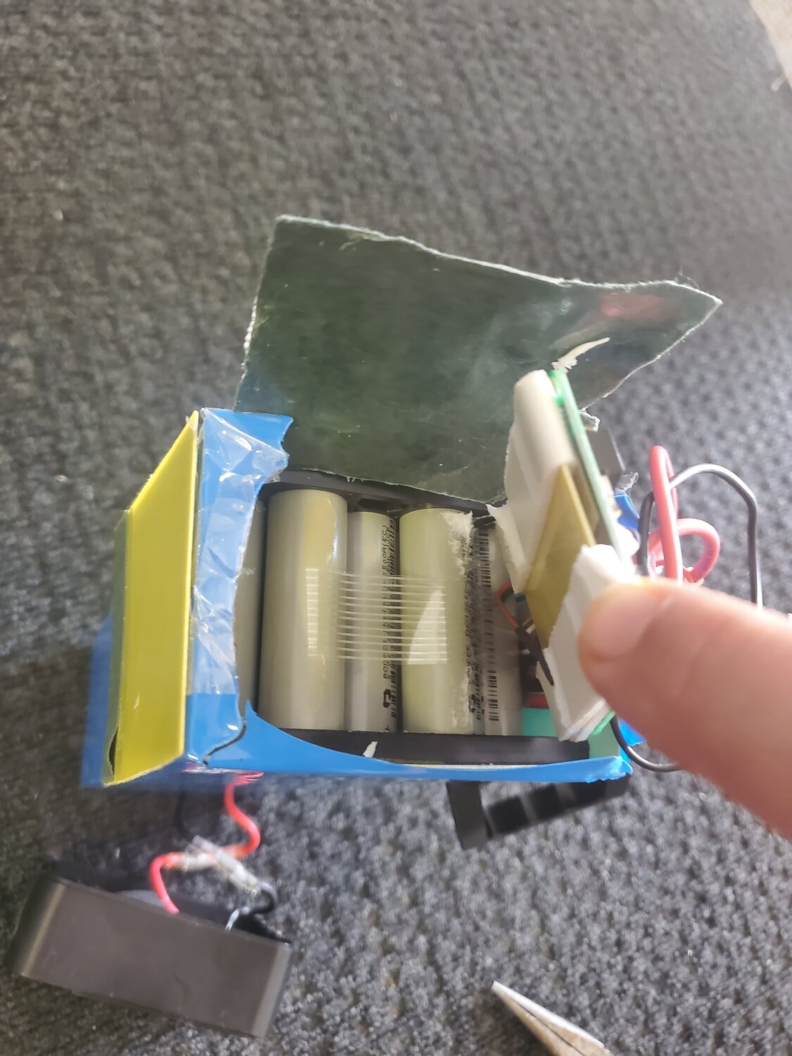

I carefully disassembled the baterry and attached pictures if this would help. I do have some electronic experience with building my own Heathkit stereo system a long time ago.

I am not trying to be a jerk here so don't take it that way. What you are doing and describing with your level of experience is almost the textbook example of how a battery fire happens.
Just for starters, if you have a short and that battery is sitting on that carpet, thats a fuel source. If doing something like this whether you know what you are doing or not, you want top do it on concrete and, if possible, in a large area with no roof structure that can burn.
And you want a big fire extinguisher on hand rated for lithium ion fires. I have a buddy who owns an ebike shop and he showed pics privately of his (very large) repair shop where a pack caught fire, and the whole shop was blanketed in powder. But it didn't burn down because he hit it hard and fast with the right tool for the job.
Believe it or not, water is actually VERY good for one of these types of fires. If caught early, low-intensity water will keep the pack temperature down so it will not put out the cells on fire, but it will prevent thermal runaway of the adjacent cells while the burning ones burn out. But you have to stand pretty much over it for a good half hour so indoors is not the place where that is going to happen.
Your battery pack is divided up into groups of probably 13 cells each (in series). Maybe 4 of those connected together in parallel. Each of those groups is welded together on the ends using a special spot welder, and impacts often damage/break those welds. Additionally each of the parallel groups has a wire coming from it to the battery management system. You can pretty much see none of that with how far you have disassembled the pack thus far.
Like I said originally, you will have to have significantly greater understanding of what you are looking at before you can be anything but dangerous. So either set this aside and start learning the ropes of battery construction (Endless Sphere is where you want to go for that) or just go buy a replacement battery with the same plugs for charging and discharging that you have now.

Neither Robertson or I want to see you get in trouble. so I don't endorse tearing into the battery, but I would like to know what happened. You said the bike powered up. What caused it to power down? Did you try to run the motor? Were you able to turn it back on with the middle start button on the SW900?

So when I try using to hammer battery in the hammer and also my wife's folding bike it powers on briefly and the throttle will power the tire but then the screen goes blank. My wife's battery works both bikes normally.
Sounds like you've isolated the trouble to the battery. The battery listing you have shared does not list which cells are being used in the pack. Only "Grade A high power cells" is extremely vague. Are they Panasonic, Sony, Tesla, Molicel, Sanyo, Samsung, LG? Those are the only branded cells I would look at. There is also no BMS info listed. You can ask the seller, but they may not be willing to disclose that information. It seems the cheaper the battery, the less info the seller provides. Also, a cheap battery is most likely not built to the highest of quality standards. Sure the battery could work well for weeks or months, but with "Grade A high power cells" they may not be matched before pack assembly and would degrade faster than higher quality cells. A pack built with unmatched cells would most likely end up having a bad cell group. You may find yourself looking for another battery pack before a year has passed. Seeking a pack built with name brand cells could avoid some of the mystery. When choosing a battery, look at quality first. Since the battery is the most expinsive part of the bike, you want to be sure it's a quality pack with quality cells. This way you can have a pack that will function the way you hoped it would.
If I were in your situation, I would check out the Ecrotic brand forum and see if anyone else has purchased a battery for the Hammer and see what battery others have used. Or even look at bikes that use the same battery and see what replacement batteries those users have purchased. My first choice would be the manufacturer, but that may not be an option if the battery style has been discontinued. Some users here have gone to @Jenny Mao , but there may be other reputable sites that I am not familiar with. Normally, you'd want to purchase your battery from a seller willing to disclose the battery cell information.
