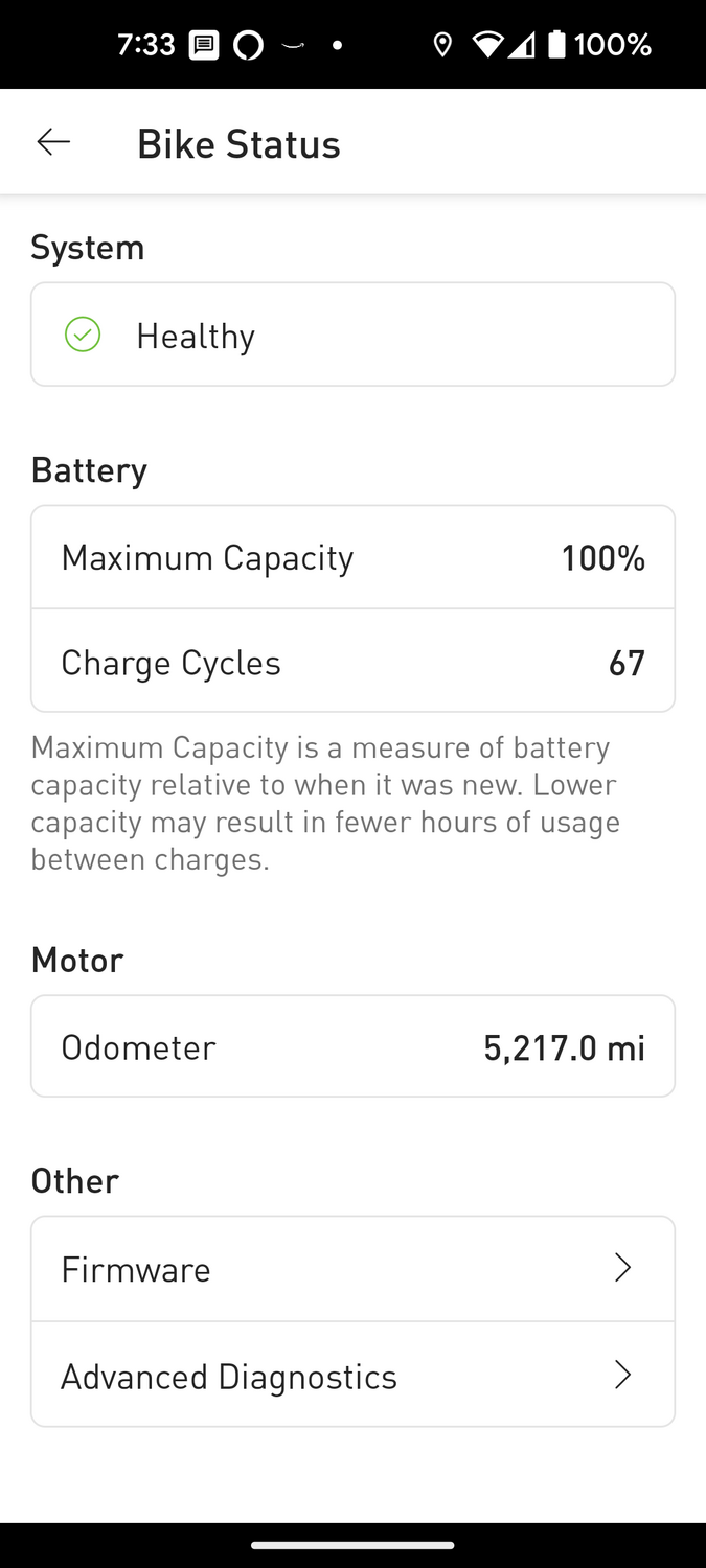

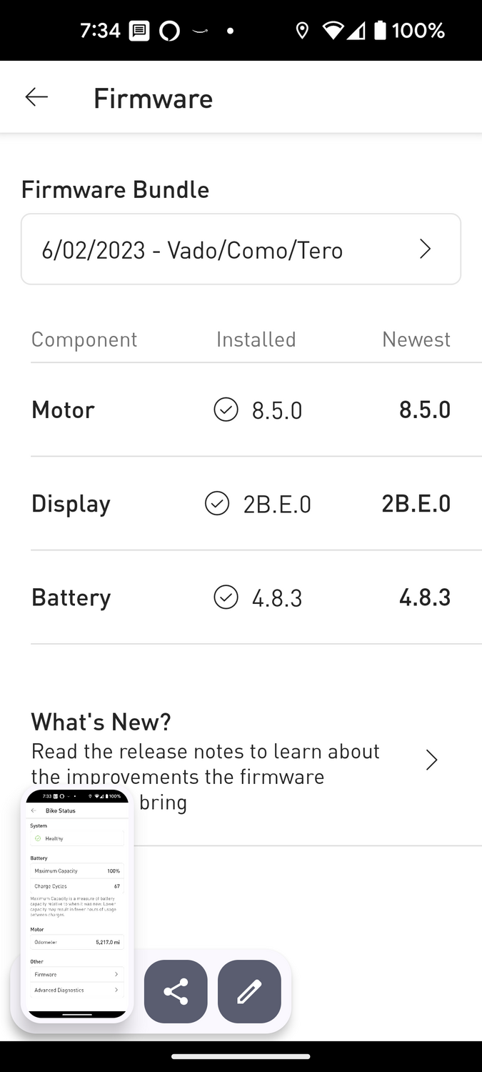

Maybe you are running an older version of the app? On Android, it now shows firmware versions. Not sure about IOS but it seems spec updates the Apple versions first. My bikes don't need an update but I"ve read on the Creo facebook page that someone recently updated their bike's firmware from home.
Are you sure that you are not still running an application called Mission control?
My specialized app is updated. I do not get those same screen options that you are showing me in the screenshots. I can no longer see the firmware, versions, or whether additional updates are available. I am running Android.
There must have been yet another update, as the App started with a screen to accept the updated Terms & Conditions. Now the App can see both my e-bikes, and it can even connect to the Tune screen :D No firmware version information though.

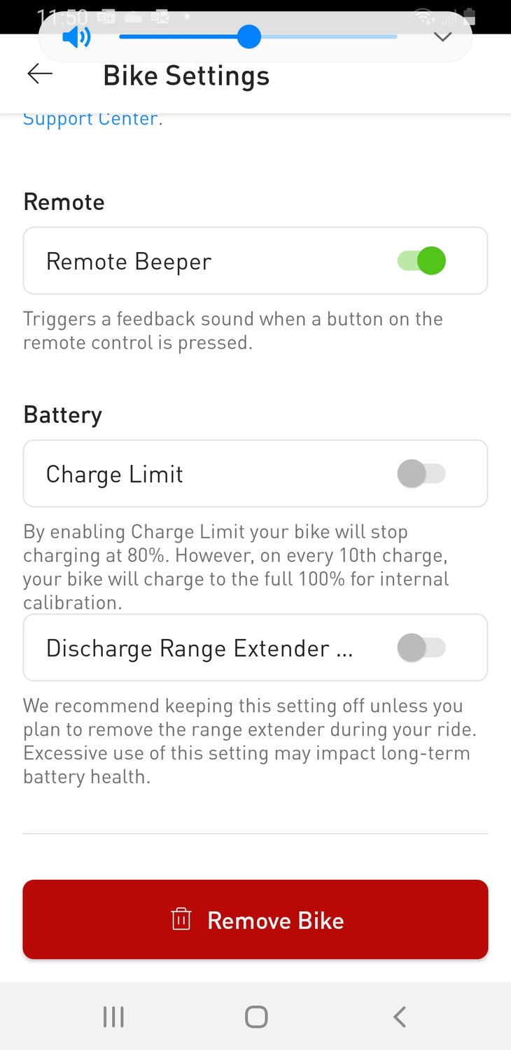

Just got an RE and wanted to set the bike to use it first.
I assume it's the option that says "Discharge Range Extender ..."
I'm guessing the whole text didn't fit on the screen for some reason.
Right. You need to activate that option then restart the e-bike.
It works very well. However, as a greater part of the Range Extender charge has been used -- and you request a lot of assistance -- the main battery will get slightly discharged, too, to make the total power demand without jeopardizing the extra battery. Also, riding with the RE disconnected will simply use the main battery.
Use both batteries in parallel for long demanding rides as you might get left with the RE discharged below 10% just in front of a serious hill! (Below 10%, the RE goes into a "very low assistance mode")
