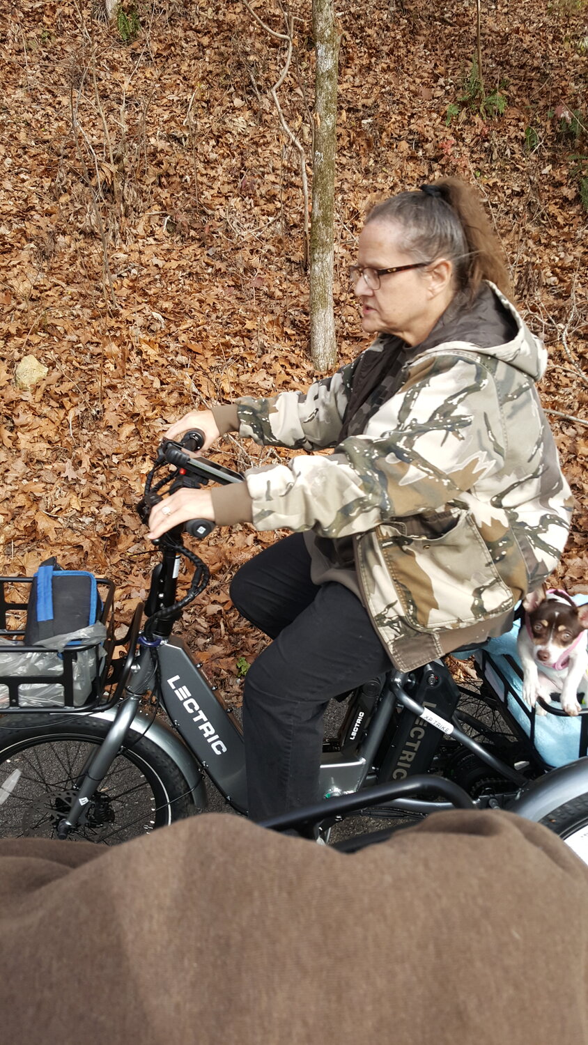

It appears the handle bar is 31.8mm.
Also the handle bar stem is an up/down post somewhat like the seat post. You are unable to change angle. You might get 3 or 4 inches height increase w/o cable extensions with taller handlebars.
I measured 42 inches at the grip. Maybe more available.
It does not seem cramped nor do I feel bent over to ride. I am 5 10 and it is fun to ride. My wife is 5 2 and she is very satisfied. I hope this helps. 20231208_125041.jpg

I'm 5' 9" and it is a little bit small for me. My knees nearly hit the stem when getting off the bike. I can almost put my feet flat on the ground while sitting on the seat, but get ok leg extension.
