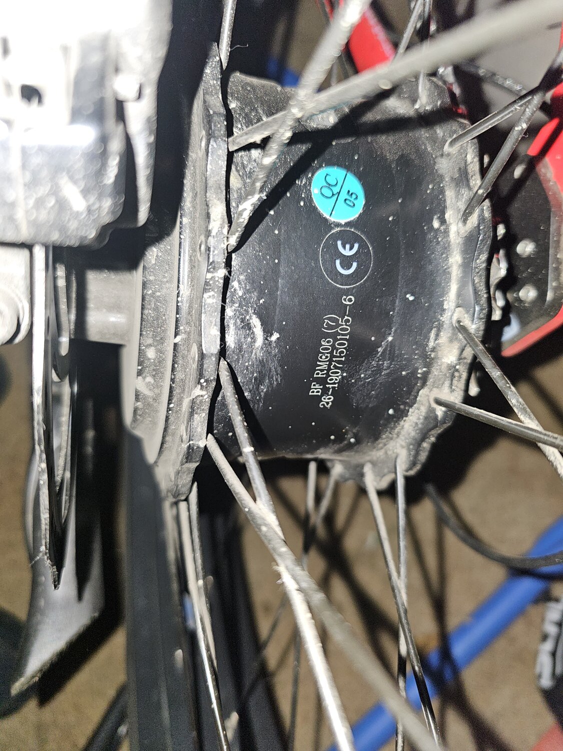

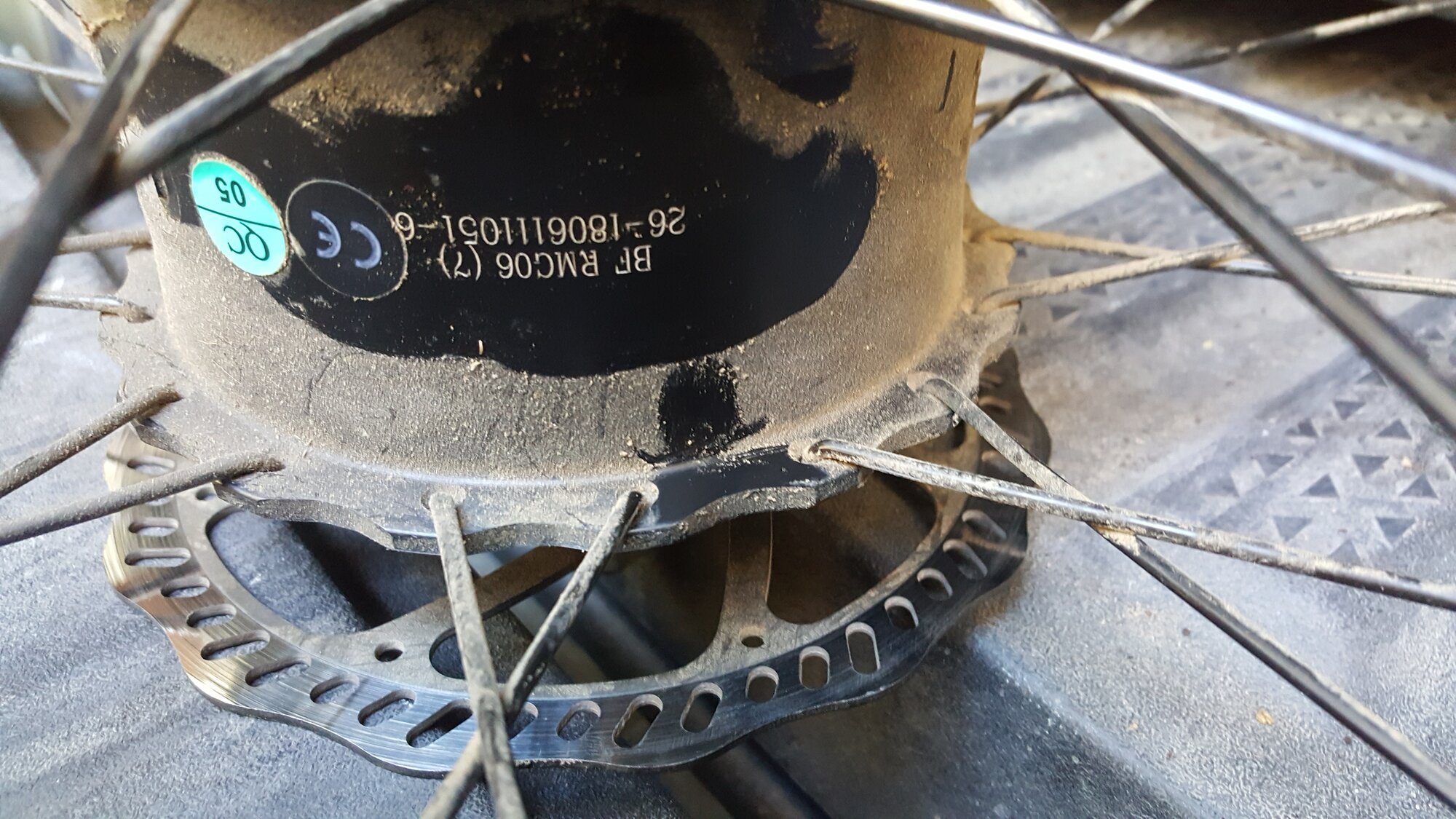

I own the same Yr & Model that I purchased on a Black Friday sale in 2019. My riding Apps show a Tracking total of over 16K miles since I first started tracking mid-Summer in 2020. That said, that IS in fact the letter "G" w/ the center marking worn away, and NOT the letter C. It should read, BF RMG06 (7).
So, when you do an Interweb search w/ the proper Model number, BF RMG06 (7), they can be found at a Number of vendors. I Don't know what the "7", at the end, in brackets means, but I do know who to ask. You Will find vendors for this Motor and you can even find YouTube vids on how to replace the Planetary Gearset. I'd recommend ebikes.ca, aka GRIN Technologies out of British Columbia, Canada. They manufacture the Grin Satiator Charger that Juiced sells as an upgrade Charger for the RCS. I own one and Really like the programable features it offers.
I'm going to attach a photo of my Bafang 750W Motor, hope it goes well. Good Luck !

Yes it is RMG06. I have searched many vendors but it seems there is always an issue with something.
I was hoping to R&R, without new spokes, new wiring, programming, and stuff like that.

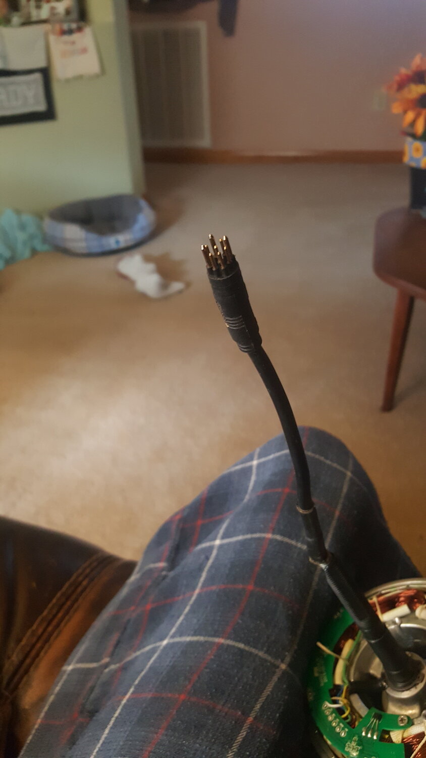

BRB....Here is where I am now...
I 1st swapped stators. The bike ran and after trial and error got it to function properly.
There was a dimensional difference of sorts. It required brake caliper to be spaced inward.
So I decided to lace in new hub.
When I had both stators side by side I noticed the old stator was nearly one inch wider.
All indications are the Juiced motor had a stator larger than 500w with an electrical connection typically reserved for 500w.
All motors with a 750w moniker carried a heavier connection. With no knowledge of controller capability I decided to replace with what would fit up and get the bike working. I may pull my controller and check if an amp rating is evident and see if a 750w motor with harness adaptors is a possibility. But the new motor was less than $200. An economical repair to get the bike rolling again.
