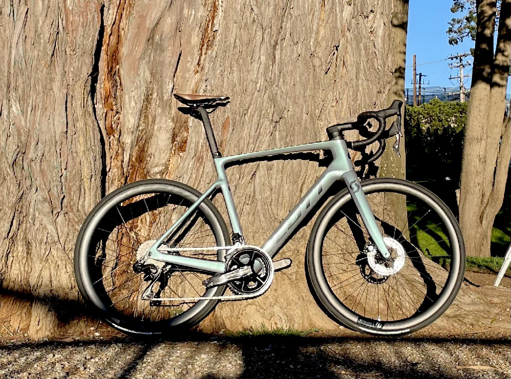

i didn't like the color of the addict that came with the build i wanted, so i got the next tier down and changed out the cockpit, cranks, cassette, and am in the process of changing the saddle and seatpost. here's the bike :

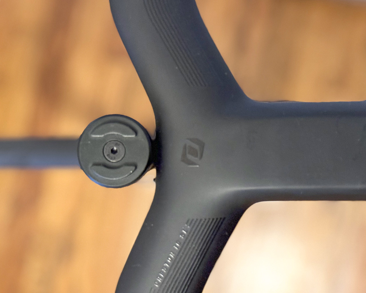

6) the fit and finish of some of the trim bits (like the magnetic headset cover on the one piece carbon cockpit) is maybe not quite as good as specialized.

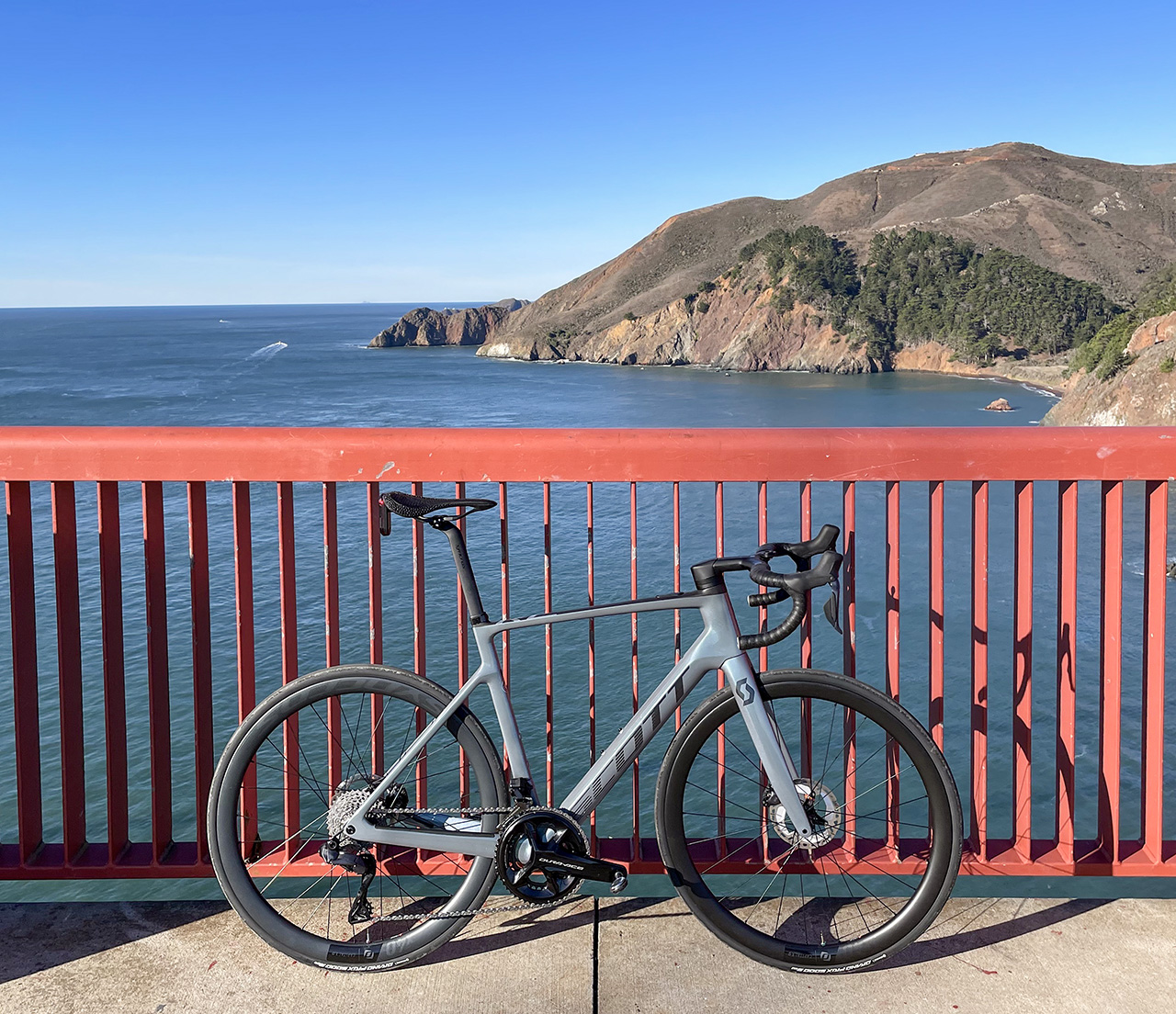

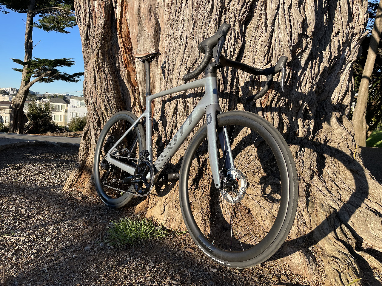

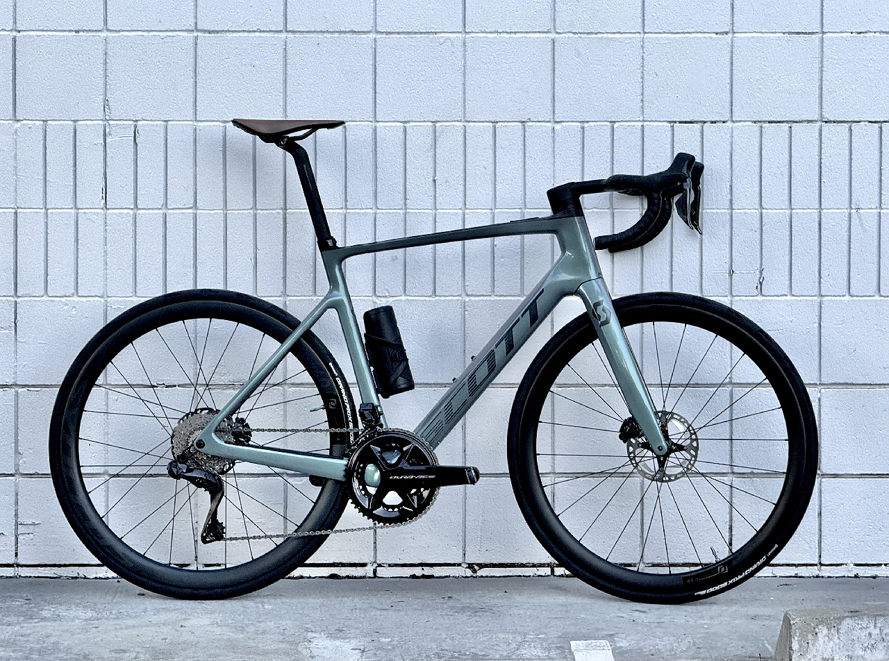

no exposed cables or hoses anywhere :D it's a nice greyish color with some irridescence. i do not like all the scott logos, but it is what it is.

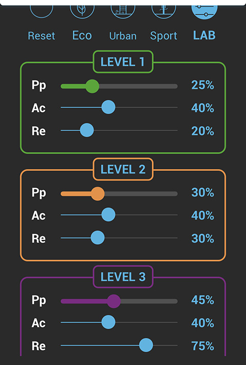

the app settings are a little oddly named -
the first one (power) is the max power and percentage of the 250w. it seems to display 200w at max, so it may be actual power after efficiency losses or i just may not have maxed it out yet.
the second one is acceleration, or how fast it ramps from no power to whatever the max is
the third one is responsiveness, which is actually like specializeds assist ratio or factor, in other words how hard do you have to pedal to generate power.

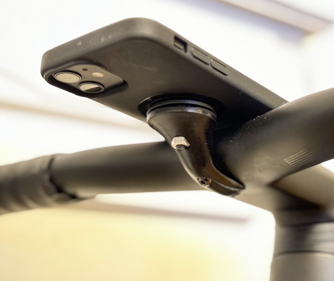

i switched to a new hollow pin waxed chain, adjusted the RD a little bit, made a custom 3d printed mount for my sp-connect phone case, and replaced the ridiculous lever arm through axle ( 😄 ) with a nice robert axle project version.

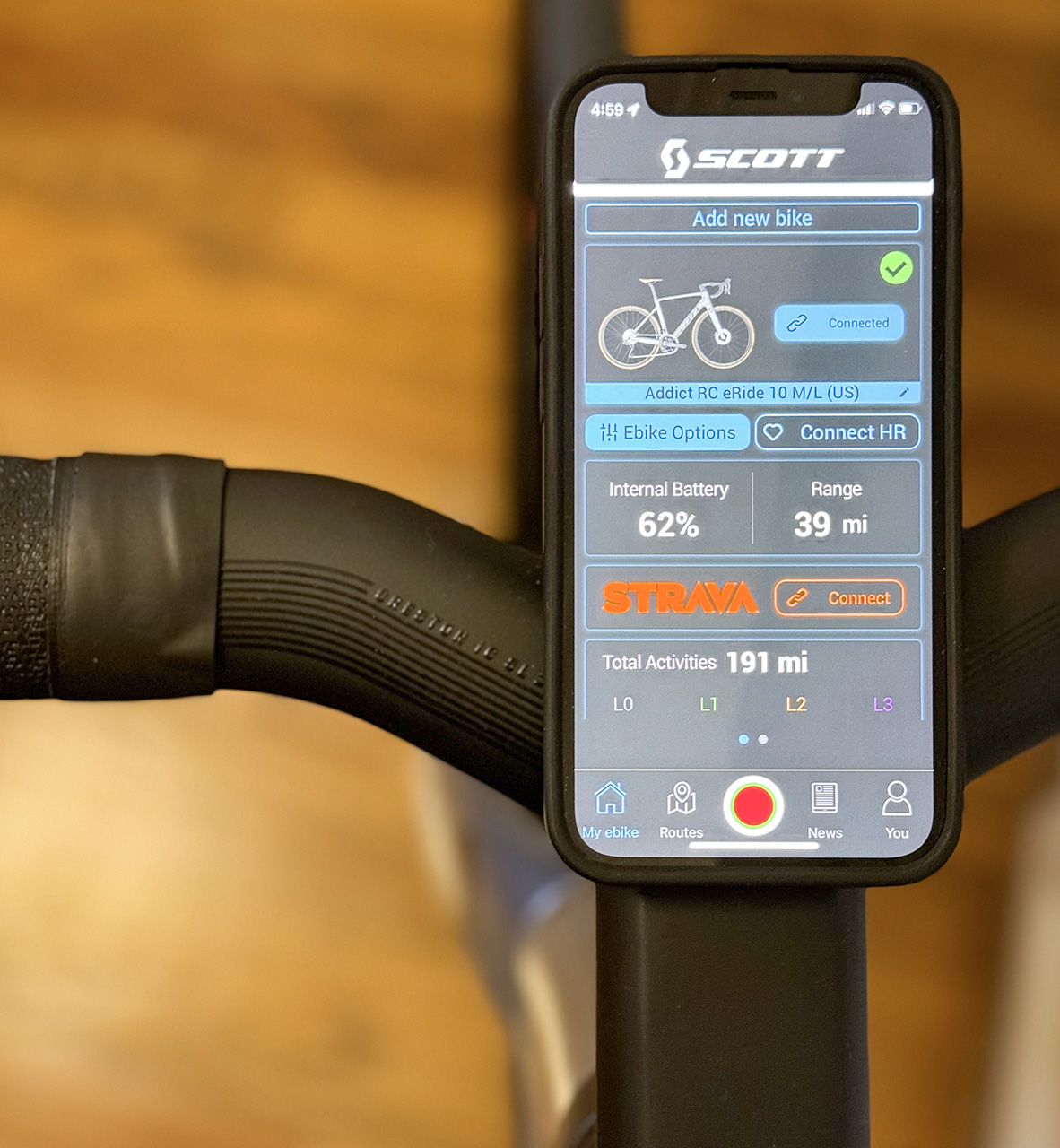

finally, i think i commented that the mahle smartbike app wasn't working with my heart rate strap. it turns out the sensor connects to the BIKE, not the phone, and once you know that (which means you can't connect it to the phone until the bike is on!) it works perfectly. duh. instructions leave much to be desired!
clean!:
i may print another version of this mount that has a goPro mount at the bottom, for a light. the bars make it awkward mount most headlights and i've been using the bike as a commuter too.
despite the ugly UI the app is growing on me.

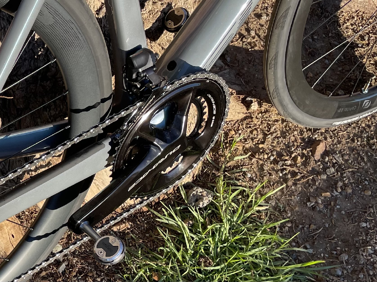

my other road bike has 12 speed dura ace, this one is a mix - dura ace crank and chainrings, dura ace/xtr chain, dura ace cassette, but ultegra calipers, derailleurs, and shifters. i do not see any difference in the shift quality or braking quality, although i will definitely nix the finned pads when they wear out!

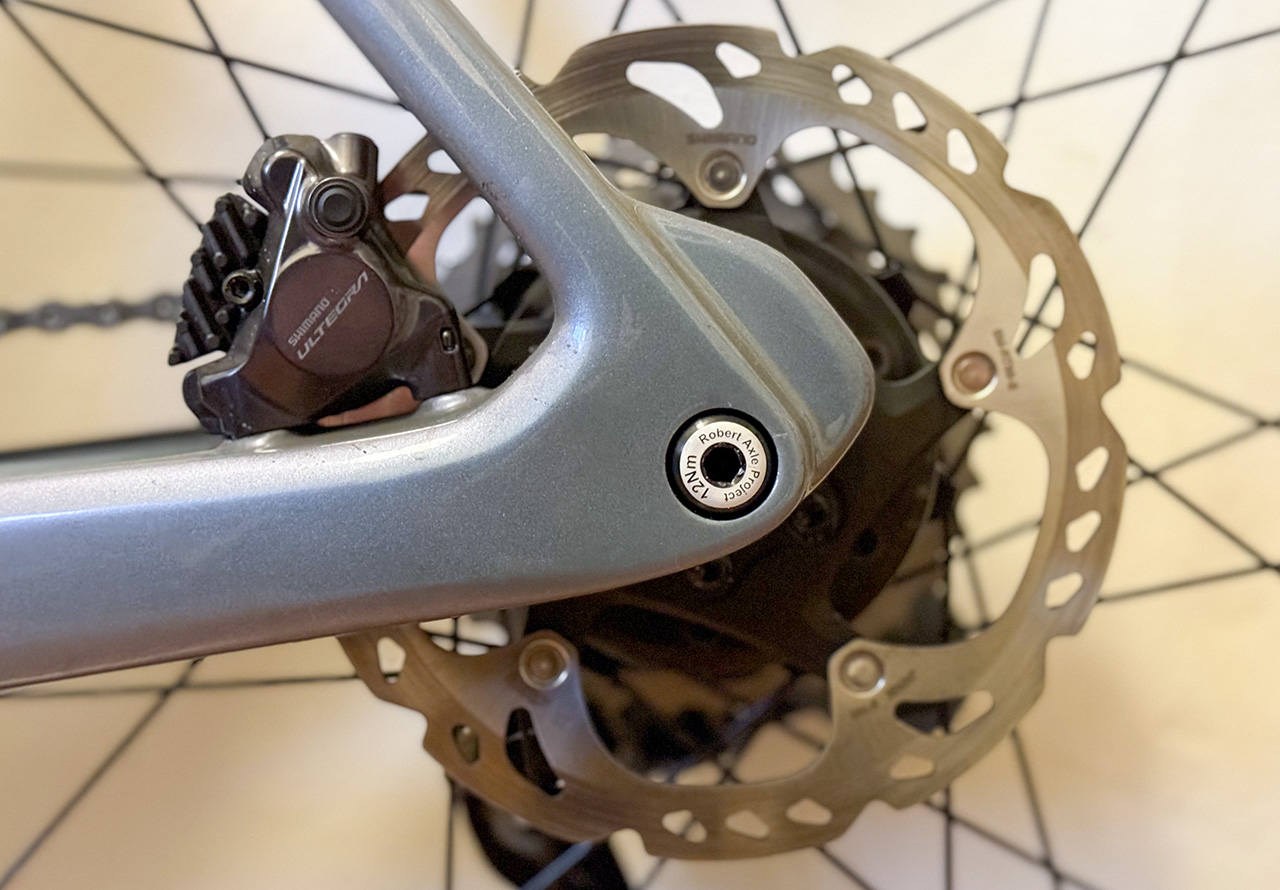

the robert axle replacement through axle fits absolutely perfectly. too bad the graphics are white!

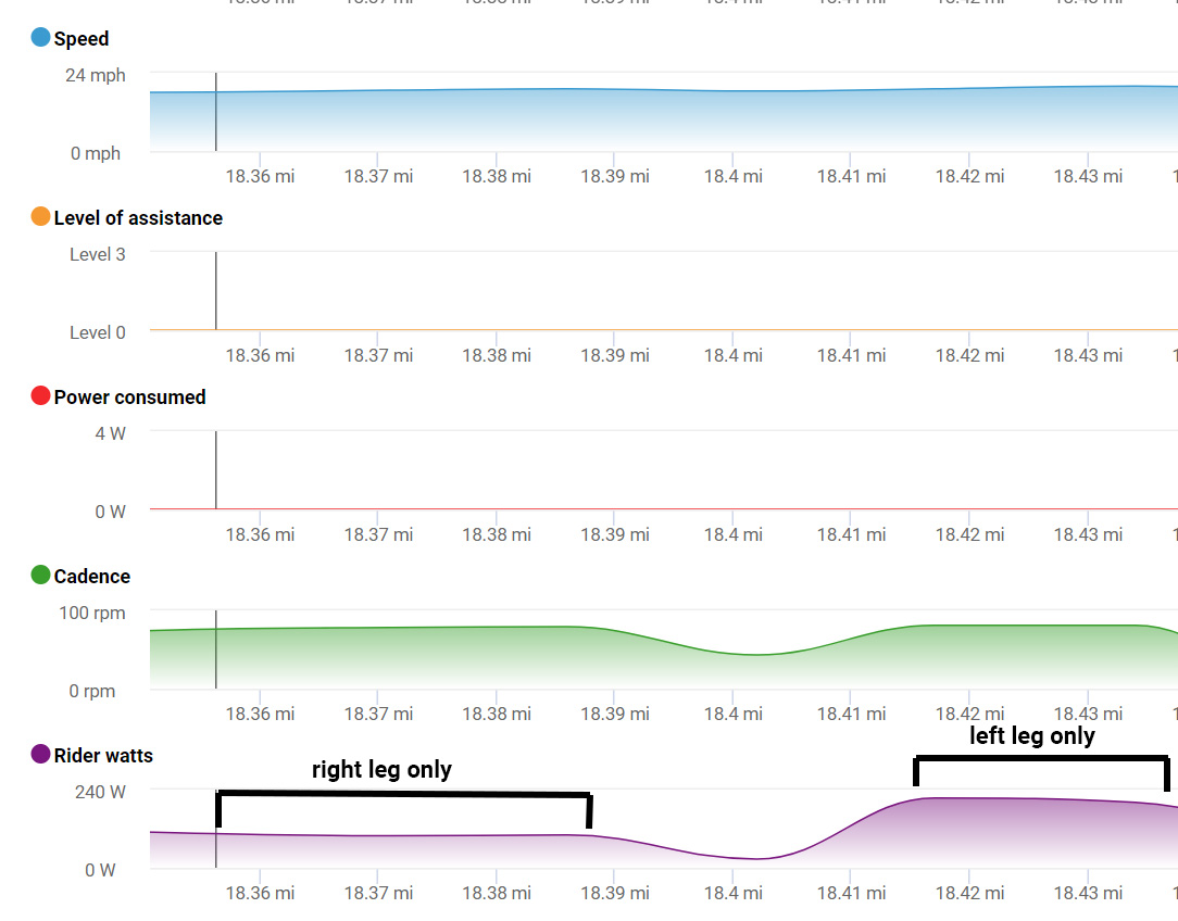

pedaling with the left leg only (clipped in with the right foot completely unclipped - no input at all) gives a very high power reading, and pedaling with the right leg only gives a very low reading
Have you compared to your power pedals (not sure what you use on your Aethos) ? Curious if it is reasonably accurate when pedaling with both sides.
I take this to mean the choice of a lever arm through axle on this particular bike is ridiculous - not the through axle itself?

the power meter on my aethos is in the crank arms, and although it’s literally the exact same crank set and chainrings i haven’t felt too confident taking them both apart. i’m still waiting on the power crank for this bike, 4iiii is super slow!
it is definitely not accurate - one of the places i ride is a local cycle track - dead flat and a perfect oval so what the wind takes away it generally gives back. the long sides are aligned with the prevailing winds, so not much crosswind. this bike and my aethos have very similar geometry and the same tires. i watch my heart rate pretty religiously and for the same HR, the scott is maybe 5 seconds slower around the track, but the power meter shows at least 20% lower than the 4iiii (or specialized SL, for that matter!)

i strongly dislike lever arms on through axles. through axles themselves are great! they should always be torqued to the exact same value with a torque wrench, guaranteeing perfect disc brake alignment. the big lever arm, sometime even without a hex socket, is ugly, not very aero, and imprecise!

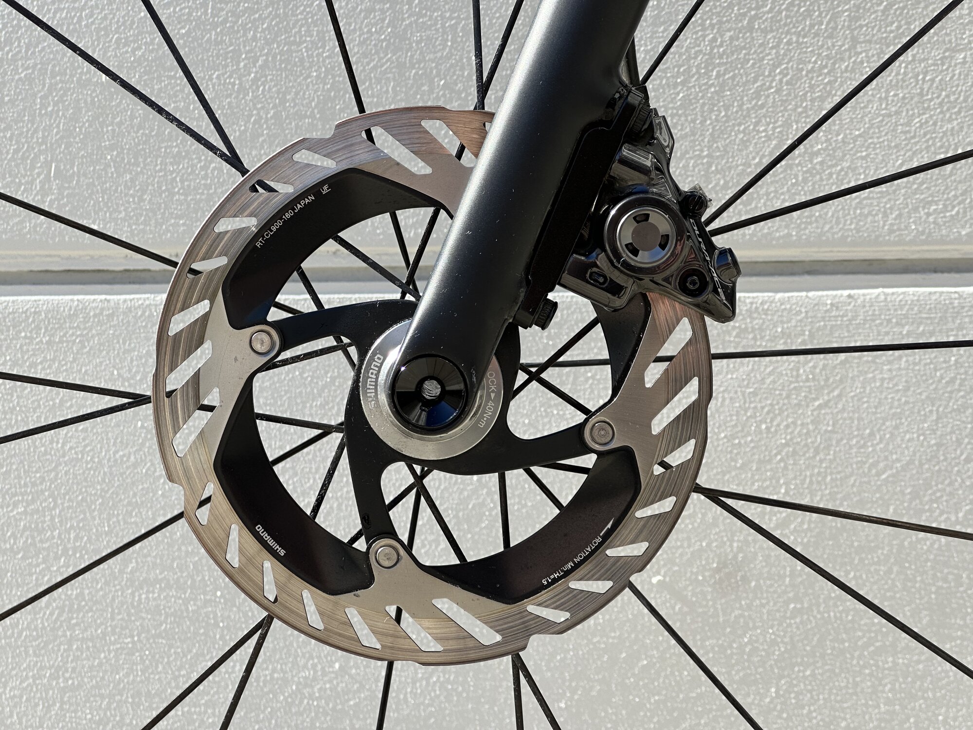

@mschwett yours is the 1st time I ever heard someone wants to rid themselves of the finned brake pads. May I ask why? (Genuine question, I don't understand their positives or negatives on a bike)
unnecessary for a fairly lightweight bike that never sees >20% grades. i’ve done 3,000 foot descents at 25+mph with zero problems on the brakes pictured below. the finned pads are ugly, collect dirt and dust, etc.
this is what road bike brakes should look like :)
Got it - for cooling. And understood on collecting crap, not exactly what a bike needs.

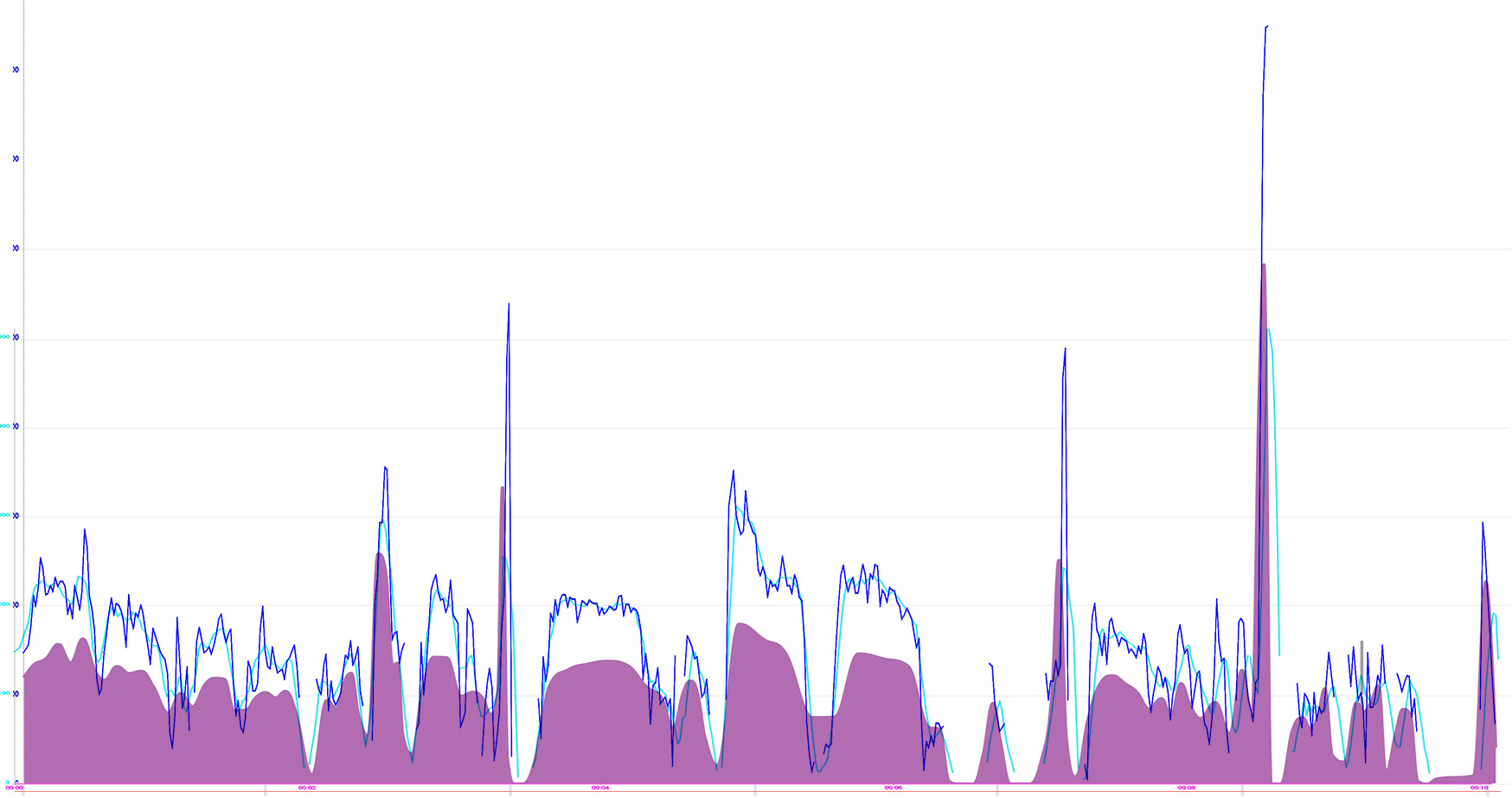

so, just how inaccurate is the mahle x20 bottom bracket power meter? very!
the blue line is the power data from a 10 minute casual test (not riding hard) using a new, factory calibrated and tested 4iiii crank based power meter. for about half the ride the motor is off, and in the remainder i varied it in 2 minute intervals between 35%, 55%, and 100% power settings. the filled purple is the rider power level recorded by the bike. it's clearly way, way low. i see no obvious relationship between the motor settings and the accuracy of the meter, which makes sense since (unlike on the specialized bikes) they're totally separate systems, not even connected mechanically other than by the chain. interestingly the average isn't as far off as individual values appear to be, which may be the result of the much more aggressive smoothing mahle is doing with their data. smoothing the 4iiii data doesn't change much (cyan line) - individual values are still close over 30% low. the average is only 18% low, which makes me wonder if mahle's average is actually a weighted average.
in any case, it doesn't really matter, you can just turn up the "responsiveness" so that the bike's assist is scaled up a little, but the calorie estimates from the mahle app are of course wrong, and the ride data really can't be compared to ride data from any other cycling device. other data - cadence, heart rate, speed, time - match well.

it's kind of irritating how very far off the built in power meter is - about 20% on average and quite a bit more on peaks (maybe it averages more), but it doesn't really matter since the assist ratios can be set high enough to deliver full power with very little rider input. this is definitely not a bike for everyone but for the intended purpose, it's a better fit than just about anything else out there.
