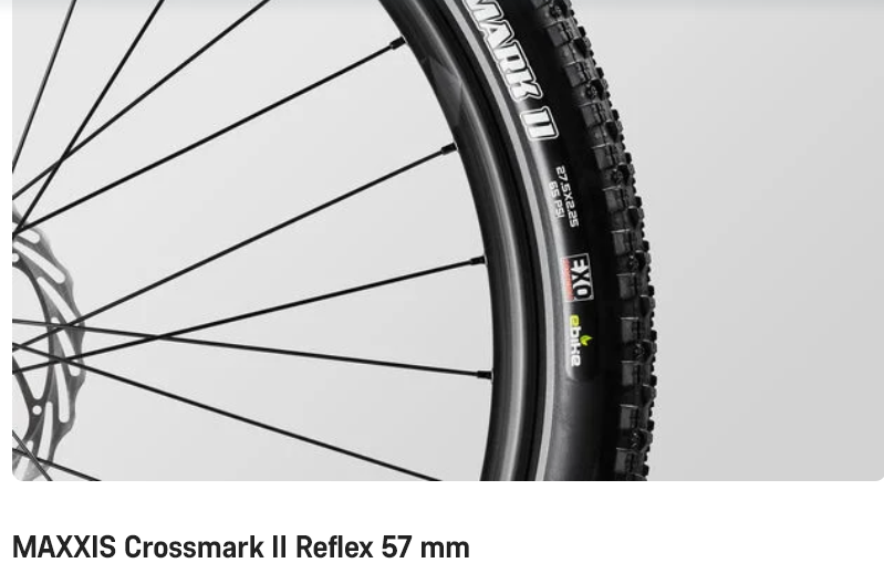

29 or 27.5. Their description page is not clear as to which wheel size is spec’d. Perhaps depends on frame size?
Anyone know? I’ve asked them directly, no reply…
27.5 x 2.25" (57-584)
Besides, a single glance at the e-bike photo tells an experienced eye it is a 27.5" wheel :)
That’s exactly the first thing I did, looked at the label on the tire. But in the specs it mentions 29…
Anyhow, I received a reply from Canyon this afternoon and they state that it is indeed 27.5 and the motor is their Performance Line Speed Motor, and not the CX….
You'd certainly like the assistance up to 28 mph :) The CX is Class 1.
27.5" wheels have become a standard on SUV e-bikes as you can fit a wide comfortable tyre without making the e-bike overly high.
It is not practised to make a line of bikes/e-bikes with different wheel size for different frame size as the wheel size determines the frame construction and geometry. The only exception is the "mullet" setup with differently sized wheels front/rear.
I didn’t want to go 29 as my 2 other mtbs (non e-bikes) are 27.5‘s. Besides, with my height and inseam, I ride a small frame and a 29’er just seems out of proportion…
OK, agreed. Just note the 29'er usually comes with far skinnier tyres. We compared the 29x2" wheel size to 27.5x2.6" one, and both wheels turned out to be almost the same outer diameter... That's why owners of 29'ers often replace the wheels with 27.5" ones but with wider tyres if the frame clearances allow it.

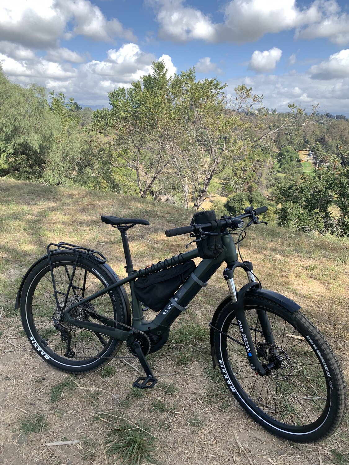

So, I got the bike delivered last week, assembled it, installed my own pedals and an old Brooks saddle, and took it out for a spin a couple times. Never having ridden an e-bike before, I really didn’t know what to expect. But so far, so good, I like it, and the amount of assist I feel just staying in the ECO mode, even on hill climbs.
I did not like the 42t chainring so I immediately ordered and swapped that out for a 34t. I’ll also be swapping out the stock, 170mm cranks for a set of FSA 155’s. I should be getting those in a few days. I’m able to spin more efficiently with shorter cranks with my 29” inseam. I‘ve been running 160mm cranks on my fixed gear for many years now. My mountain bikes are running 170’s and I feel like I’m spinning too big of a circle.
I will be using this bike strictly as a single, overnight, bikepacking rig. I’ve been bikepacking quite regularly these past few months and I decided I needed an electric assist to power up the steep, fire road climbs, carrying 30 lbs of camping gear.
Installed a 34 ring and took it for a spin. Much better, I get better use of the cassette range now. Still waiting on the shorter cranks. I’ll also be installing an Aeroe dry bag cradle over the front fender.
