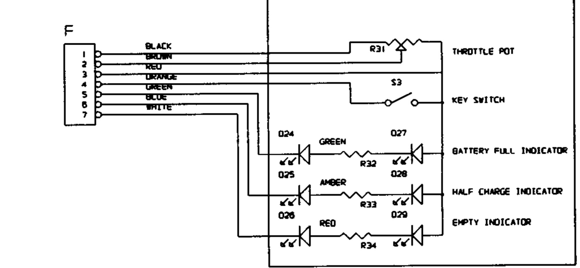

Here is the wiring diagram for the throttle, from the service manual.
