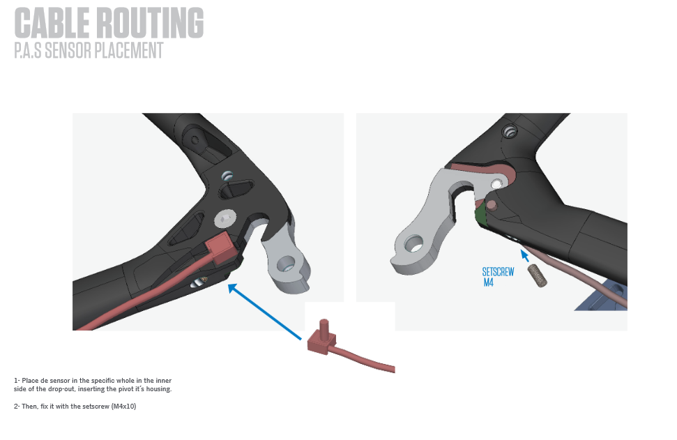

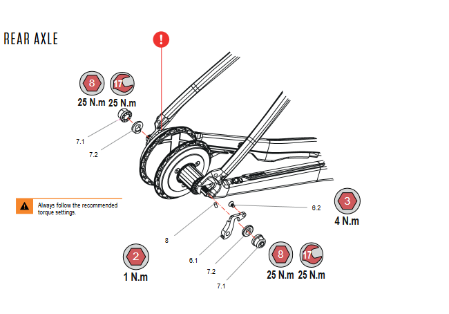

I do not know if the issue is already solved. Here I attach some detail of the assembly of the Pass sensor. Check if the #8 screw is not loose.
