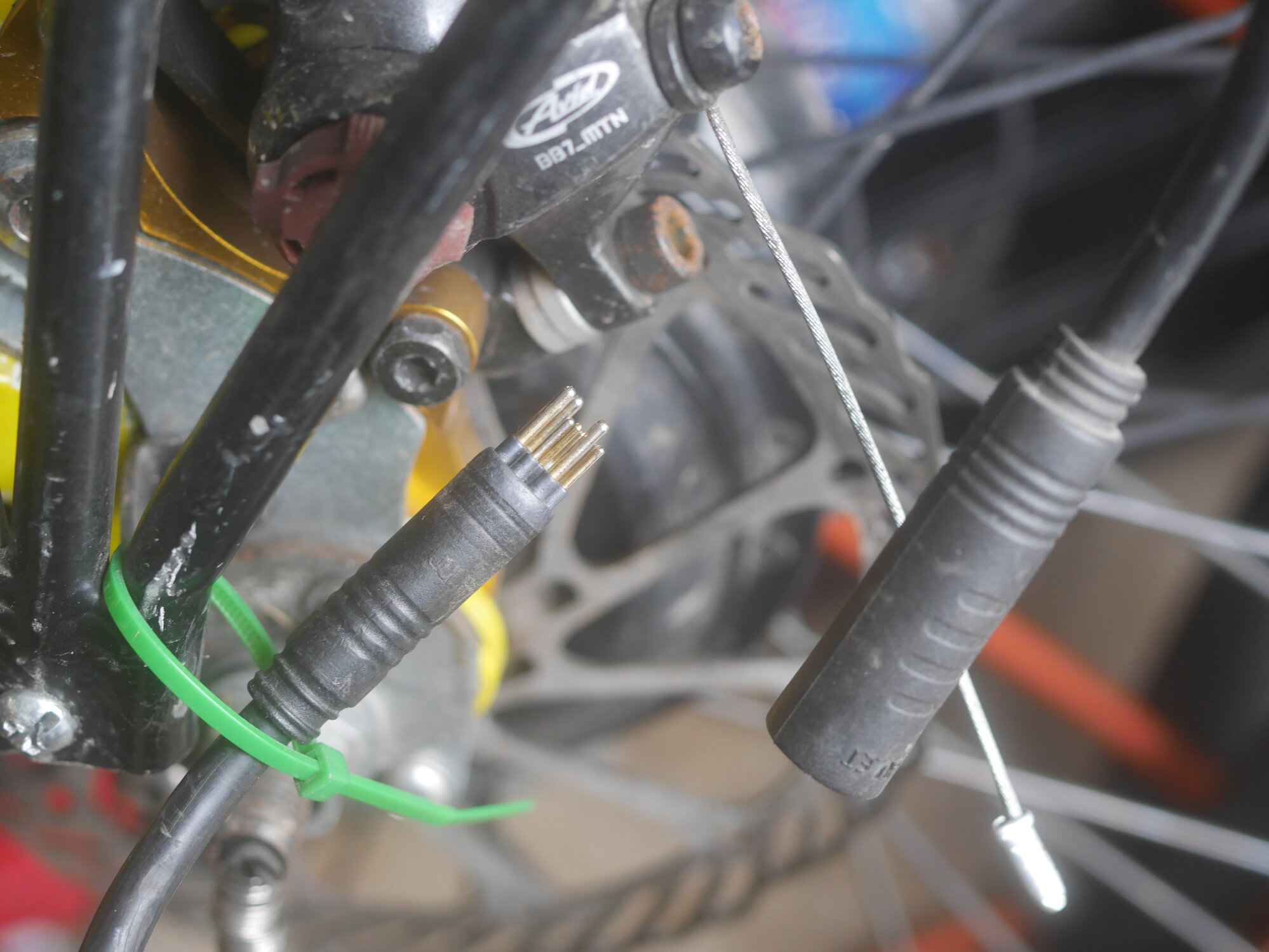

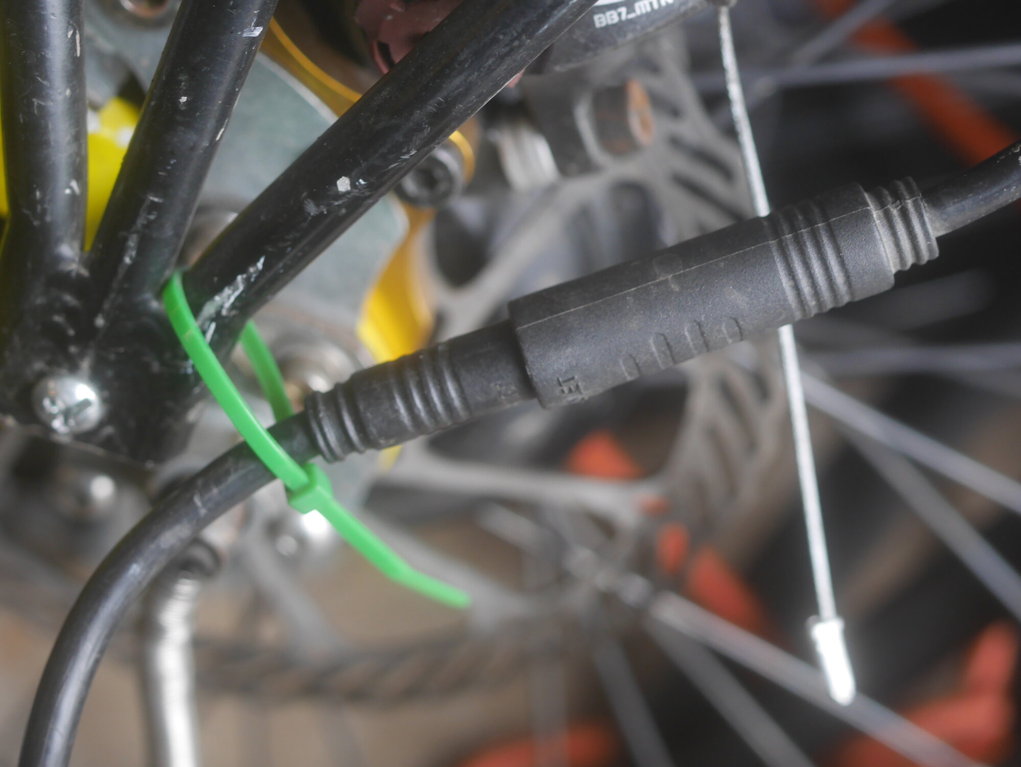

What kind of motor connection is there on the motor? Is it a nine pin like this?

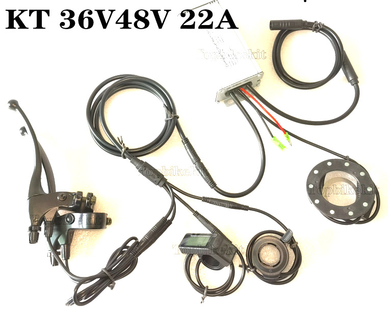

If it uses this cable, topbikekit sells the whole thing for around $140 shipped. I would ask them about an upograde to a color LCD like the LCD7. Pretty much a plug and play swap unless MXUS didn't have a speed sensor, but it should.
Sure, you can buy a less expensive controller and then you will be asking questions on how to wire them up.
