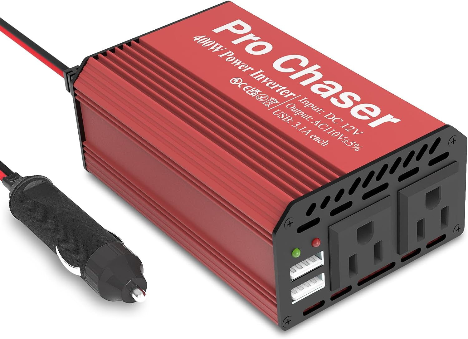

I'm planning my next long van trip, and this time I have an e-bike. I am considering getting one of those "Solar generators" (basically just a big battery with an inverter) to charge the bike battery, and charge/operate a few other devices. Of course the "generators" need to be charged, which would require either finding AC from time to time or actually putting a solar panel on the roof, which is probably what I would do. Has anyone ever used one of these solar generators to charge their ebike?
Why not use an inverter to charge your bike battery while you drive? My truck has a built in 450W inverter that I use with my ebike charger. I usually carry several batteries, and charge them while driving between riding destinations.
Inverters that plug into a cigarette lighter socket, like this one, are considerably cheaper than a solar generator:
If you want to charge while the vehicle is parked, then the solar generator would be an option.
