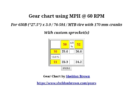

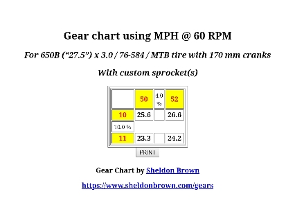

This Gear Calculator is helpful evaluating the impact of any gearing changes on your top speed. Input your tire size and gearing then for 'Gear Units' select 'MPH' at your most comfortable cadence. It will calculate your speed.
In this calc with a 650bx3 tire and a comfortable cadence of 60rpm the 52t ring and 10t cog combo is 3.3 mph faster than the 50t ring and 11t cog combo. YRMV depending on tire size and cadence.
In this calc with a 650bx3 tire and a comfortable cadence of 60rpm the 53t ring and 10t cog combo is 3.3 mph faster than the 50t ring and 11t cog combo. YRMV depending on tire size and cadence.
