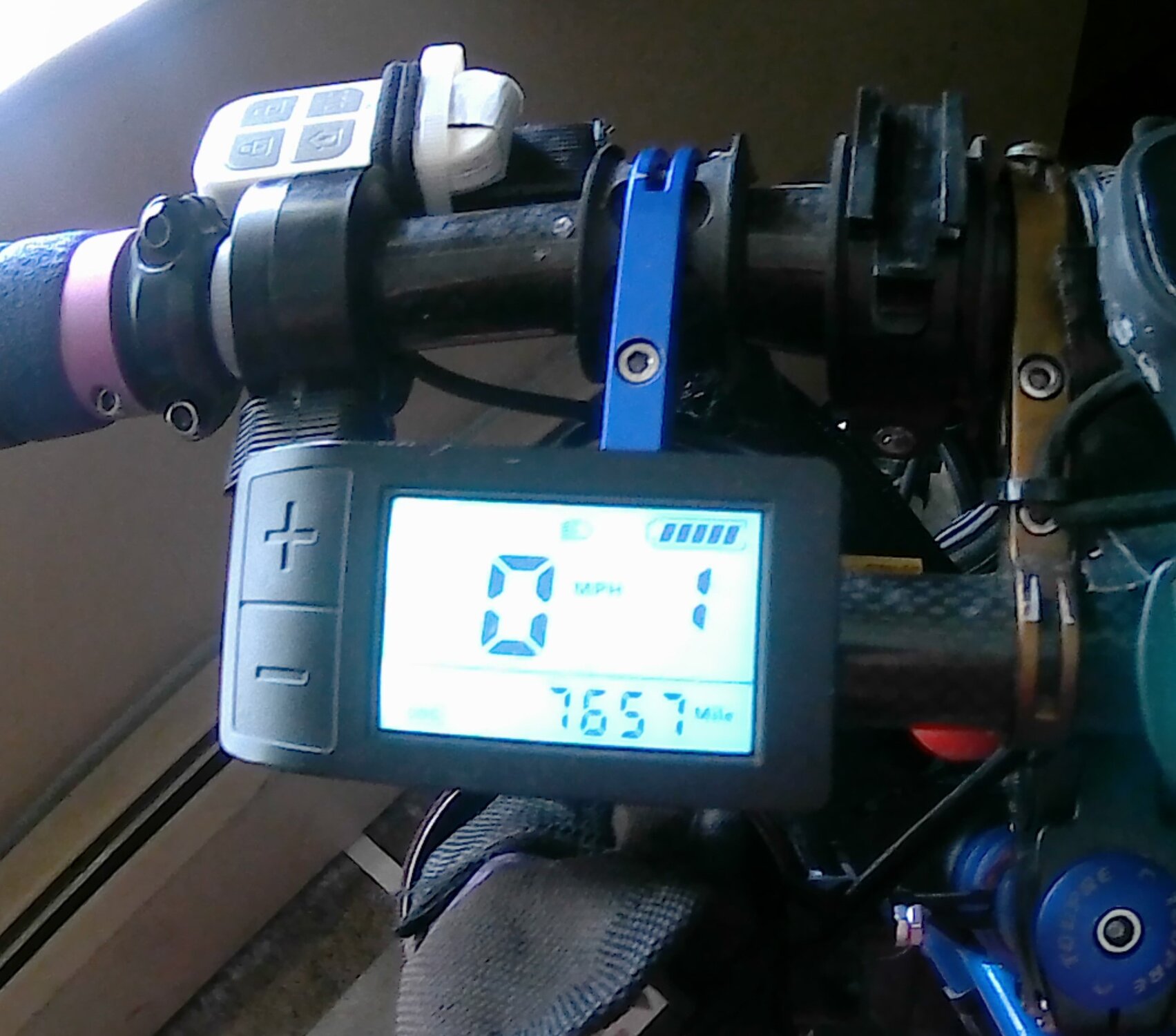

After replacing the 20”x4” bicycle inner tube with another of the exact same size, AND using 26+psi, I continued onward and upward on my daily 50+ mile X52 ebike adventures. Until my 1-year anniversary: Aug 5, 2022.. At mile # 7,657.. Fate was in the air.. I happened upon a minor automobile accident that had just occurred within the prior 10 minutes. I was diligent in maneuvering around/through possible FOD from the crash scene. Or so I thought.
I got about 200 yards past the incident and became aware of the dreaded “riding thru mud” feeling: a flat tire-- on the rear wheel. ShitFire. I had managed to pick up a hitchhiker after all. I grabbed the inner tube valve stem and the rascal just came right off. Severed from the inner tube courtesy of the rim hole. Once again, I was reminded of the awesome torque/power contained in those rear hub motors. By the time you realize that “something is up”, you have also pushed the throttle to compensate. That is when the decapitation of the valve stem enters the picture.

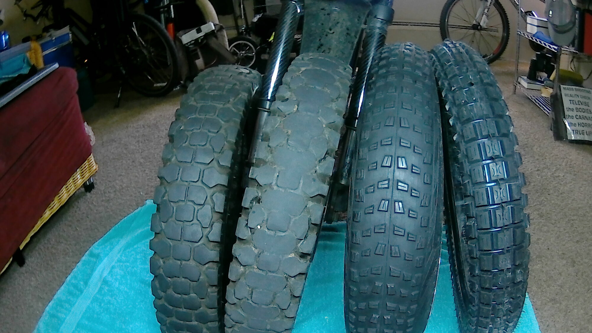

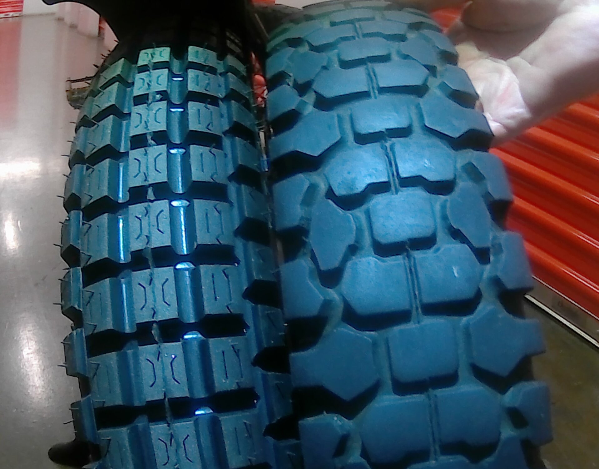

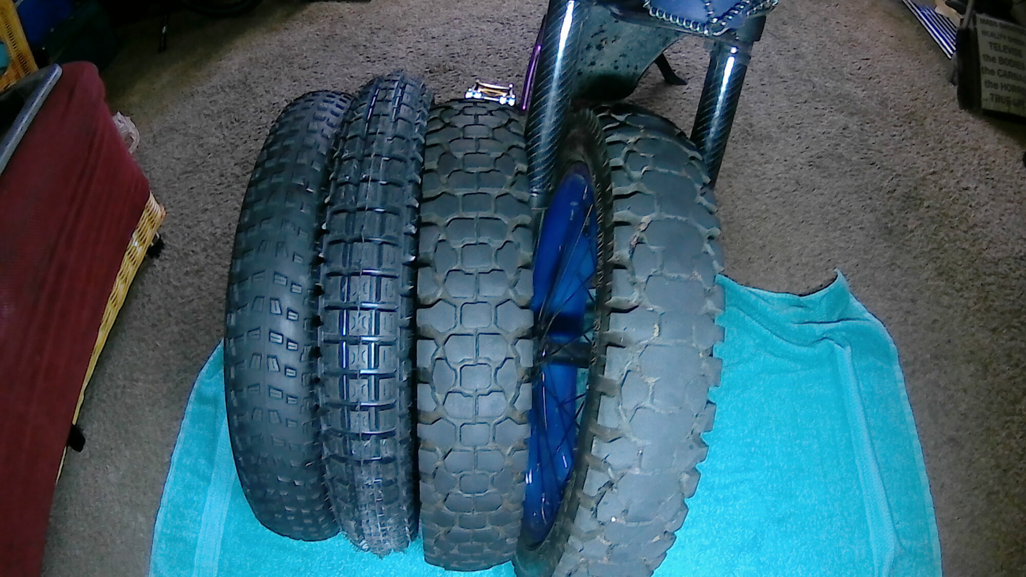

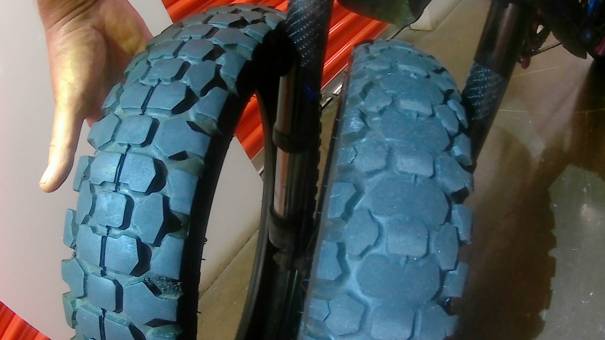

So, how do I like/compare/feel about the Shinko 241's in comparison to the Shinko 244's?? As I mentioned earlier about the 244's: they generate a respectable volume of road noise. You will never be able to sneak up on someone, fer sure.
I have now put 200 miles on the 241's and my verdict is that the 241's absolutely RULE!! These damn tire are dead-on quiet-- as quiet as a slick tread tire. I was amazed. Remember that I had the 244's installed on the X52 ever since mile 0(zero) back on Aug 5, 2021. Now, with the 241's, I was hearing all kinds of new and different and wonderful sounds. My mighty X52 beast was a vicious, yet purring, amigo. I will never tell anyone to not buy/install the bad azz looking 244's (because they definitely are that), but, for me, it will be 241's from here on out. I'm totally smitten, and I ain't shittin'.. I know that I could have gotten to mile #10,000 with that 244 rear tire. Now I'm interested to see how 241 compares. I can't wait to see how they perform in snow.
By the way, for some reason, the front tire wears out much faster than the rear tire (see photo's below)- despite the rear wheels overwhelming weight factor disadvantage. And that is not necessarily a bad thing. Why? Well, because the front wheel/tire removal/swap/installation is a heck of a lot easier to deal with than the 25+ pound rear hub motor setup for the rear tire/wheel.

Finally, the photo's (below) show the OEM, 244, and 241 tires mentioned in this thread posting.
