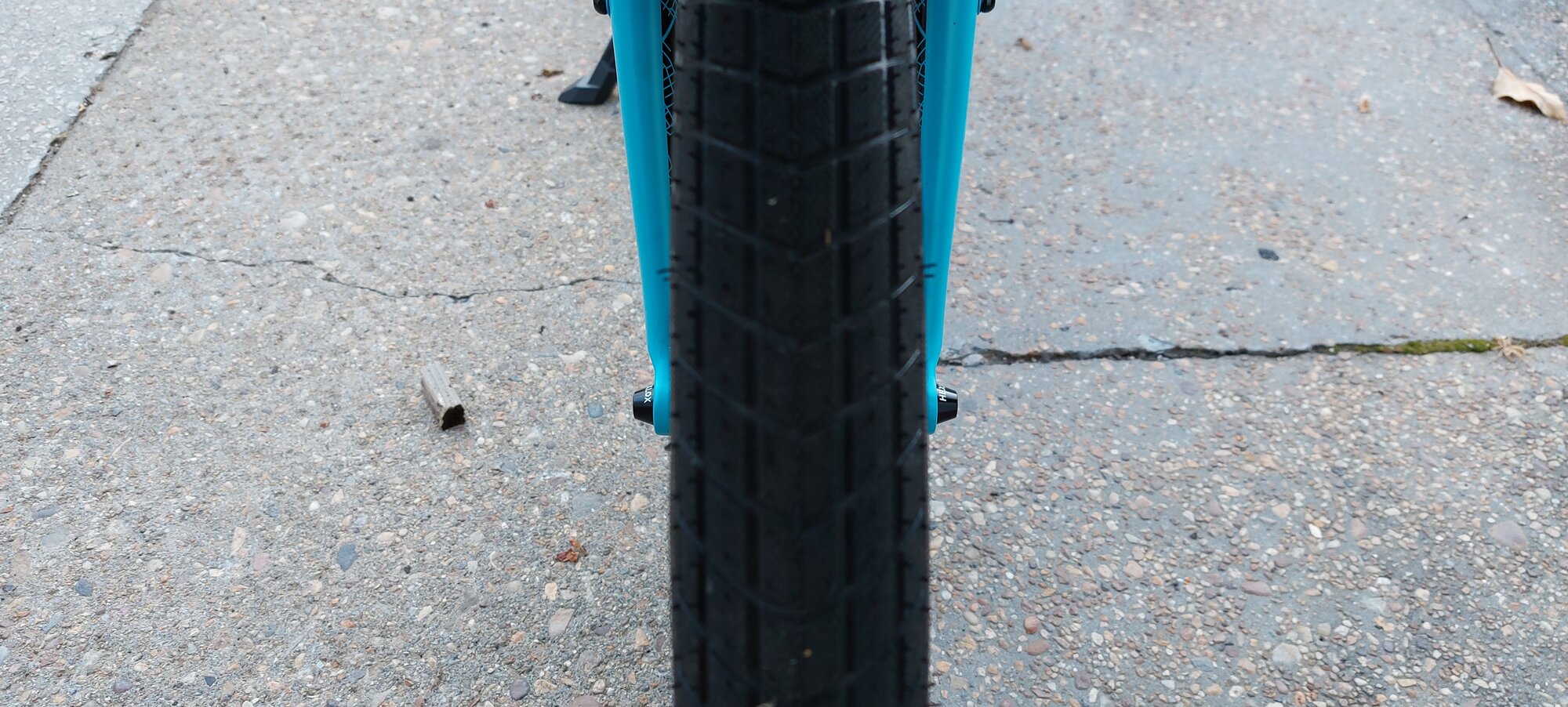

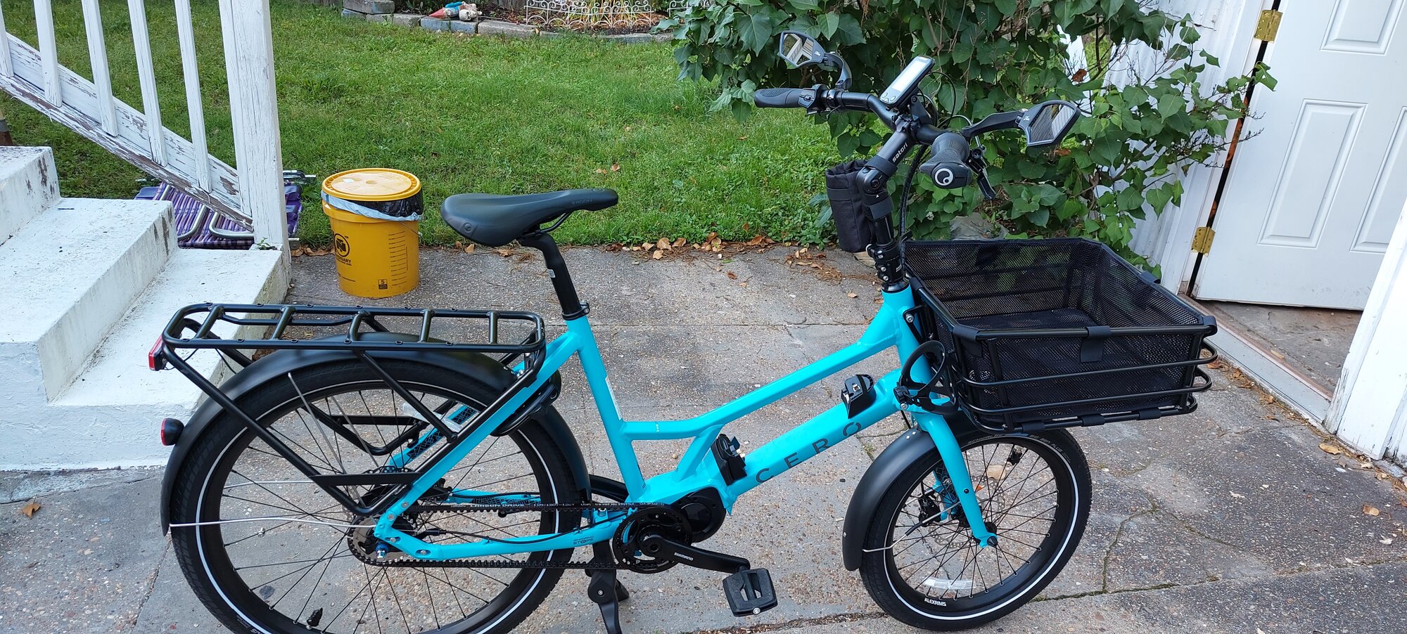

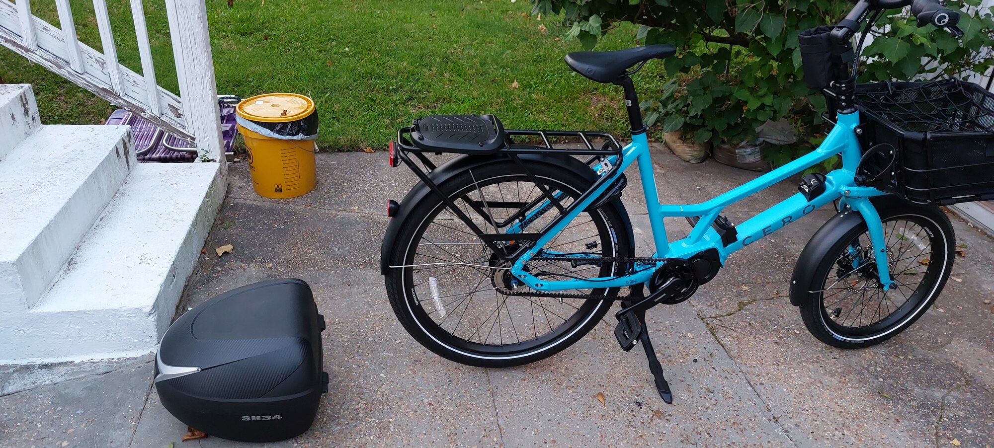

I'm 5'10", 32 inch inseam and weigh 225 pounds. Set-up.

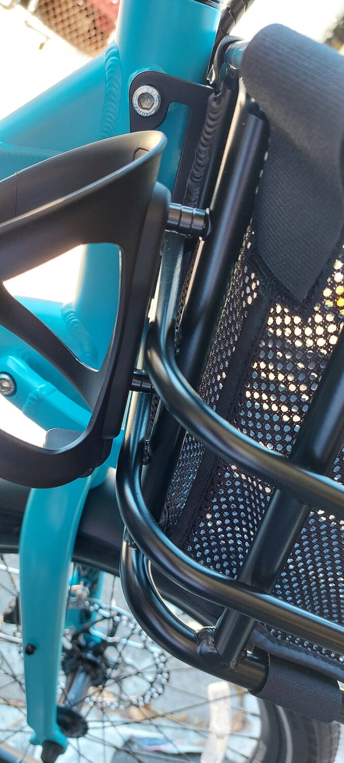

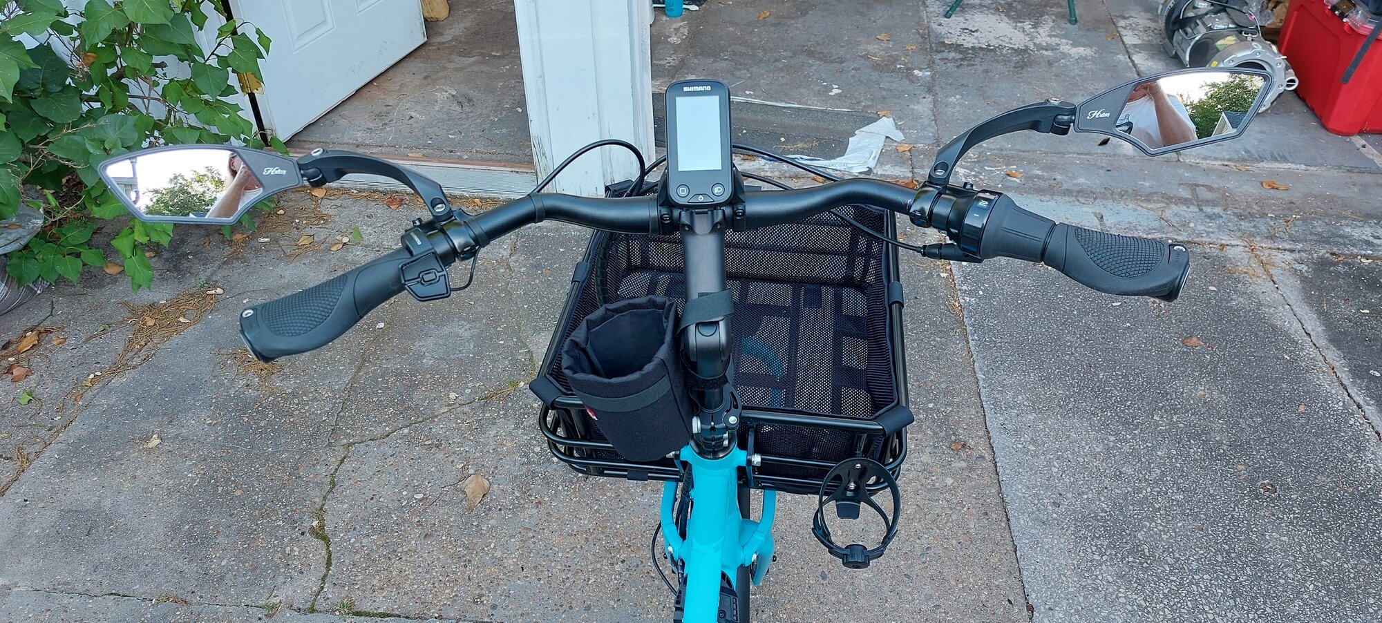

Note the front rack only has one bottle mount boss, and to use it the hardware bag comes with little spacers.
I still might install my SHAD trunk on the rear rack, but the bike looks so clean without it. And I need to find a net to go over the top of the front basket. I only have 10 miles on it as of today, 5/29/2022. Super smooth, dead quiet and powerful enough for my needs. I live in a No Hills zone. Still getting used to the Abus Cafe lock and the extender chain. I was going to install a Foldy Lock for added security but I'm trying to find a clean spot on the bike. Behind the seat tube/in front of the the rear fender almost works but the Foldy lock release is a tad to tall. I found another spot but it will require some creative engineering to make it work, and its been to hot and buggy to fiddle with it. Waiting on my HexLox for my front skewer and seat clamp as well. As an added bonus I got terrorized by a group of bag pipe players today! The strange things you see when on a bicycle!

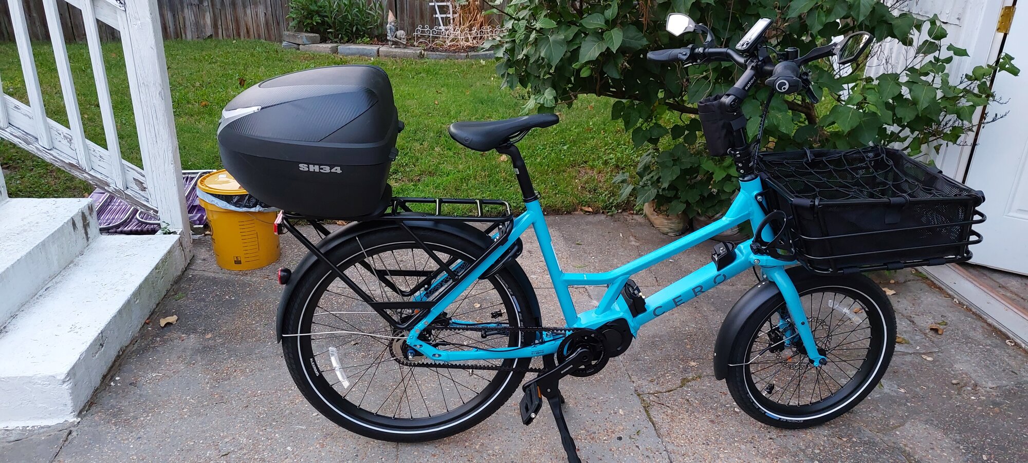

Put my SHAD trunk on. Gave a friend the Banjo Brothers grocery pannier.

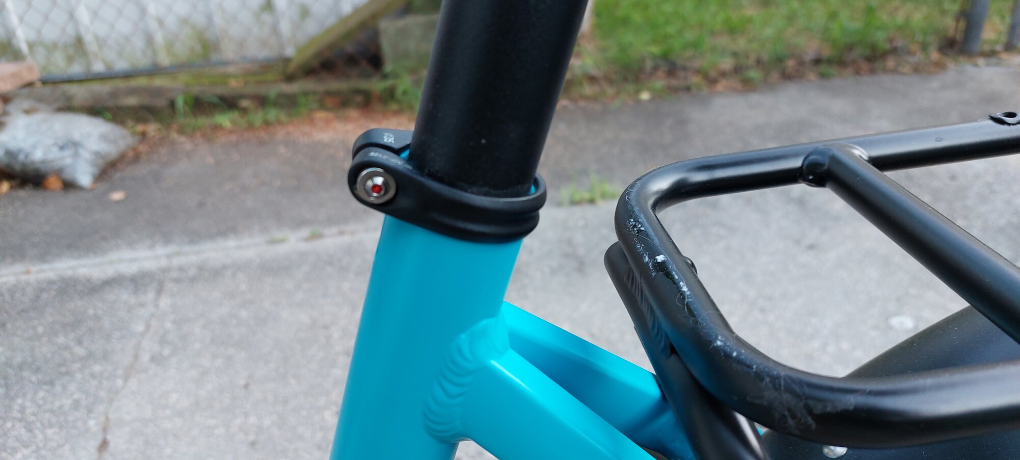

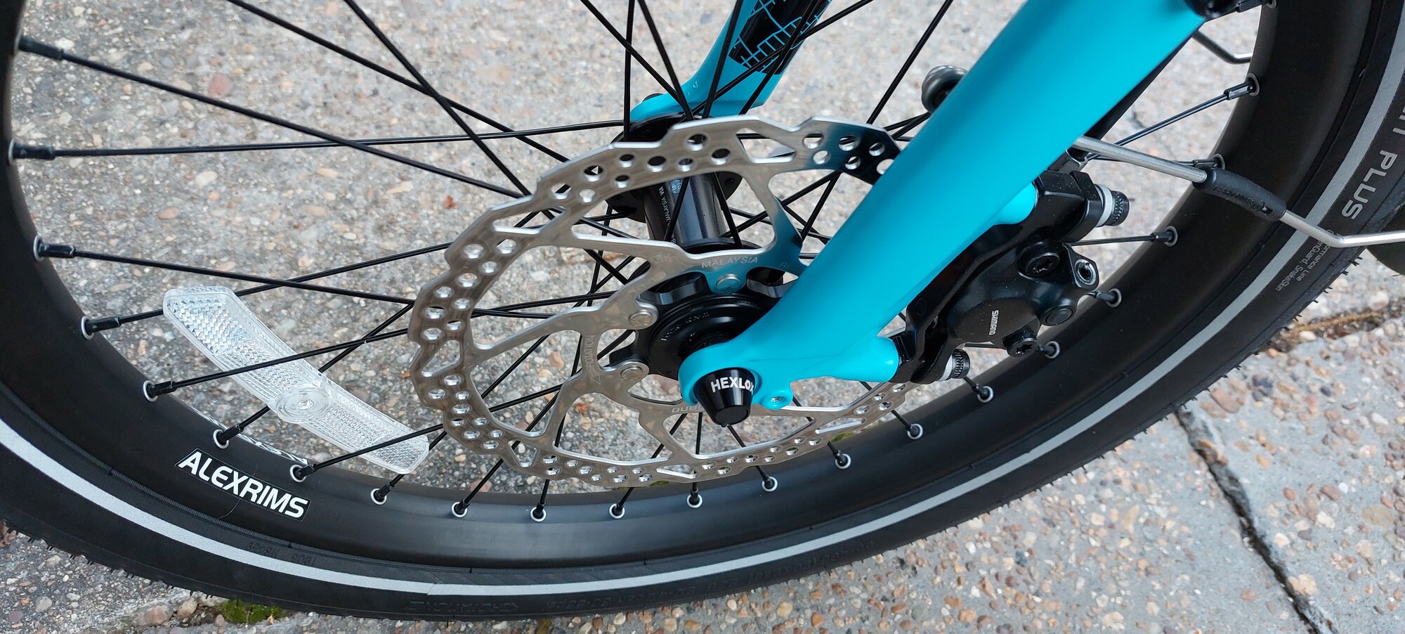

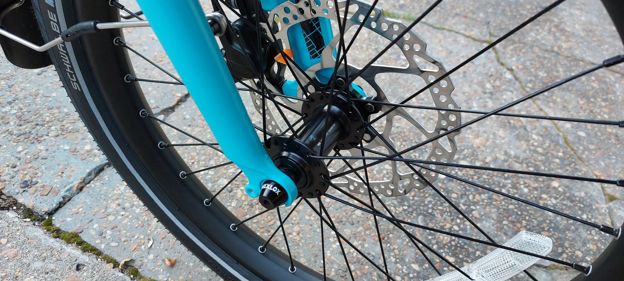

HEXLOX secured. For the OEM seat clamp you need the HEXLOX with the magnetic insert, as the clamp bolt is non-magnetic.
Front skewer kit comes supplied with 2 different axel widths. Each end has locking tabs that go into the drop outs. Pic shown has the end cover installed.
