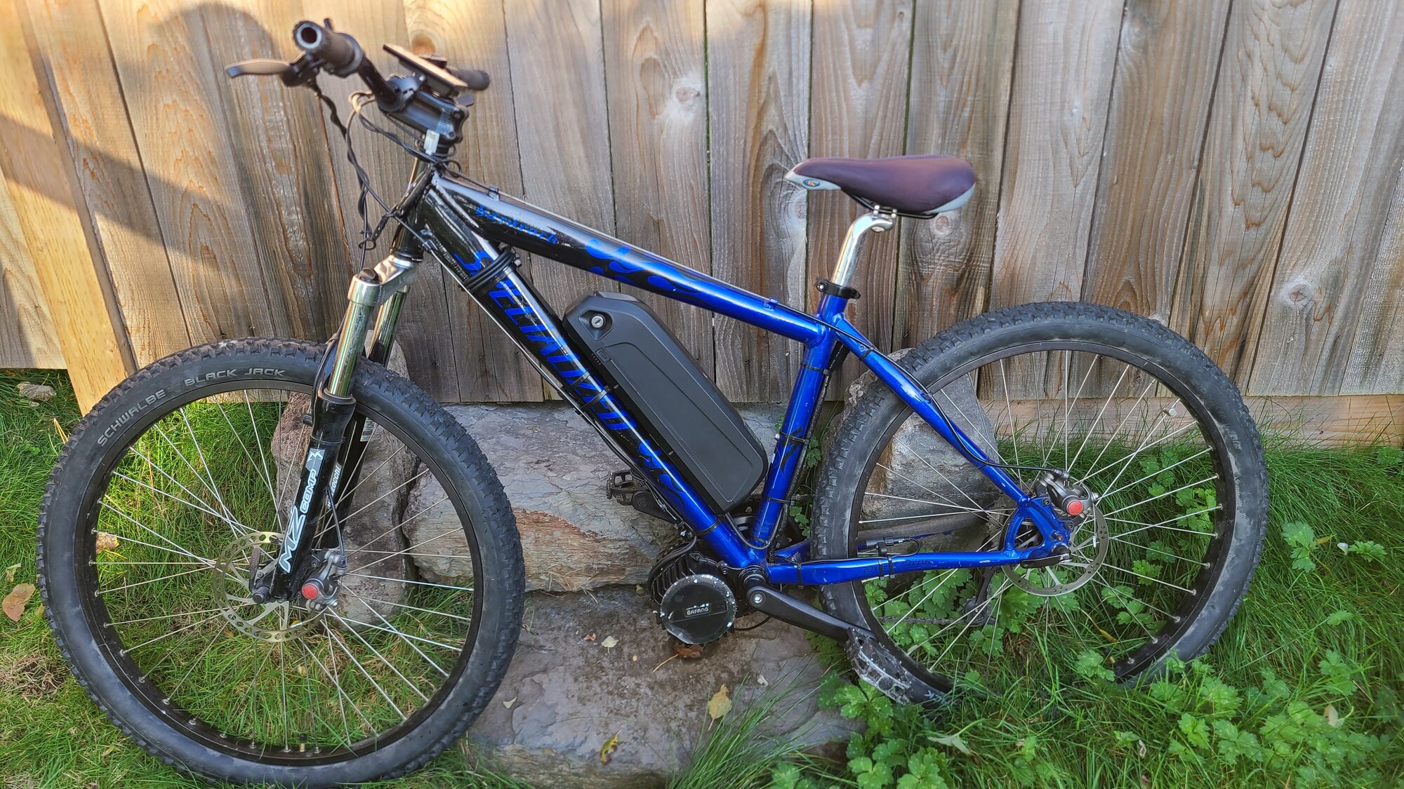

I live in Vancouver and attached a BBSHD onto an older MTB. This thing flies across the Iron Workers Bridge, and turns hills into flat surfaces.
Bafang Mid Drive Motor
BBSHD
On a 2007 Specialized Hardrock
Aww I did some pricing a few days ago on conversion and it’s expensive etc and might as well buy a new bike with motor.
Fair enough, but this motor is awesome. I can go anywhere, in any conditions. Was great in snow too. If you wanna look or try it, PM me.
I am curious. How much was it total to convert? And how much extra weight on the bike? And the kicker for me is I could never put it together and would cost money on top of everything else.
I purchased a better chainring and a couple of spacers for about $50. Installed it myself.

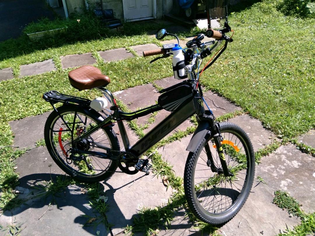

OK - with all that said - Now I know my bike is not what I should have purchased BUT... I too live in an area of Mountains. (Pocono Mountains of PA) and I have had my cheap 250W bike for almost a year with 300 miles on it. Great for bike/walking trails but difficult for me to climb hills when ridding about the neighborhood. I want to change the 14-28T rear 6sp cassettes to a 14-32T and keeping my 42T original equipment Chainring. What say you - will it help this old guy to get up those hills or should I really change to a 14-34T 6spd cassettes for maximum benefit. I have no idea if it will be worth the time and effort. I only face hills every now and then and sometimes I have decided to change my route.
Every tooth helps! If you have an option for the 34, I’d do that. You guys do have some pretty good grades down there!
Thanks, I will replace my 14-28T with the 14-34T rear gears. I am very grateful for your insight. And now I am confident that my feeling were correct. My HOT ROD custom bike is on it's way - thank you again!

Dave - I changed my rear cassette from the stock 14-28T Falcon to a 14-34T Shimano with a long cage Shimano Derailleur and a new longer chain... But I just did a test ride and BIG BIG PROBLEMS... I must have done something REALLY WRONG!! ! The darn bike really runs great - HOWEVER - no coast or back pedal ! ! ON the bike rack it shifted just fine and everything seemed to work properly. The motor worked as it should have but I never tried to back pedal when the bike was on the stand. I took it out the driveway and the chain jumped off the chainring. After I put it back on - the darn thing just started pedaling without allowing me to NOT PEDAL.. I have not started to tear it apart yet (Having a few BEERS NOW!) but what are your thought pursuant the lack of freewheeling?? Perhaps I tighten the cassette too much or the axel nut on the shaft before the frame and end nut. I will pull it apart tomorrow - but before that any and all ideas you might have would be extremely helpful. Thanks
