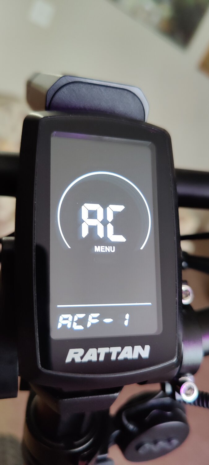

I actually held the "+" and the "light" buttons at the same time and a setting that looks like "AC" comes up. It has a setting of either 0 or 1 for the ACf parameter. Does anybody know what this is for?

This was not in the instructions that I have for the display.

Can you take a photo about that setting interface? I don't think they have a "ACf" parameter options.
I can when I get back home. I checked the photos on my phone but out of all the ones I took, I did not take a photo of that screen.
I'll post it later this evening. I am to understand it is a YL80C display interface.
