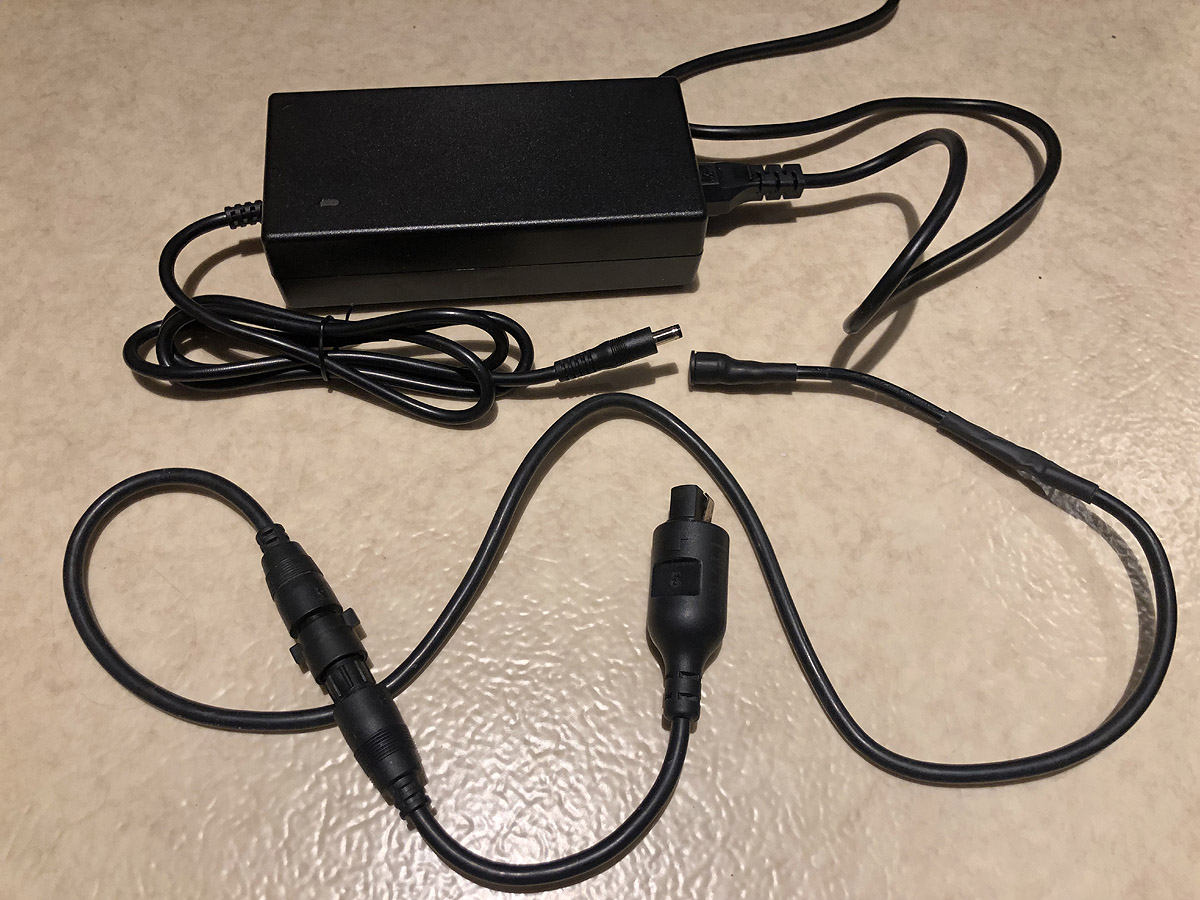

My original BH 36V charger just recently died when it started clicking on/off at random, and I had to buy an official 160eur (with shipping) BH replacement, but I cut off the Singatron 3-pin plug from the dead charger and soldered it onto a generic 50eur 36V e-bike charger and it works great as a second charger. Now that I know the plug, I might just order one and make a third charger from a second cheap charger and never have to carry a charger again.
I don't appreciate companies trying to hide their suppliers to make you pay premium on something they get dirt cheap. The official replacement charger did come with the direct-to-battery pigtail though.
Generic 50eur charger with male barrel connector, and BH Singatron 3-pin connector after that (plus direct-to-battery pigtail):

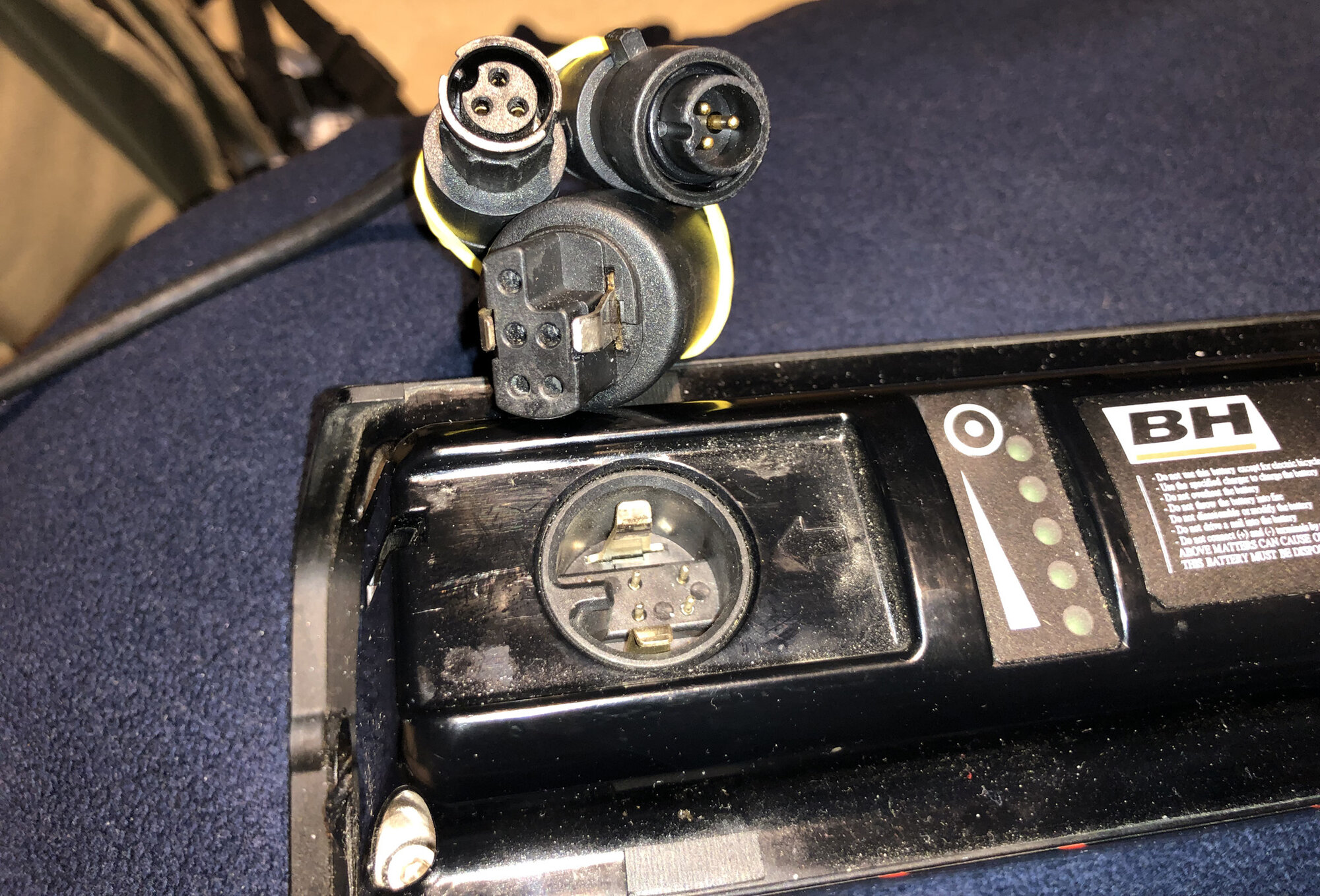

All BH Evo 2015 36V Singatron connectors:

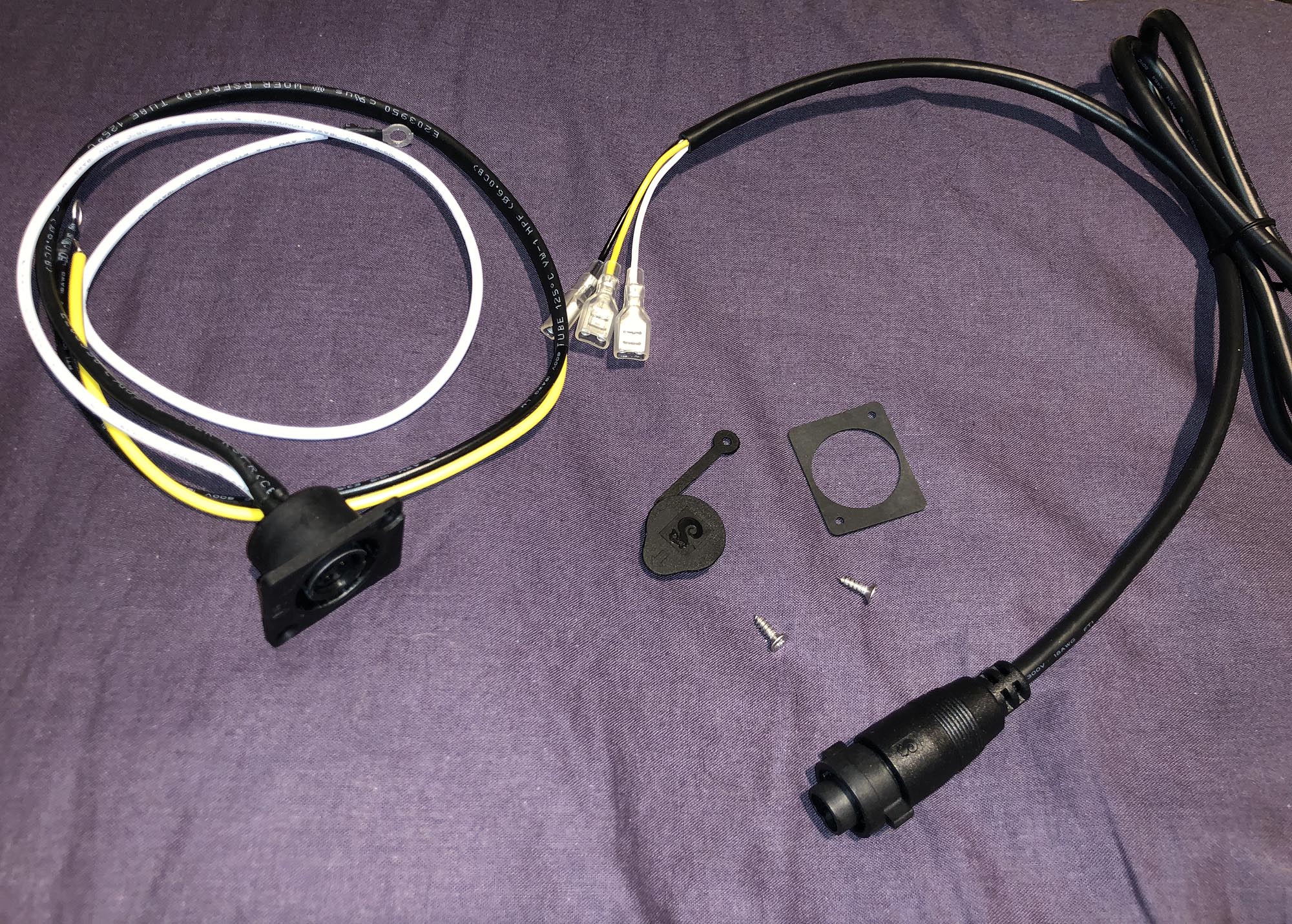

I got the above parts from Farnell, and I can confirm that the connectors are the same as on my ~2015 BH EV765 bike. They're even made by Singatron just like the originals even though the Farnell site says Multicomp-PRO. Total cost with shipping was around 30 eur.
