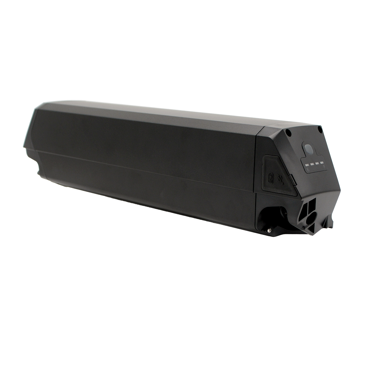

While discussing my battery problems with my 2015 epic SE, a friend of mine mentioned that there was a way to use the old battery as a power supply for less demanding applications. while the battery may no longer have enough power to run the bike it can certainly charge phones and tablets perform and other less demanding applications. Anyone heard of anything like this? I was told there is a way of connecting a USB charging port like they have on the 2016 and newer EJoe models. would love to hear comments on this from the forum. Thanks.

There's no technological reason this couldn't be done with ebike batteries as well. For now it will be volume limited, probably not enough ebike batteries to bother with. On a personal level I can see keeping an older ebike battery around as a range extender or as a power source for charging any number of devices much like Power Banks are used today. A voltage converter would be needed to get the desired output voltage. This $12 solid state converter will provide 5VDC @ 3A (think USB charger ports) from an input voltage ranging from 8-58VDC (12, 24, and 48 volt ebike batteries would work). This could be handy during power outages, some camping and boating setups, etc.
