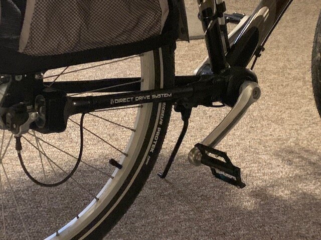

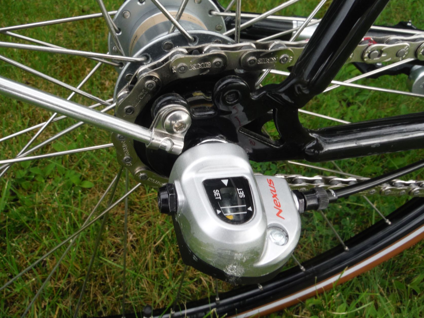

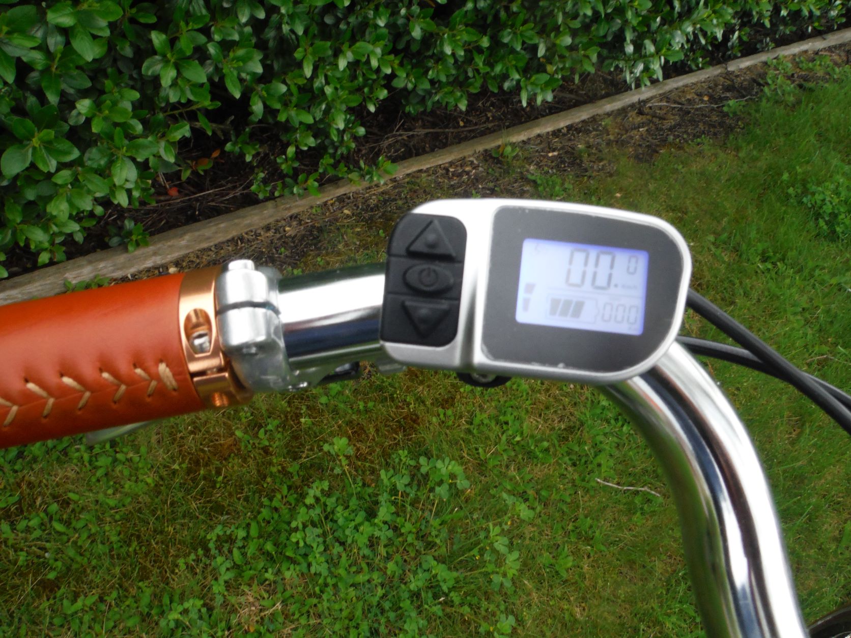

Let's assume it is a Nexus twist shift. The cable enters the shifter from the front side and wraps across the top. 3 is at top, 2 middle and 1 at the bottom. If it is stuck at one then the cable is too tight. It needs more slack to hit 2 and 3. Did you recently tighten the cable? It could also have a kink somewhere. Almost as if someone installed a mid-drive and ran the cable between the motor and the bottom bracket. Here is the three-speed I rode today. The bike has leather washers that support the fenders which match the tires.

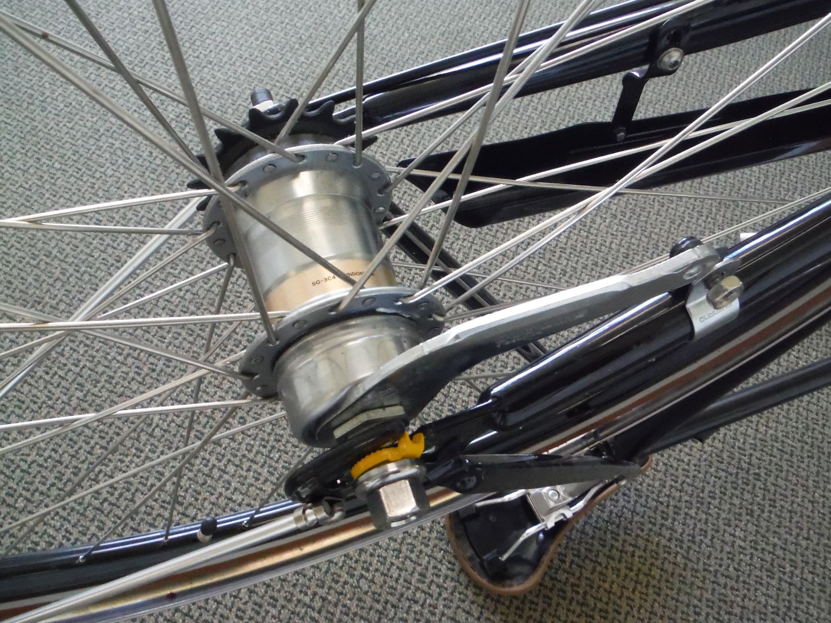

On the 3 speed hub you need to make your cable adjustment in 2nd gear. Adjust your cable length at the adjuster until the yellow line is in line with the marks on the housing. On my Dekra, I mounted a mirror to help ease this since my mount was a bit different with shaft drive.
