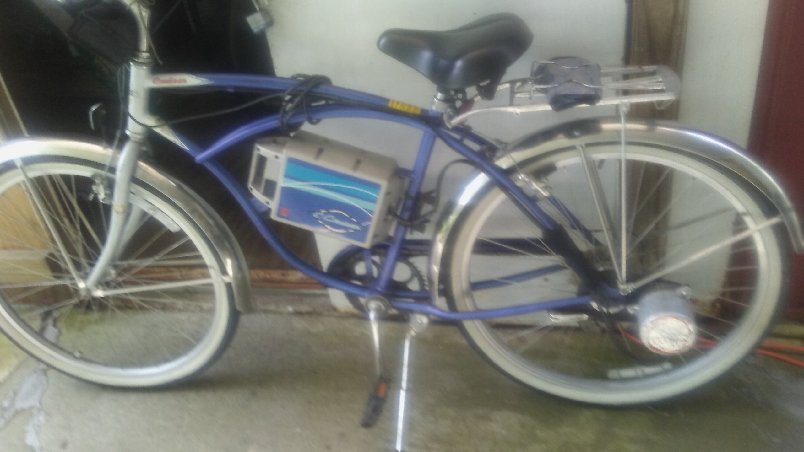

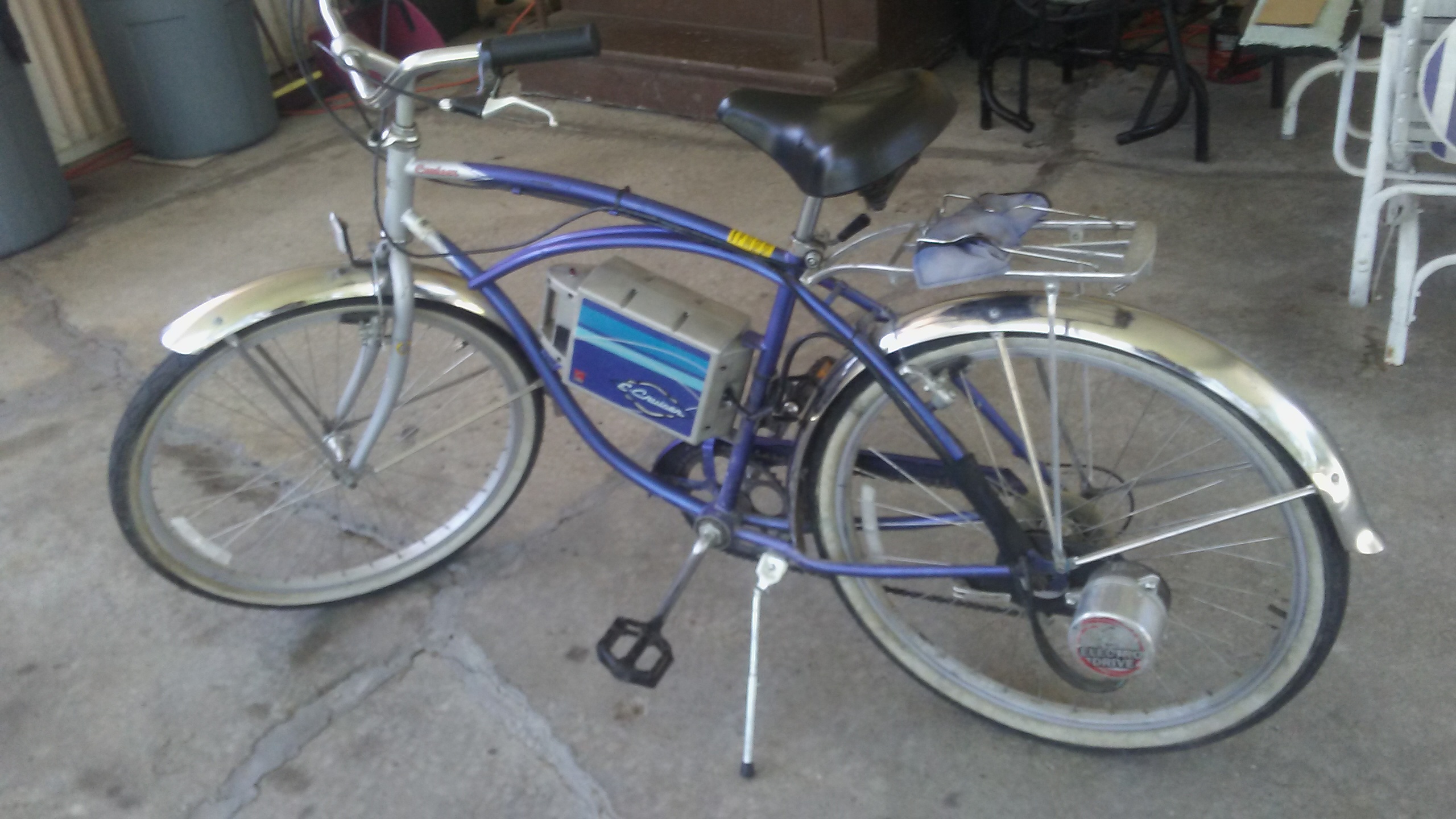

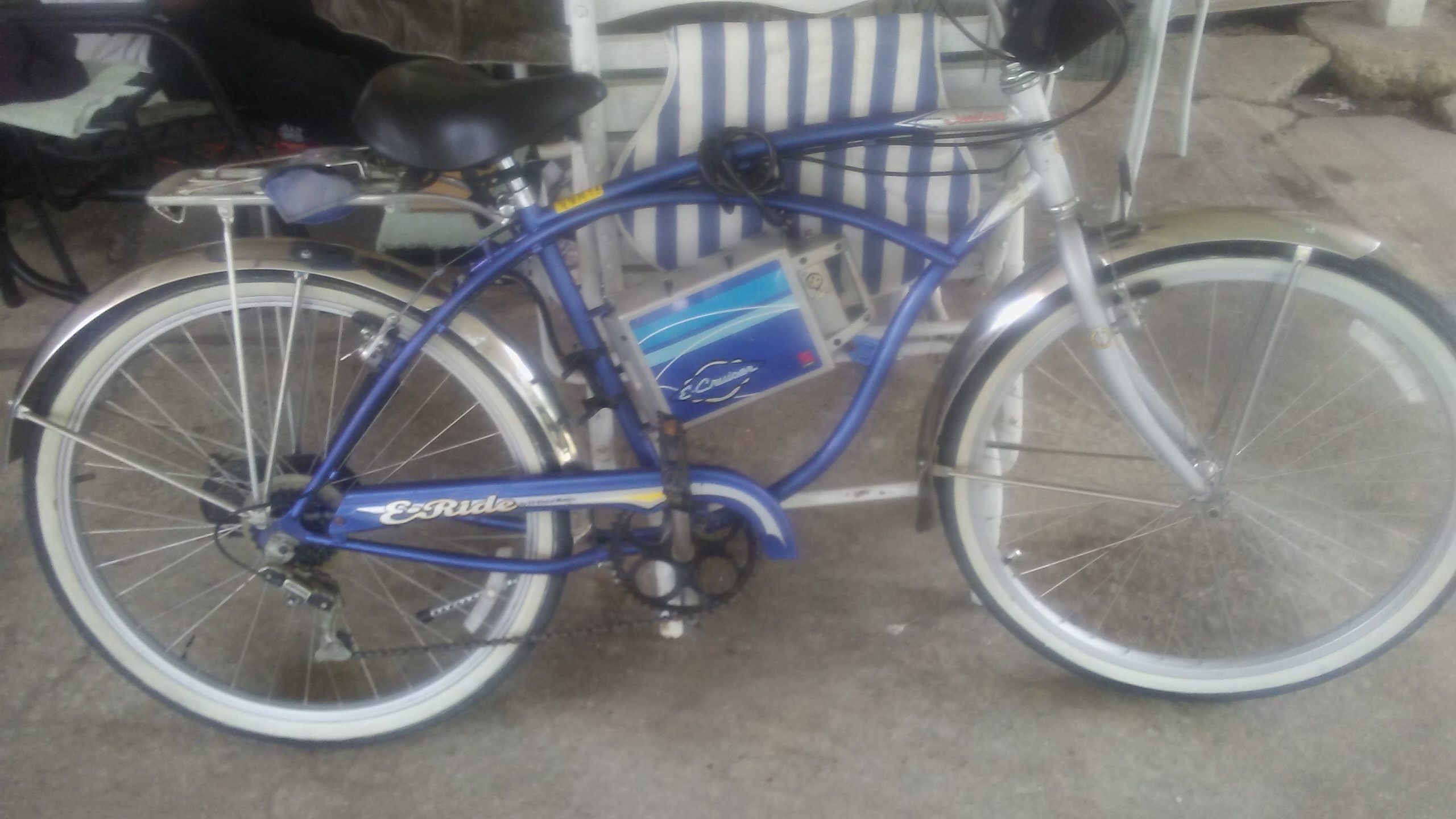

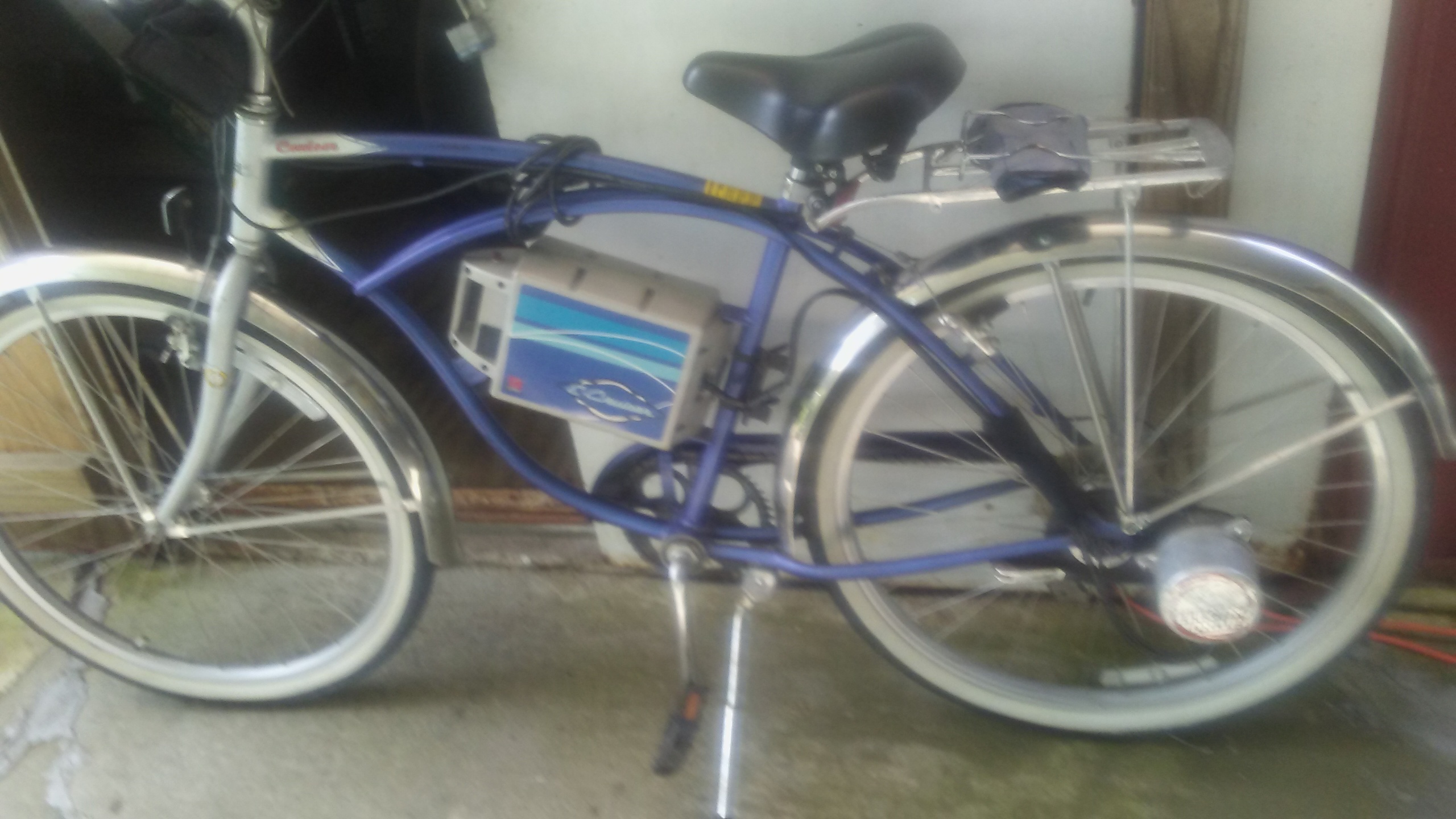

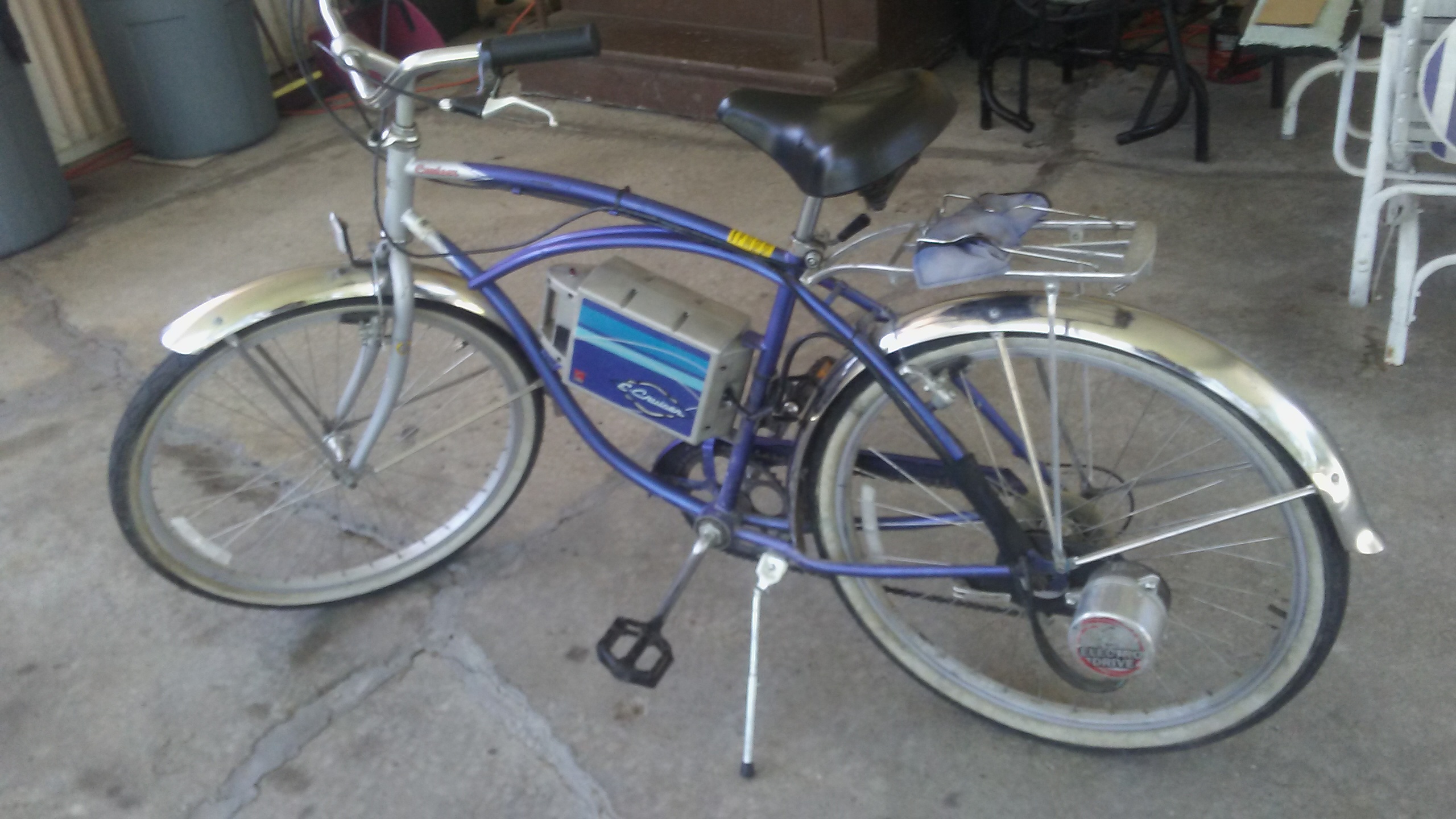

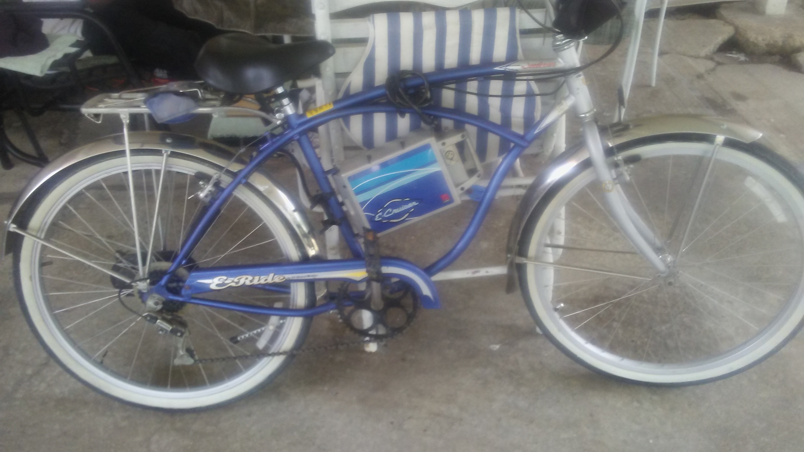

Can anyone please help me? Would like to know what year and approximate value of this E-V Global ebike. I have looked but cannot find it anywhere. Thanks. If you want you can email me at [email protected].
Can anyone please help me? Would like to know what year and approximate value of this E-V Global ebike. I have looked but cannot find it anywhere. Thanks. If you want you can email me at [email protected].View attachment 17250 View attachment 17250 View attachment 17251 View attachment 17252 View attachment 17250 View attachment 17252
This isn't a 2000 range EVG ebike, but looks like an early iZip....I have a 2009 range iZip Trailz that uses the same rear electric motor and had SLA in a rear rack battery box, though I've replaced it with 7s/10ah lipo. It works great with the rear wheel gear upgrade for 20mph, and for running the dogs!
Try your questions here.....
https://www.facebook.com/izipusa/?hc_ref=PAGES_TIMELINE
