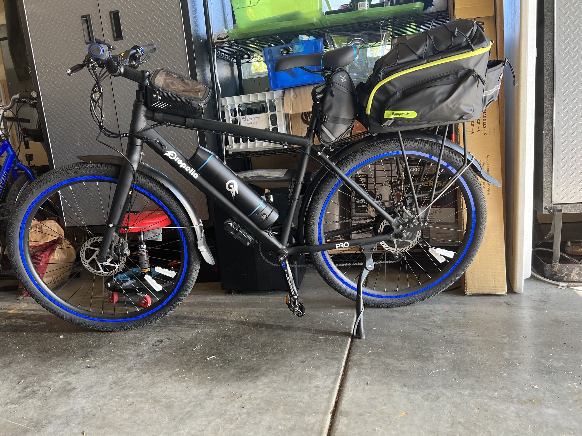

I just got a 9S and it’s great. But I missed those snazzy blue rims that the other models sport. My wife said it was kind of hard to see at night, so I shopped Amazon for some reflector Tape. Found some good 26” for $24.

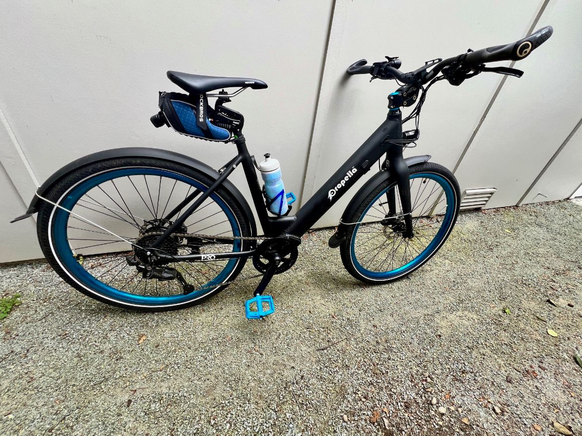

I always add a bit of kit to my bike. The Propella C9 V2 pro was quite comfy from the factory but these items are like icing on the cake!
- For comfort: Kinect Suspension seatpost & stem, reused a lighter, very comfy saddle I had on my carbon road bike, and Ergon G3 grips with 3 finger extensions. Together these really help reduce shock, vibration and fatigue.
- For function: Rock Bros saddle bag to carry a Foldy lock compact bike lock, the bike tool that came from Propella (still has room for a lightweight cycling jacket), phone mount, water bottle holder, Race Face nylon platform pedals (don't care for the OEM steel shin dingers) and Rock Bros bike bell.
The bike was quite comfy to start with and these items are the icing on the cake.
