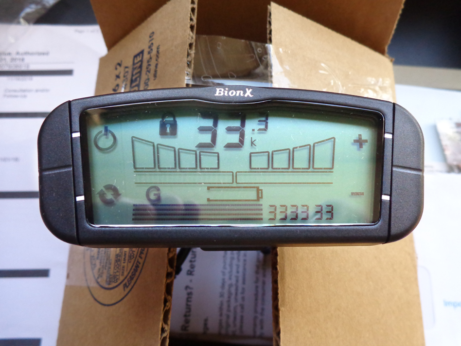

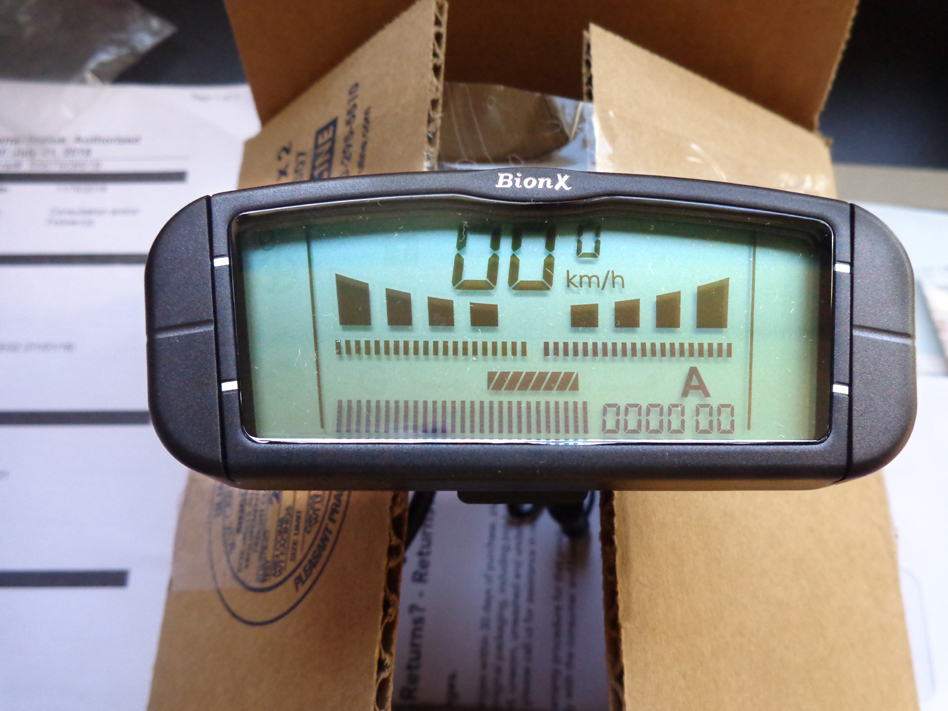

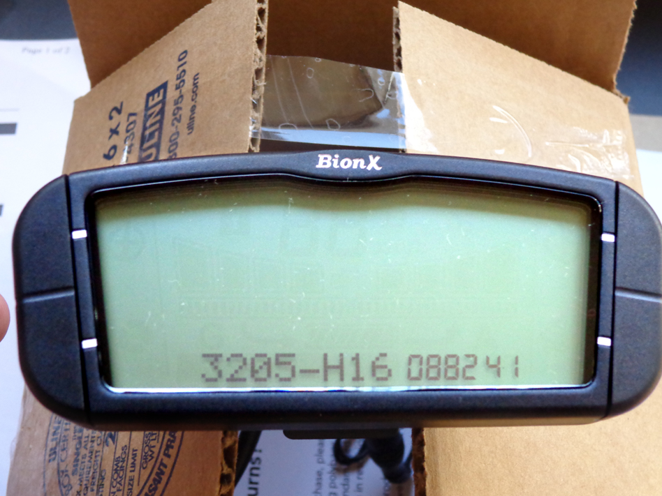

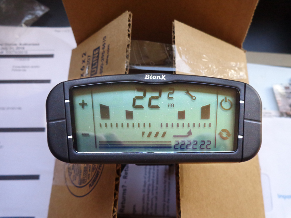

MY bike with a Bionx G2 system was stolen. I still have the G2 Battery, which is strong, and the charger so I'm trying to piece together another system from parts available online. I was able to get a G2 motor, controller & dock. Couldn't find a G2 (downtube) battery mount but was told that a G1 battery mount would work. I plugged the system together and the controller shows me 4 screens, none of which will let me control the motor normally. I have attached pictures of the 4 different screens.
Any Bionx electronics experts out there? Bionx Boot 01.jpgBionx Boot 02.jpgBionx Boot 03.jpgBionx Boot 04.jpg
Hi, G1 and G2 battery mounts are the same if the G1 is the version with CAN protocol. If you share the PN of the G1 battery mount I can tell you which version it is.
If you have G1 bm CAN version, than I think you will need a BBI software and tool to recalibrate everything. Bionx are calling it " Resolve inconsistencies".
