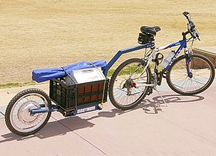

One kit that I came across, called the Electric Push Trailer, is very DIY. The company sells instructions for $10 to $20 and you have to build it yourself for between $500 and $800. Unfortunately, I'm not a welder and have very few tools so this kind of put me off. As I continued thinking about it, one idea that came to mind was the BOB Yak Trailer (second picture below).

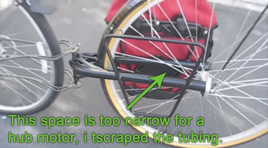

Hey Paul, you're correct about the Extrawheel experimentation... I think this might be the video you saw. I was very excited to convert it to electric and even got a hub motor but the narrow width of the rear "fork" on that thing actually rubbed on the motor casing which caused problems. It would have required custom fabrication to make work so I just sold the thing and started experimenting with other push trailers and ebikes. Note that the Extrawheel I got also didn't connect in a very sturdy way to the rear axle of my bike, it didn't bolt on like some other trailers but instead clamped onto a special adapter. I was concerned that with added weight and forces it might fall off and hurt someone or some thing. Here's a picture trying to show how the narrow spacing for the wheel mount was causing issues:

Court,
I can appreciate your concern about the attachment method of the Extrawheel. I haven't had an opportunity to inspect one in person, but it appears to be just spring tension that keeps it attached to the rear axle. I'm not sure how far it would travel if it detached, but a motor and battery would certainly be more dangerous than a load of camping gear.
