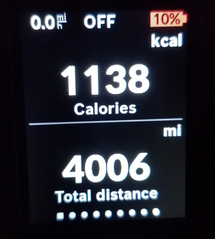

Hello guys! Newbie to the group here. I thought I'd post my experience of my Redux IE if that's ok.
I have a 2019 model that I bought last May and so far I have put over 4000 miles on it. In that time I have had 2 chains, 2 sets of brake pads and I'm on my first set of new tires (after a recent rear puncture).
A couple of problems I have encountered with the bike was when the bike stopped with an error message on the display E503 which I had to reset the display to allow me to get home.
I took it to the local dealer where I got the bike and they identified a battery cable had been pinched inside the frame and ordered a replacement.
I got that fitted under warranty a week later and it's been fine since.
The other problem was that not long after I got the bike, the front light stopped working. Fairly sure it was a break in the cable leading to the light from the bike. That got replaced under warranty but it took almost
5 months to arrive!
I use the bike for commuting to work on a round trip of 110 miles a week and it performs very well. I tested a Giant and a Yamaha bike but as soon as I set off on the Raleigh I knew that was the bike I wanted!
It's SO much more comfortable and smooth compared to the other two.
On the flat I've clocked just over 30mph and downhill, 40.5mph! Range has dropped a bit since I first got the bike to the point where now it will do just about 19-20 miles on full Turbo assist and the longest I've managed
is 36 miles on one battery charge using all levels of assist but mostly "Touring" level.

is 36 miles on one battery charge using all levels of assist but mostly "Touring" level.View attachment 63851View attachment 63852

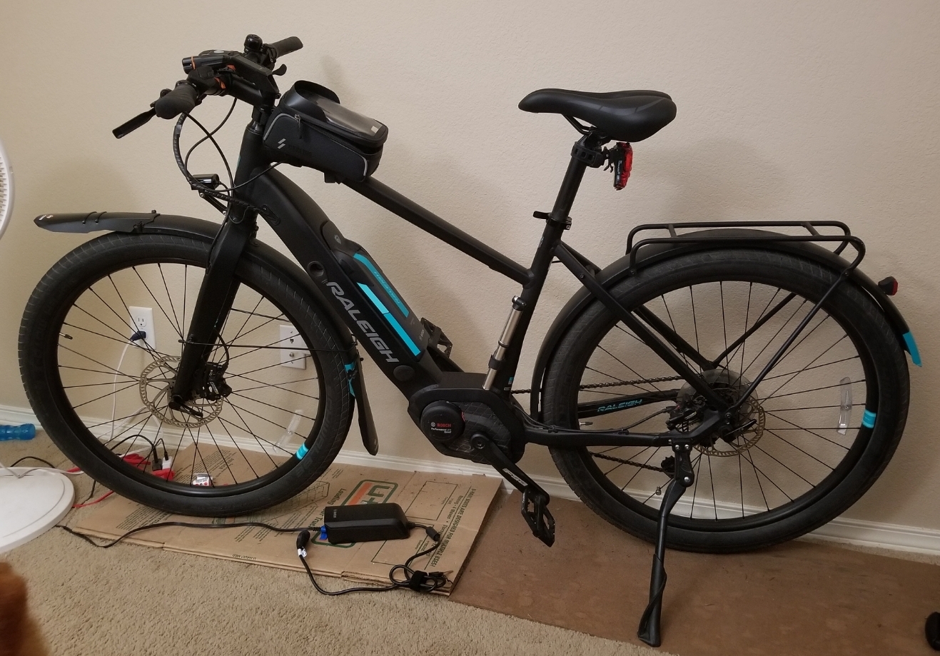

If anyone on this post needs parts for their 2018 Redux IE or iZIP Moda let me know. The battery on my Redux IE got wet and is dead. I can’t find a replacement from any source. I would sell the motor, controller, brake system or other parts. Very disappointing that Raleigh would abandon their user base like this!
Long term opinion. I got the bike in 2018. Now has 4K miles on it. Overall a well thought out nicely specd bike. No complaints on the ride quality, power, noise level etc. My only somewhat major complaint is, at around 2K the Brose motor was making nasty noises. I sent it out to https://ebikemotorrepair.com/ . Two of the sprags (freewheeling mechanism) had failed and the belt was about to. They rebuilt the motor with upgraded parts. Not an inexpensive proposition. Apparently this is (was) a quite common problem with these motors. Brose support in the USA is pretty much nonexistent and Raleigh was no longer in the US market. Ebike Motor Repair did a great job on the rebuild and it has been running better than new for the last 2K miles.
