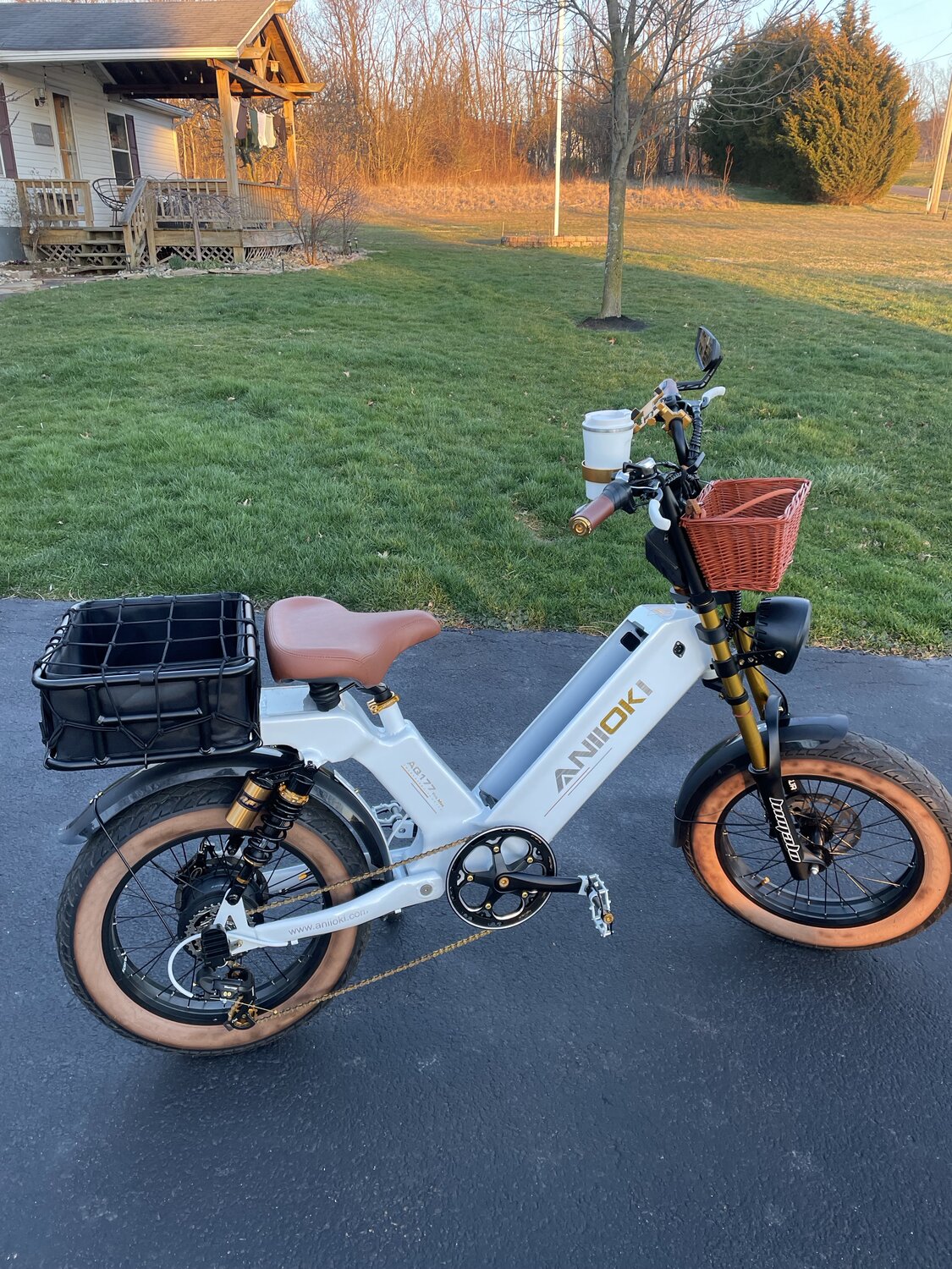

My wife’s 52V 60ah customized AQ177

I was looking at that one also as I wanted the 52V battery, but the Juliet used more standard bike components and had the cargo capacity I needed. I hope the bike is working well for her. That battery is a game changer.

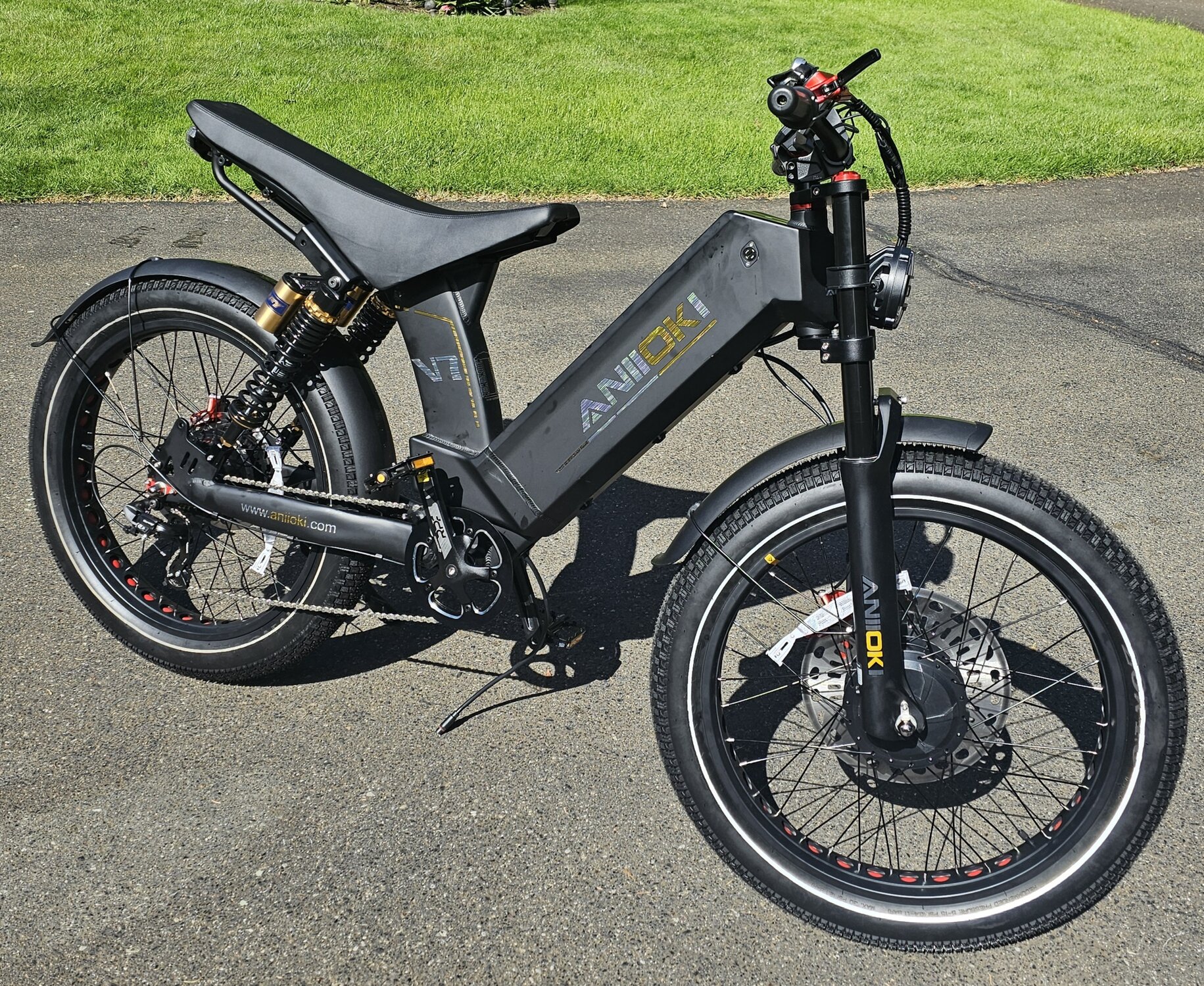

"The Beast" (Aniioki V7 Dual Motor 26" fattie) arrived yesterday. Assembled it, my back will never recover... The battery on this thing weighs over 30lbs. Methinks the 1500w front wheelset weighs the same, and that front brake...WTAF? It's like a minimally hollowed out thick piece of plate stainless! At least stopping this thing from full speed will NOT be an issue.
Only real disappointment so far is no front turn signals in the headlight or otherwise, and the goofy horn in the headlight. It looks like there's an off-the-shelf cadence sensor in the bottom bracket, which means I can likely slip the torque sensor in its place. Next trick is to find out if the controller has a torque sensor port, or if I need a Cycle Analyst to adapt it to the throttle port
Updated with first pic, after I replaced the stupid 4x 320mm fake gas shocks in the back with a pair of real 380mm shocks... BTW, the reason they did that was to lower the seat height and fix the suspension travel to about 10mm (it's 60mm now)
