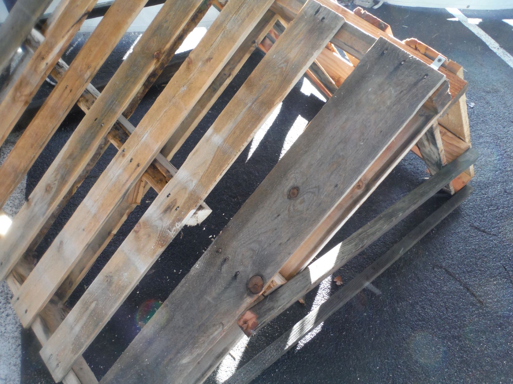

It is easy enough to make a stand out of wood. It sounds to me that these are slow leaks, and yes the lowered height of the bike will relatively raise the kickstand to push a bike over to the right. I will bet it is tubeless and sealant got into the O-ring of the valve because the 0-ring was not first dabbed with silicone O-ring lube. This outdoor pallet rack, when built, will hold eight bikes. All you need is a slot for a wheel.
