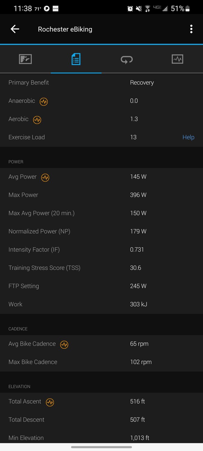

What was your own leg power (approximately) shown on your Fenix? Did you transfer the post-ride data to Strava perhaps?

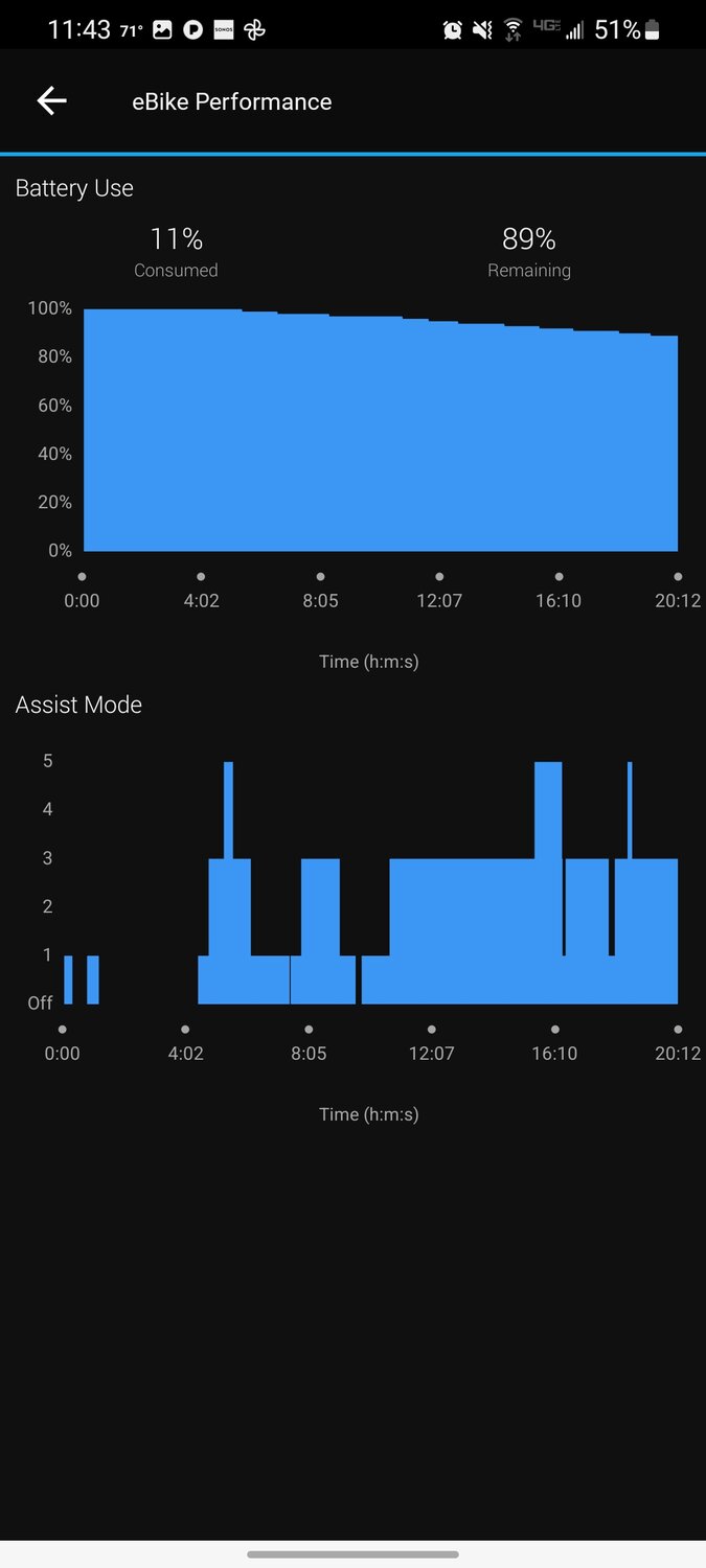

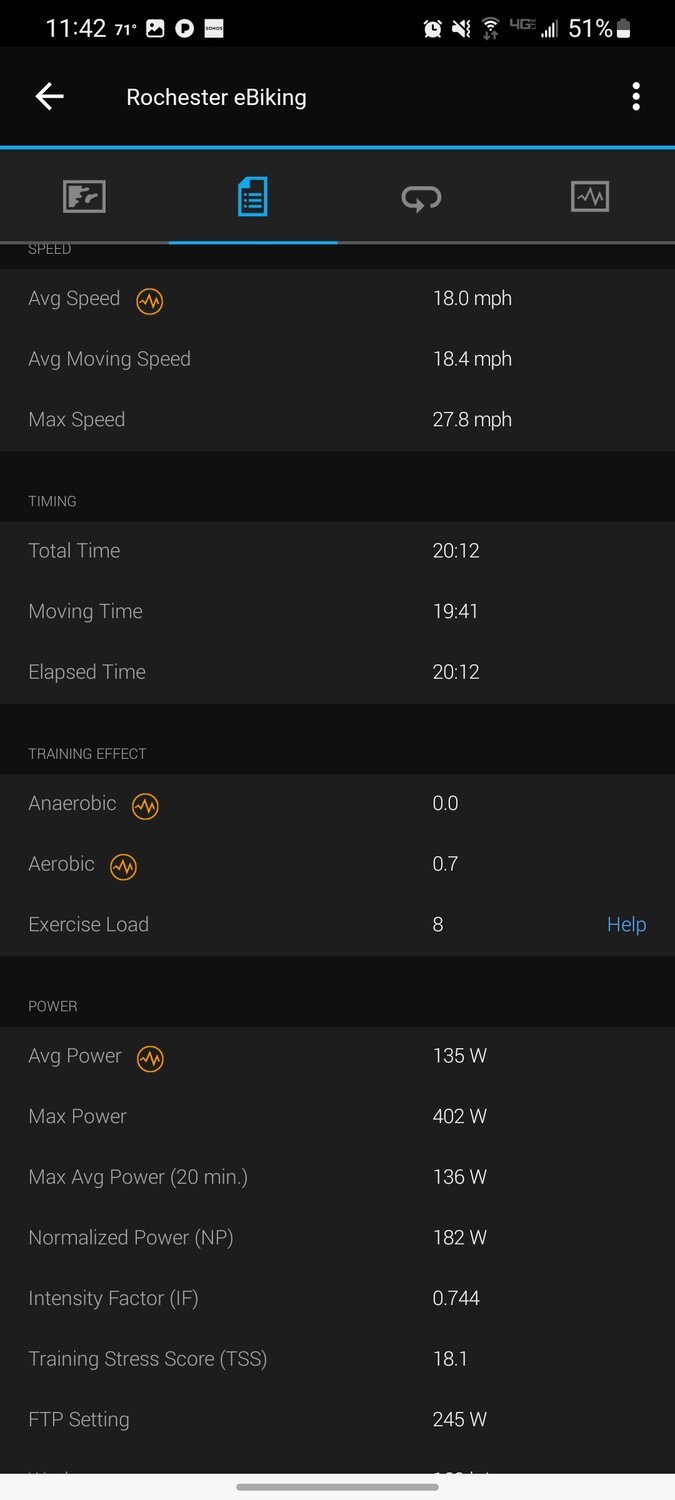

I didn't post to Strava, but I'll try to do that for future items. Here's a couple quick snips of my earlier ride, I monkeyed with some stuff later and lost some assist data. The first 2 images are of the same workout, the 2nd one is a longer ride, but doesn't have assist data. It is nice however that I don't have to purchase the expensive pedals, the ebike provides most of the power data itself if I'm reading it correctly.

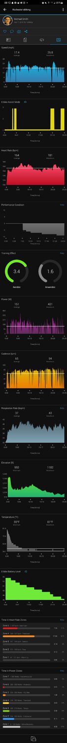

Stephan, I did another ride this morning with the premium eBike Garmin app. It did a much better job of displaying all the data, watts, assist, battery level. I very much love this app.
I'm still getting used to the bike and I need to be a bit more casual in my cadence and biking (this was a quick commute to work in eco mode). It was also 50F out, so it was chilly.
