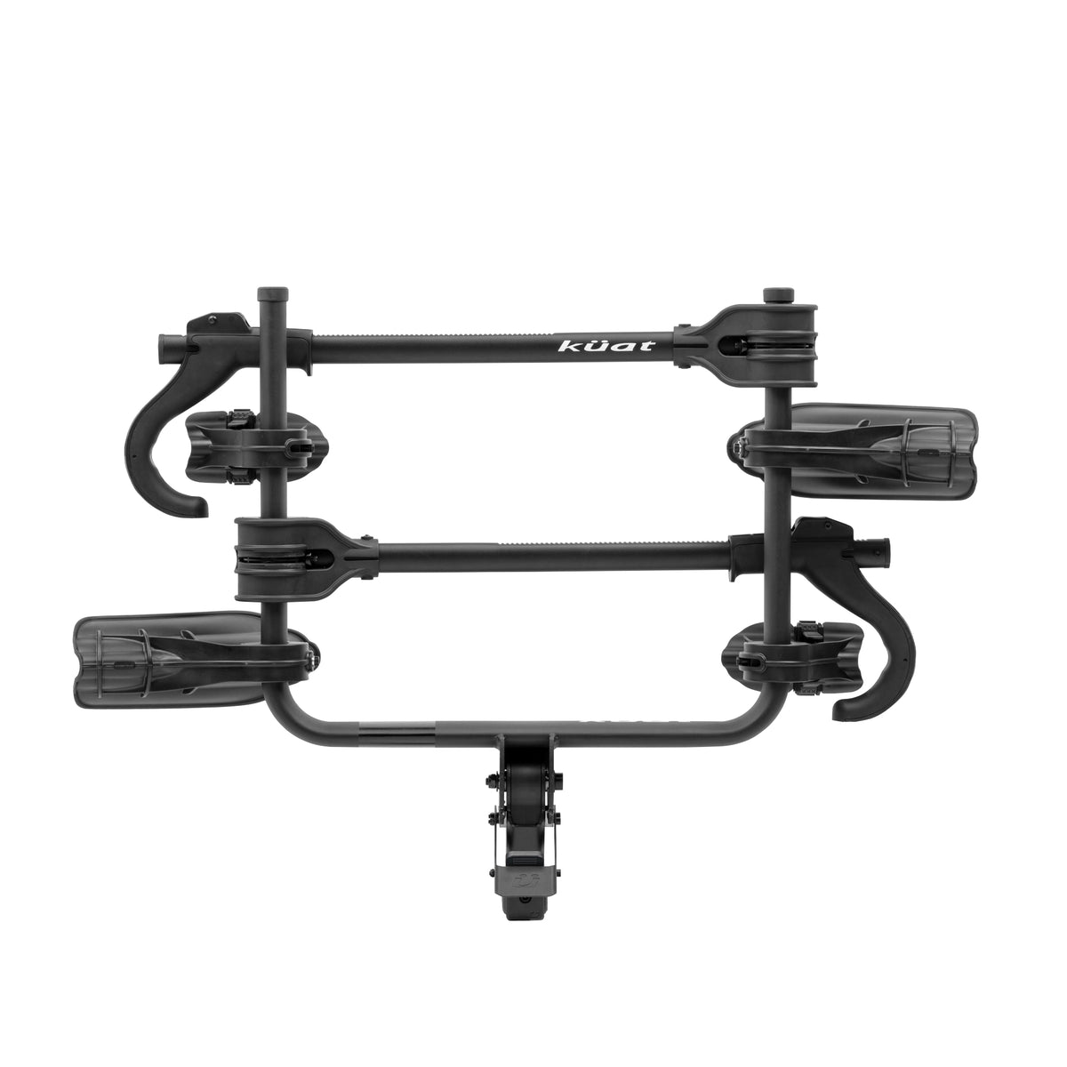

Thanks for all the input. By the way the Kuat rack I own, the front wheel secure arm has to be compressed on the front tire close to the fork.

A bit late to the party, but I've been using the Kuat rack with my Vade EQ 5.0 SL with the fender on. Seems secure, and doesn't damage the fender - just presses it down against the tire a bit. But its flexible. The Kuat arm sits close to the fork, and past the top of the wheel - so it isn't going anywhere. (the compressed Kuat arm is shorter than the wheel diameter in that location).

Kuat Transfer 2.0 (single bike model)
Max bike weight is 60# - fine for the SL - probably not for some heavier ebikes.
I do use the provided velcro strap which is supposed to be optional for bikes under 40 pounds.

I've got the Kuat Sherpa 2. It is a two bike carrier and it can hold TWO FORTY pound bikes. I don't believe there is loading ramp option/accessory for dealing with heavier bikes.

Some of my bike buddies have the Sherpa 2. It is sturdier, with higher capacity, and the arm locking mechanism seems a bit more bullet proof. The Transfer is lighter, and came in a one bike version (making it lighter still). And cheaper! All played into my decision tree. :)

I will add that fenders can interfere with locating the locking arm. The arm's hook is suppose to be as close to the fork as possible. This location is intended to keep the locking arm potentially slipping off the front of the wheel. Close to the fork means that it is in a narrower area of the wheel radius and can't creep forward. It can distort fenders - some use pipe insulation or foam to keep the fenders from deflecting.

The arm does compress the fender ahead of the front fork. But it is flexible, and so far has not damaged it. But it would be more secure if it locked down on the wheel instead of the fender.
