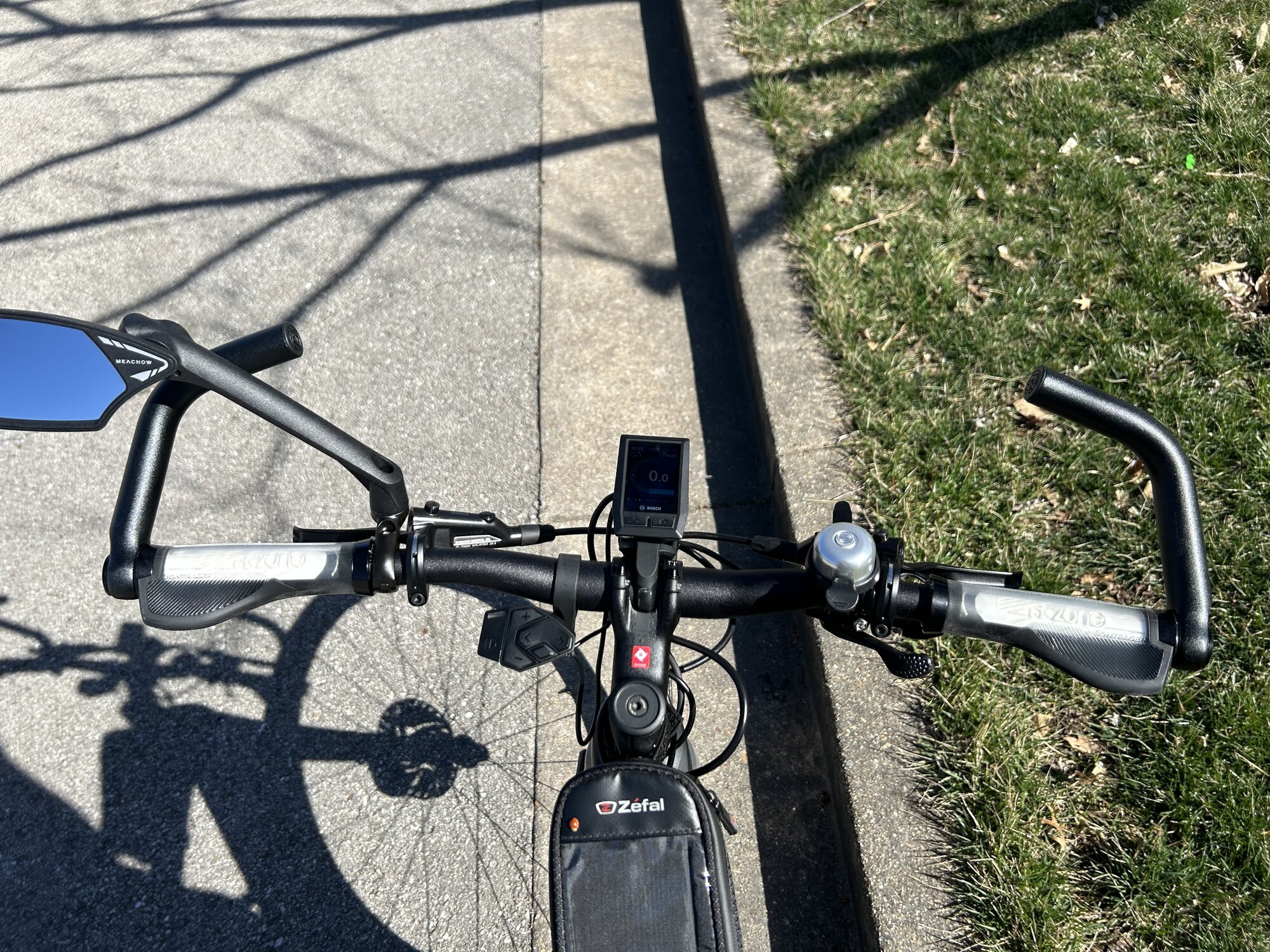

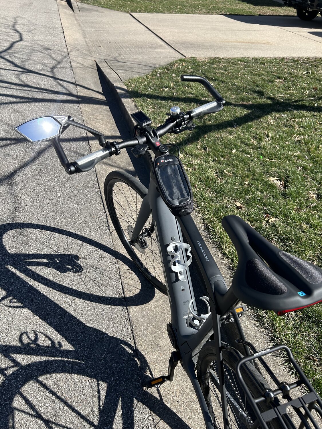

I recently had my Cannondale Topstone Neo Lefty 3 converted from a drop bar to a flat bar setup.
My reason for the conversion was on longer rides I would be constantly fighting numbness in my thumb and next two fingers on both hands.
I hoped that switching to a flat bar setup would lessen my finger numbing and the gamble paid off. I recently did a 50km ride and had zero numbness. 🥳
After some research I bought a Denham handlebar (designed by Alee Denham). The bar has a 34 degree sweep at the bar ends and horns, allowing for a more aero position.
I really like this handlebar and I'm very happy with the conversion.
Link to handlebar: https://www.cyclesense.co.uk/m61b0s745p26689/KOGA-Satori-Denham-Handlebar-31-8mm

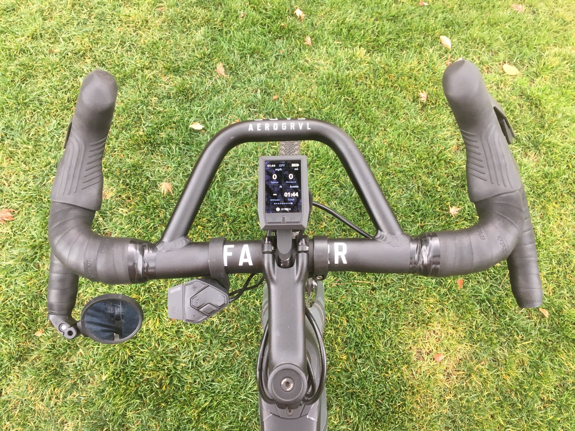

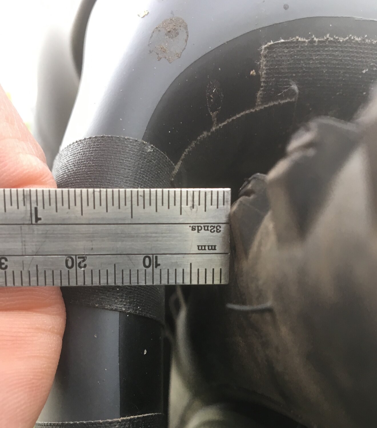

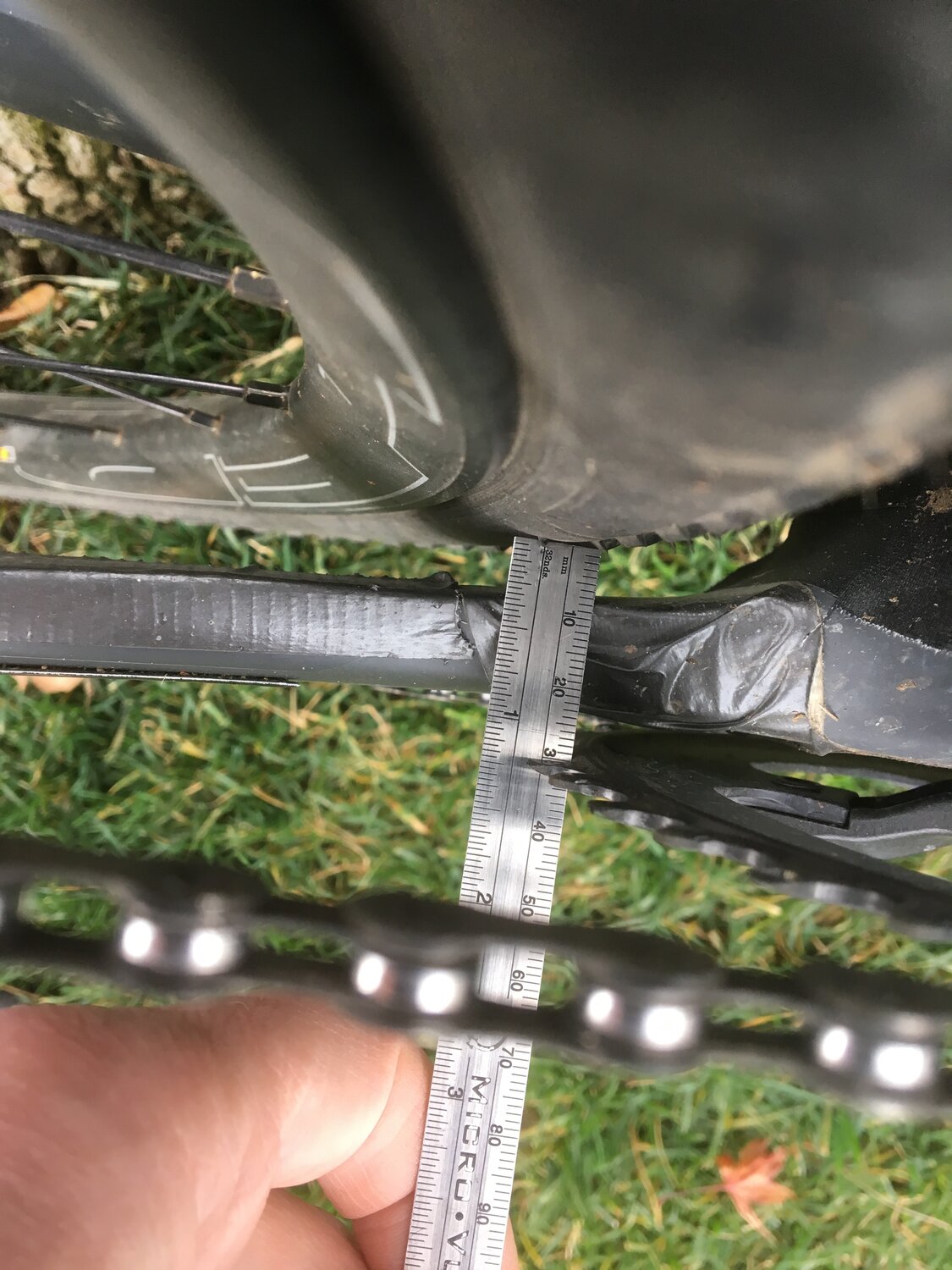

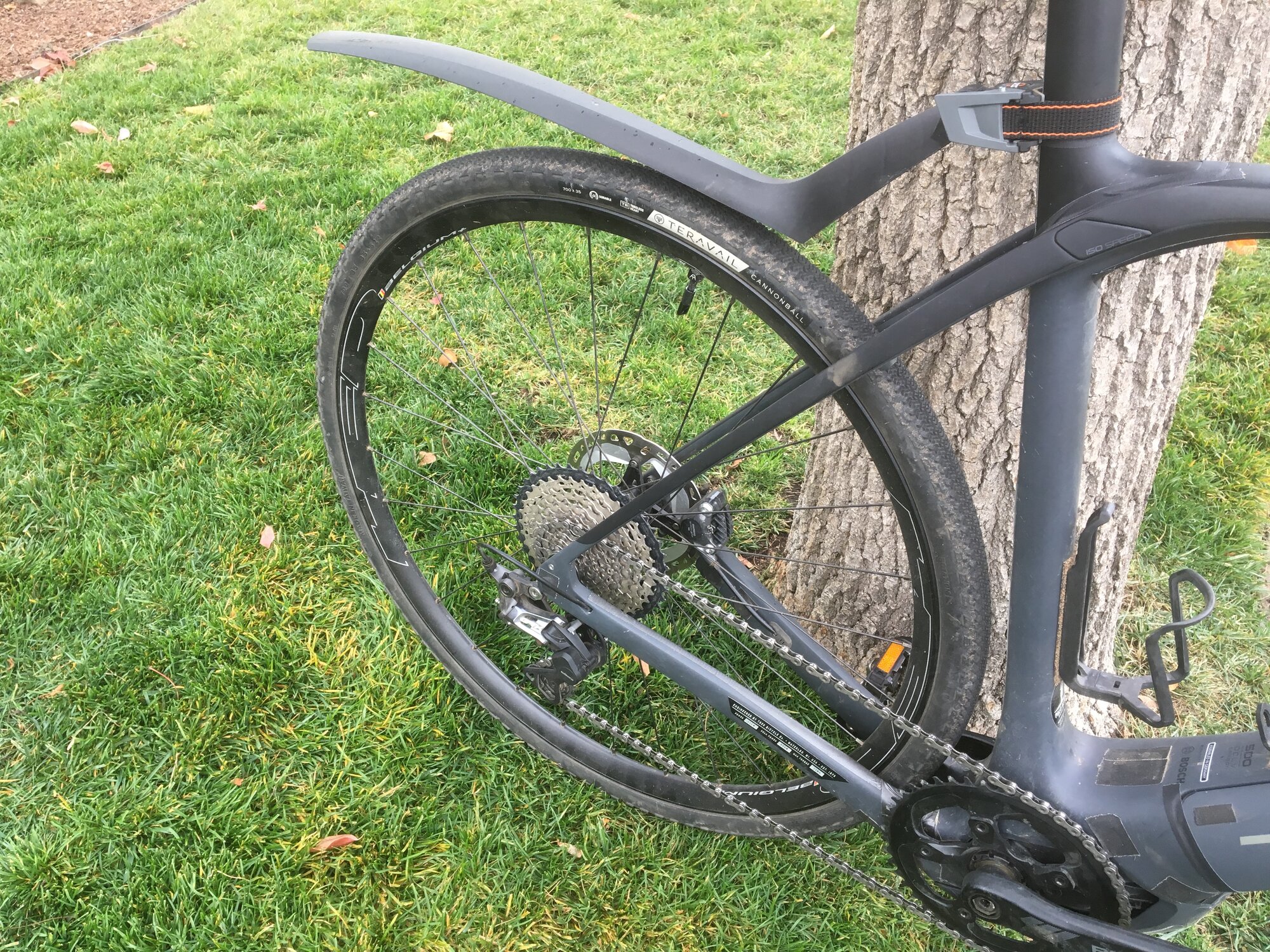

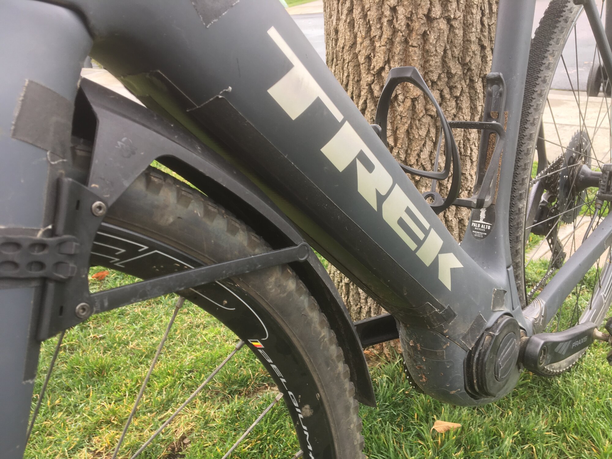

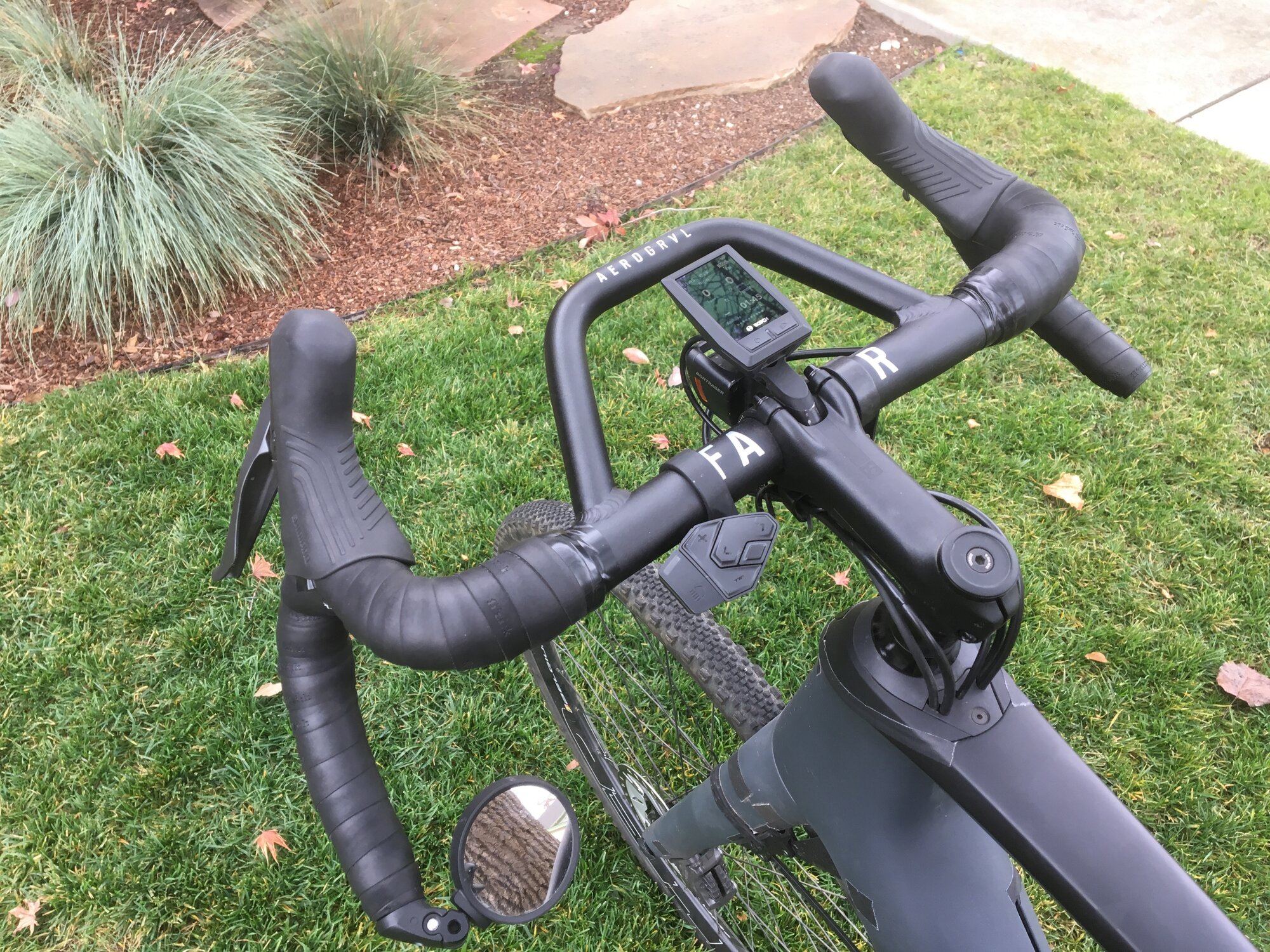

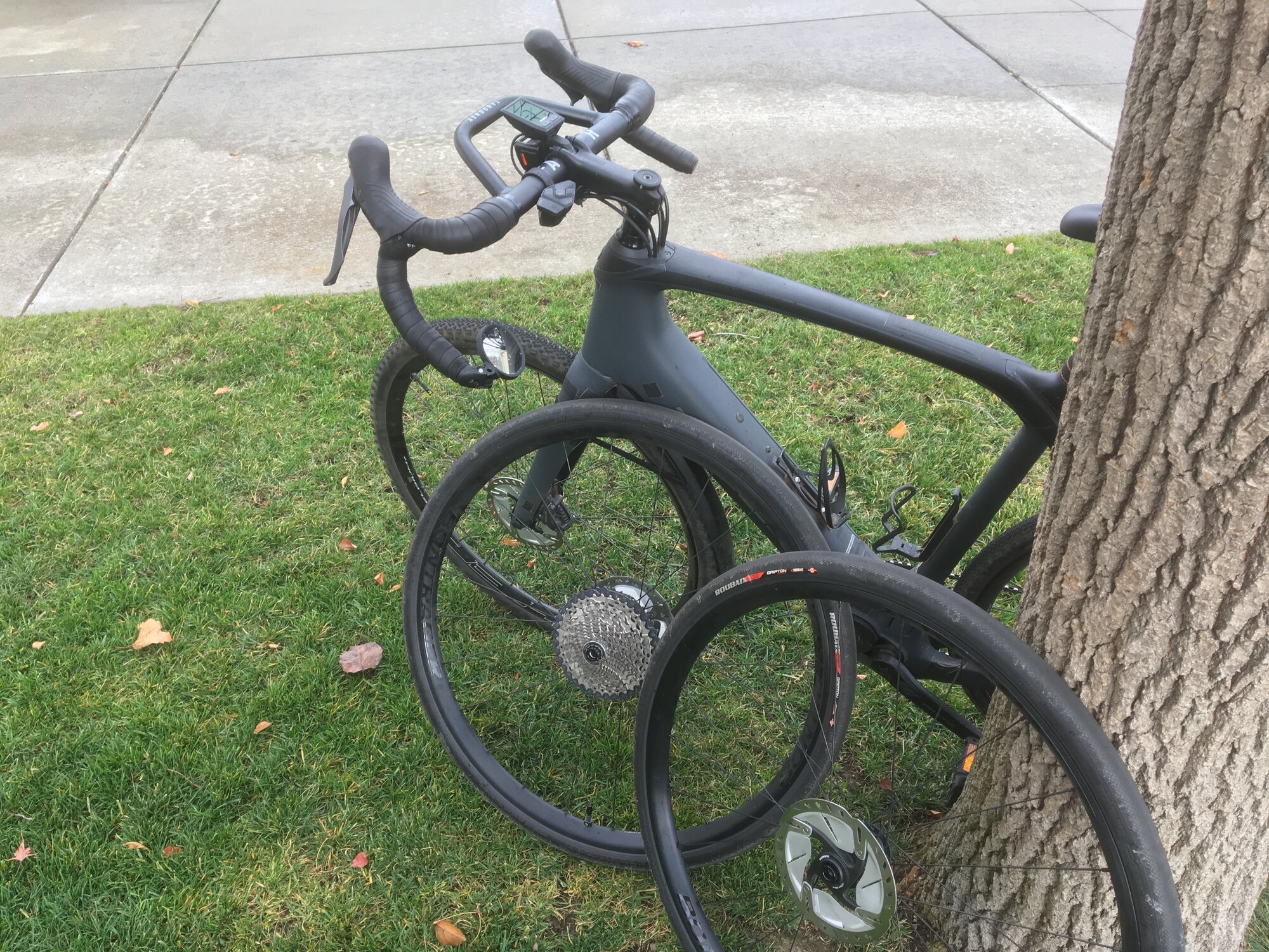

Bars and Tires and Mirrors Oh My! All the things I have been considering with my 2021 Domane+ HP.
Bars: I chose an aero gravel, so wider and aero position, didn't have to change any components and doesn't block the light. I don't think it is working very well for me for long duration aero position as it doesn't extend forward far enough, but I does give me some more hand positions, even to just hook my thumb around, and it gives my computer a little protection. The extra width is good for gravel, and the flare puts my hand position rotated between a normal drop bar and a flat bar and I find the ergonomics good for me. It also allows me to mount my mirror on the inside and it is still effective.
https://www.amazon.com/gp/product/B01AVHQB22 (62mm)
Tires: Front has much more clearance than the rear. I think a 38mm tire is as wide as I would like in the rear. 38mm actual, not what the tire says as they are often 2mm narrower or wider. Front I would be ok with 40mm measured max and probably even 42mm as a max. In both cases I put removable tape to protect from tires with built up mud. I highly recommend this. Gaffers tape and/or 3m No Residue Duct Tape.
I'm using the following running all tubeless:
Gravel Front: WTB Raddler 40mm tire (measures 38mm) on HED Belgium G 700 x 25mm inner rim with White Industries hubs.
Gravel Rear: Terravail Cannonball 35mm tire (measures 37mm) on HED Belgium G 700 x 25mm inner rim with White Industries hubs.
(Cannonball is more rounded than Raddler which also helps with the rear clearance)
(Decided against 650b and glad I did)
Road Front/Rear: Specialized Roubaix Pro Tubeless 30/32 (measures 35mm) on stock Bontrager 700 x 25mm inner rim wheels.
(These tires work well at a great price, but it is a firmer tire than the Schwalbe G-One Speed 35mm that came stock)
Here we go with too many pictures (to make markybolton happy!)
Damn I like your handlebars! Are the aerobars built in? Who is the manufacturer?

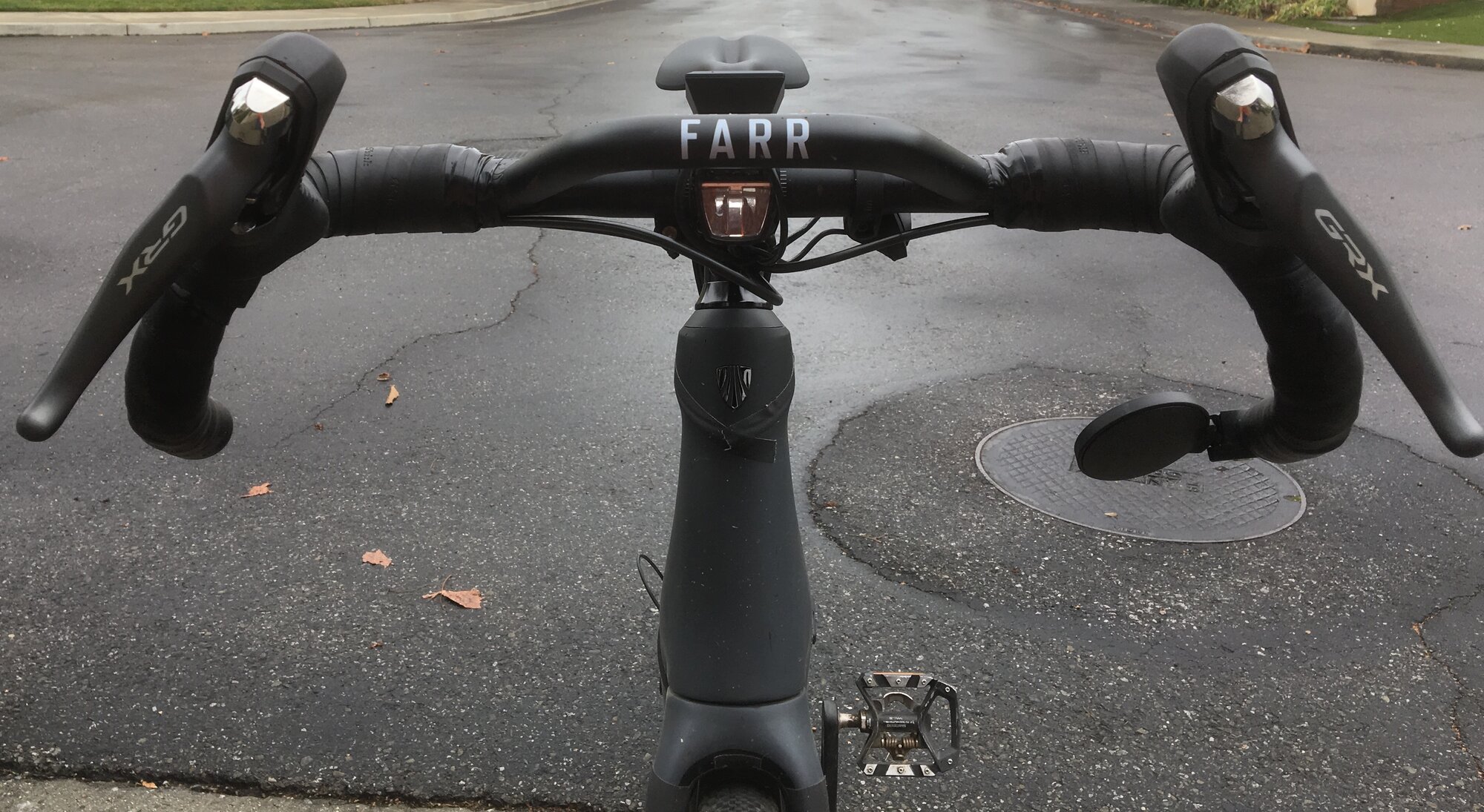

Thank you for posting these. I changed my Domane+ recently to a flat bar. Did have to buy both L/R shifters from Shimano sl-rs700 set. Brake levers were same as used on the Trek FX Sport 6. Bike shop did the install - no major issues encountered. Kept my brakes, derailer, cassette.
