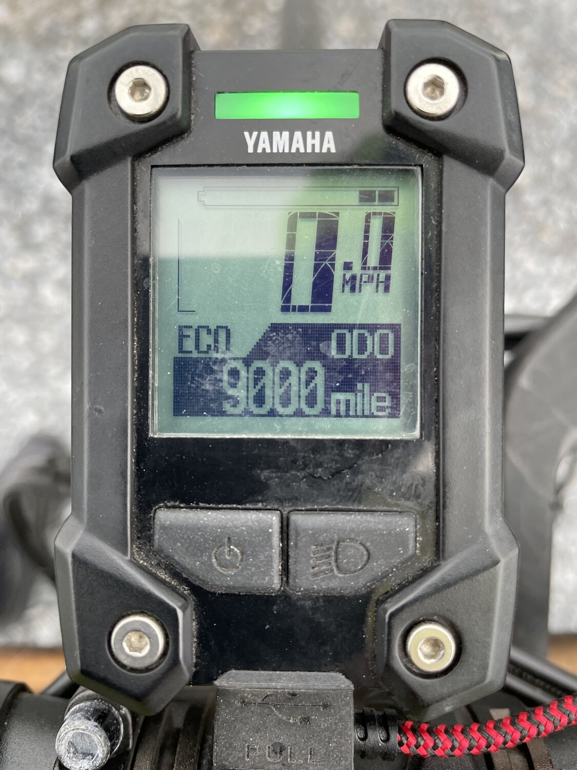

My Civante is now 3 years old and has 9000 miles on the ODO. I have logged 182 battery changes. That would be 49 average miles per charge. To stop the creeping sound, I keep the motor mount bolts tight and the bike still runs well. The only issue that I recently noticed is the ODO seems to occasionally stop adding miles.
I’ve ridden the bike hard and fast. I also have many thousands of miles carrying heavily loaded panniers. I’m happy with the purchase and feel the bike was a great value for the price in 2020. $3000.
