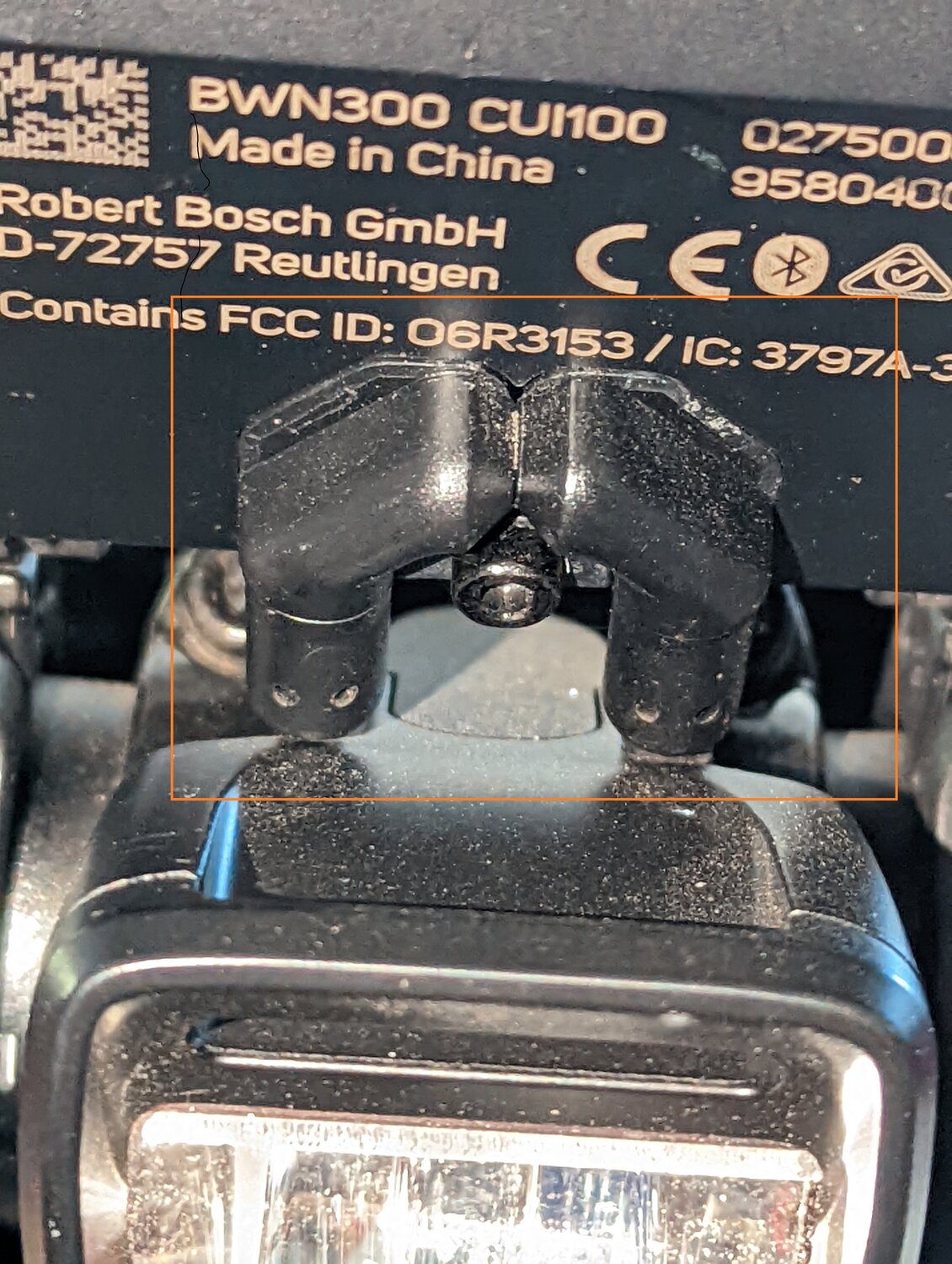

Unfortunately, my setup looks sadly different. Here's the back of my smartphone hub. The connectors are boxed in red.

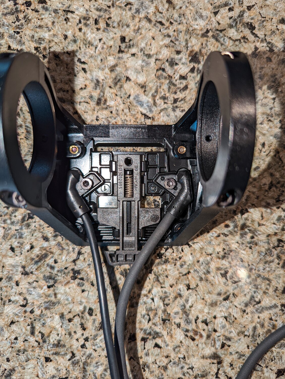

The back of my Nyon upgrade kit wires look like what you pictured:
Thoughts?

yep thats right its just he position of the wires. on the nyon the overlap. you just need to make sure you get them in the right order of overlap. oops forgot they don't overlap on the nyon they do on the kiox. same wires though for all three just change the remote.

So you're saying they're the same? Well I'll be...so on the smartphone hub there's two pieces held by one bracket, while on the Nyon mount they're held by separate screws? Hope so. If that's the case, you made my day. I'll try things out in the morning.

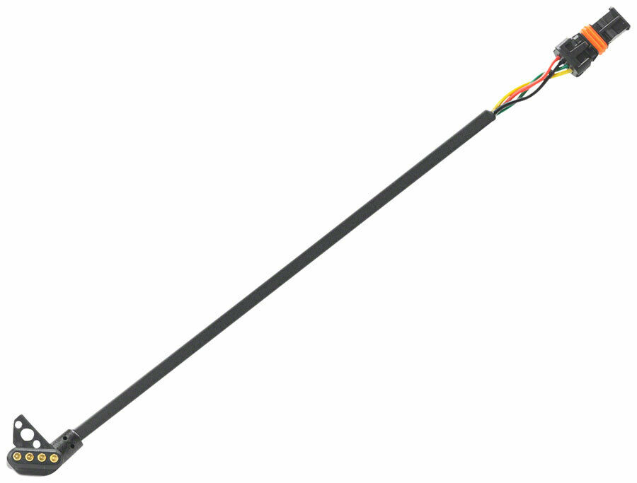

Why change the remote? On my setup at least, the remote cable has lots of slack, and looks identical.

yep the remotes are different thats what my mechanic found. I have to buy another one for the bike it was remove from. ya the dimmer switch is cool the nyon does not control the light at all now. that threw me a bit but I leave them on always so thats fine.

The remotes look the same to me. I'll look at the part numbers tomorrow. Another interesting thing I noticed was the torque specs for the mounts - 1 nm! I think my torque wrench goes that low....

OK. Did the install today. Hardest part was removing the wire/connector ends from the nyon in order to use my current cables. It helped to loosen the mounting plate - note torx not allen heads....
Once that was done, the rest went really fast. No need to change the remote. Everything seems to work, but have not yet road tested it. Frankly, it took as long for the GPS to sync up as it did to do the bulk of the install.
