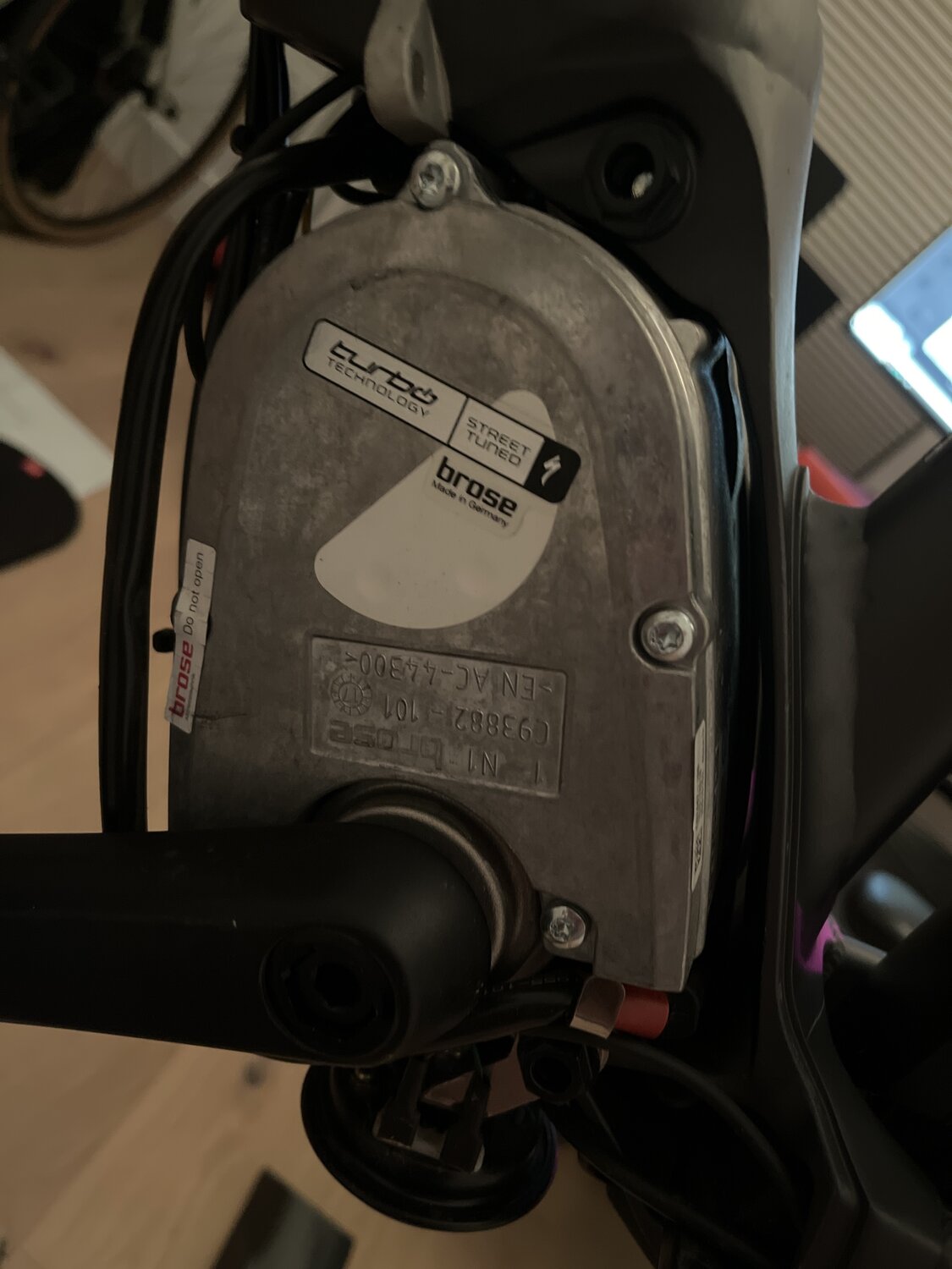

When looking at the motor it does have a "street tuned" sticker, but there wasn't anything obvious indicating 1.2s or 1.3, so I'd assume it's 1.2s like you said it was supposed to have. Maybe once I do the TCD retrofit I'll be able to confirm the motor in the app.

This bike was making a creaking/popping noise when starting up from stop. I found the motor torque TDS in one of your threads, and after doing that process it's been quiet so far.
