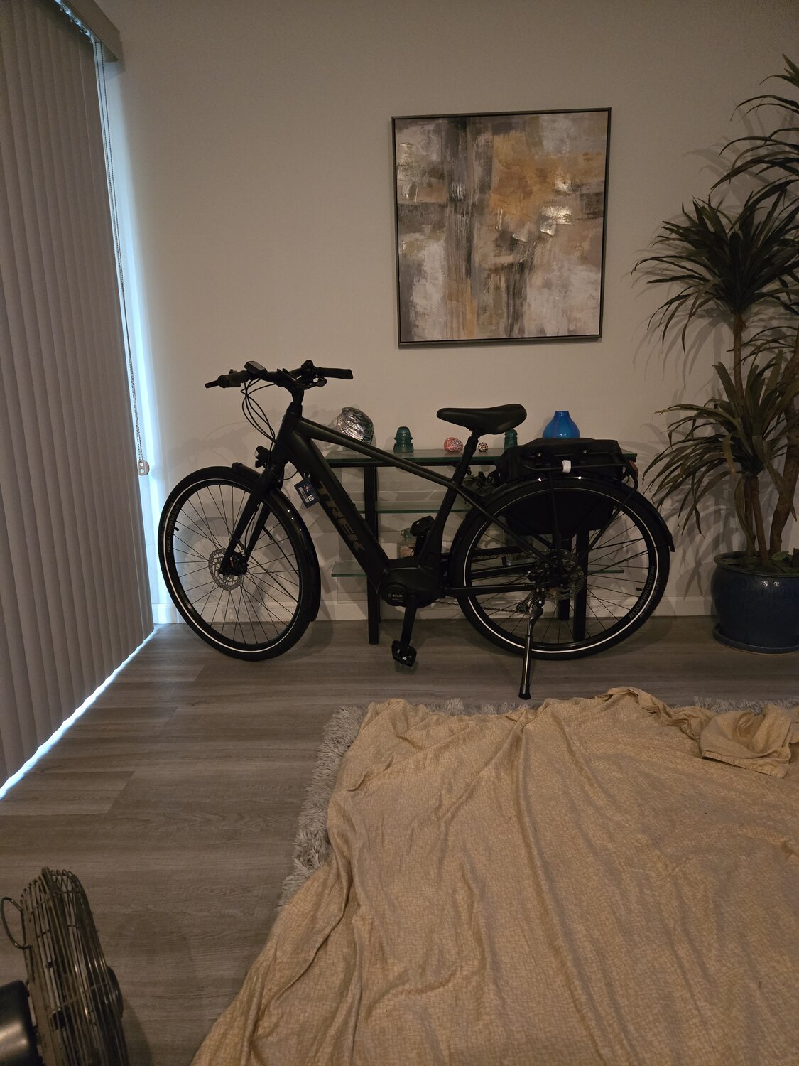

Hello all!
I might be the uneducated ebike champion of the decade, but I thought I did my fair share of research prior to buying my Verve + 3.
I realize that my top speed of 19.5 mph is rather boring and most of my club Rider friends are passing me, quite discouraging!
So I am wondering how most people unlock the fixed threshold of 19.5 mph on a Bosch active line Plus Motor?
I have read There are chips that can be placed to bypass the limiter. But I'm very skeptical and leery about messing with the electronics as it might potentially brick the motor and void my warranty.
I really like the bike, but it's rather sedate. Any input would be greatly appreciated to start my searches.
Lastly I should add that I don't need to really go faster than 28 mph (class 3) but I would like that extra speed on the flat open roads.
I know most of the time I'll be cruising around between 17 and 19, I just don't want to be limited at 19.5 mph.

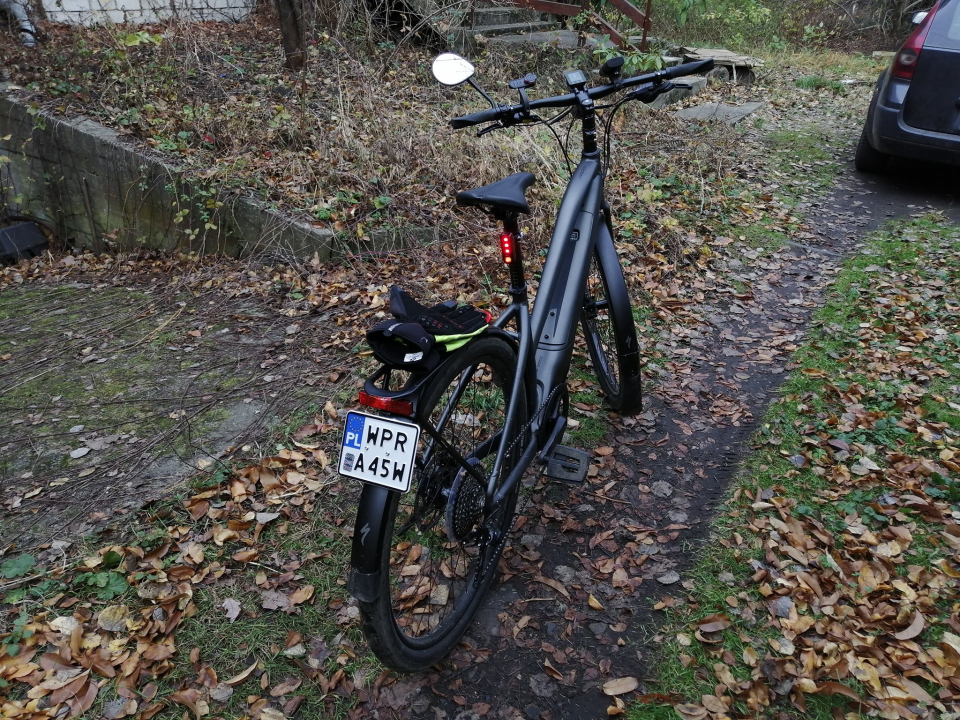

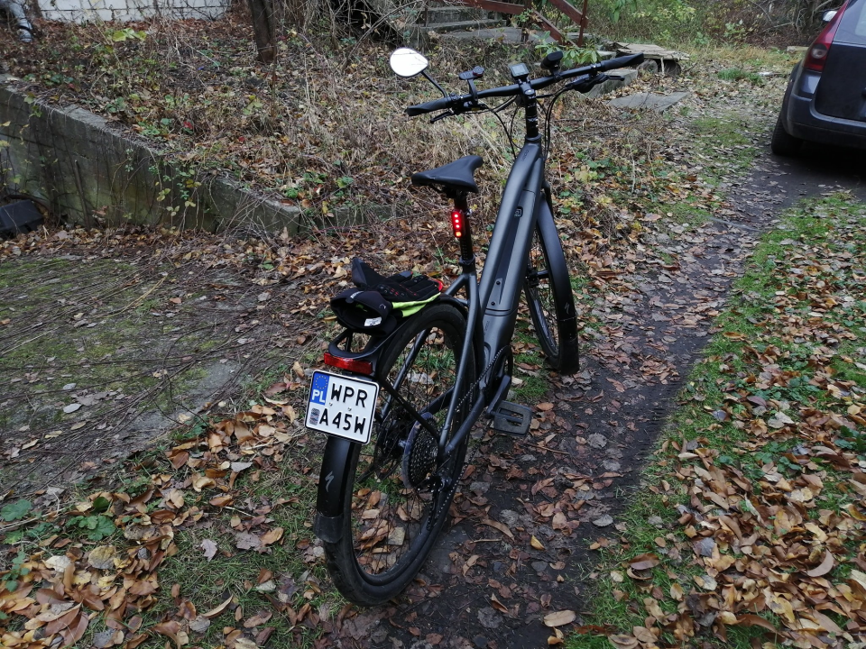

Technically speaking, it is legal to register and insure the European L1e-B 28 mph e-bike in the UK. The downside is you mustn't ride bike paths, and you must wear a full-face helmet (it is only the UK that requires it!) On the other hand, the big manufacturers almost all resign from making L1e-Bs because these e-bikes require a costly safety equipment and expensive Type Approval certification.
(Ask me how I know...) An L1e-B in Poland.
As far as I can see, the L1e-Bs have become an extinct race here on our continent.
