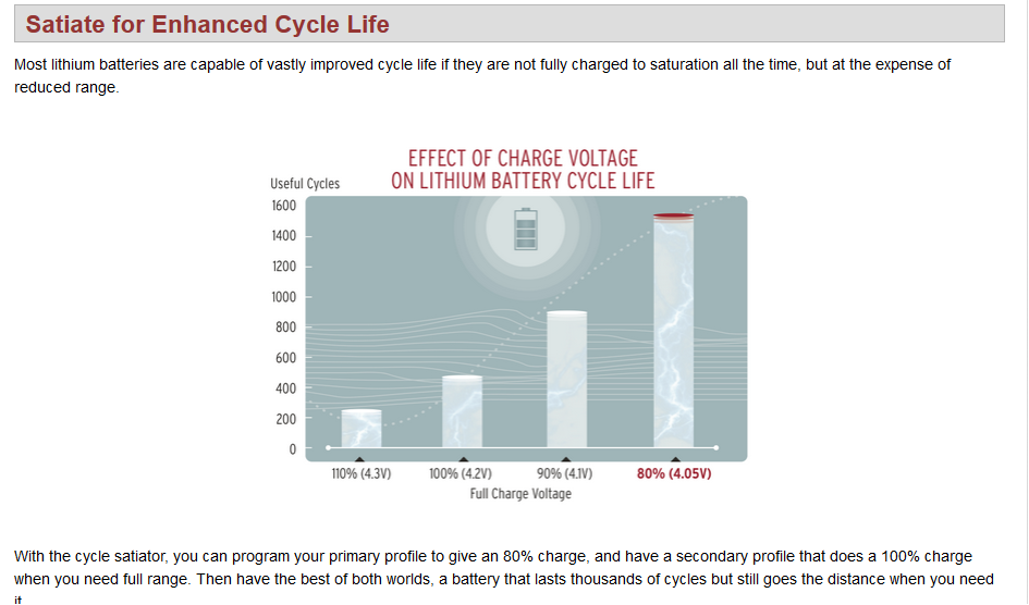

I am looking at buying an electric bike so I have done some reading to educate myself. At this time I must say the Teo fat bike is on top of the list.
For what its worth, here is something I picked up on the Goldenmotors.ca site
So it would appear that not fully charging your battery would have a serious positive impact on battery life. I believe fully discharging it once in a while is a good practice however.
At 400$ CAD, the Golden Motors cycle satiator is not cheap but it allows you to quickly charge any type of battery and program the charge level you want to get. So if the data in the graph above is true, it may very well be the best investment you can make to enhance battery life.
If anyone wants to check it out:
https://www.goldenmotor.ca/products/Cycle-Satiator.html
I hope this helps!

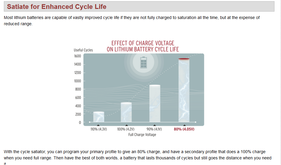

I hope this helps!
Thank you for this. I too have been doing some research and have found out just about the same. That you should avoid charging to 100% all the time, and charge up to 80% to get better battery life. Use only 100% when planning an extended trek with your e-bike.
I have read very good reviews and seen some good comments on this Luna Cycle Advanced charger. It offers 2 neat features: 3 or 5 amp charging and 80 or 100% charge, just by flipping a switch or sliding another. At $99 USD + $7 for the cable adapter, it looks to me as a decent alternative. As a matter of fact I just bought one, I will leave the Téo provided charger at my son's home, and keep the Luna model at home here. When I visit my son, I'll need a quick & dirty charge to get back home. At home I'll put Téo on Luna' s slow and 80% charge. I'm a bit anal with battery maintenance, I have many years of boating and RV experiences and have always cared well for my batteries.
Here is the link https://lunacycle.com/batteries/chargers/luna-charger-48v-advanced-300w-ebike-charger/

I just watched the video in the following link. An interview by Court of the founder of Grin Technologies; a truly passionate electrical engineer who has dedicated his career to ebikes and, to a lesser degree, eskateboards.
This guy is also the inventor of the cycle satiator I referred to in my previous post. Goldenmotor.ca is a distributor.
Batteries wear out.
It is a long video but I enjoyed every second of it. For those who are mostly interested in this thread's topic, it starts at 00:18 and lasts for about 5 minutes.
From what I understood of the video ... battery chemistry is very complicated but there are some elements that seem to draw a consensus:
  • When in storage, never let the battery discharge completely. Keep it as close as possible to a 50% charge at all times.
  • When utilizing the bike, keeping a battery "charge range" between 0% and 60% is better than a 20% to 80% range
  • An occasional full charge is a good thing as some batteries will need this to balance the cells.
I hope I understood correctly but if I did not, feel free to correct me. :)
Hello @america94. In this particular case, the Gospel didn't spread very far: I live in McMasterville, Quebec .
For the second point, in the conversation between Court and the Grin guy (sorry I don't remember his name; I'll call him Grin for the purpose of this post) court says at some point that one should keep the battery charged between 20% and 80% to optimize battery life and Grin replied that it would be better to aim for a range of 0% to 60%. I'm also French so I hope I understood correctly. I will watch that part of the video again tonight to amend if I misunderstood.
If this is correct, I would try to charge my future battery at about 60% to 70% and let it discharge almost completely before recharging. If I was planning on an extended excursion, I would not go over 90% charge, except for the occasional full charge to balance the cells.
If we believe Grin, proper battery care can extend battery life by a factor of 2 to 4. He even mentioned a potential tenfold increase ... but I would not bet my life on this.
@YYZ2017, Grin said that you cannot know how much power is left in the battery but the cycle satiatir lets you know how much you have taken out. He likened this to a gas tank gage on a car that would work in reverse. Check it out!
Again, I hope I understood correctly what was said; I would not want to be the cause of premature battery death because these are so darn expensive.

Given:
1. That a 100% charge should allow for roughly 500 cycles, a pretty realistic number of cycles for the casual rider over a few years.
2. That an 80% charge should allow over 1500 cycles, not sure I'll even be alive in 1500 cycles ;)
3. That the Cycle Satiator goes for over $400 CAD
4. Given that a new battery cost $600 CAD, and battery technology gets better by the day. Prices will go down too.
I wanted a 2nd charger, more for convenience than anything. So I opted for a $150 CAD ($99 USD) advanced charger where I can pick 80% charge if I feel it makes sense at that time, probably when I know I will not be riding for a few days for example.
Just my 2 cents.
