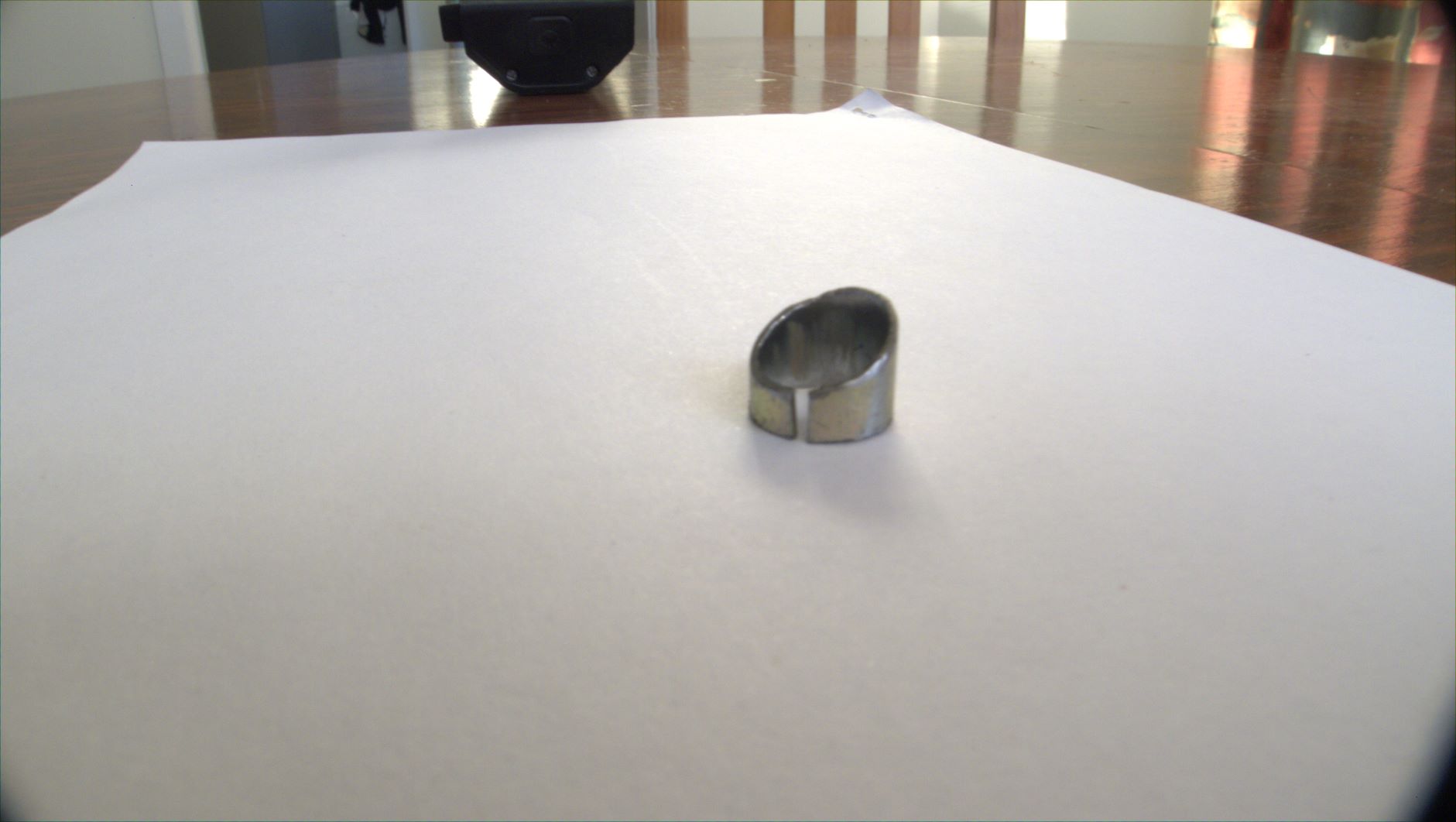

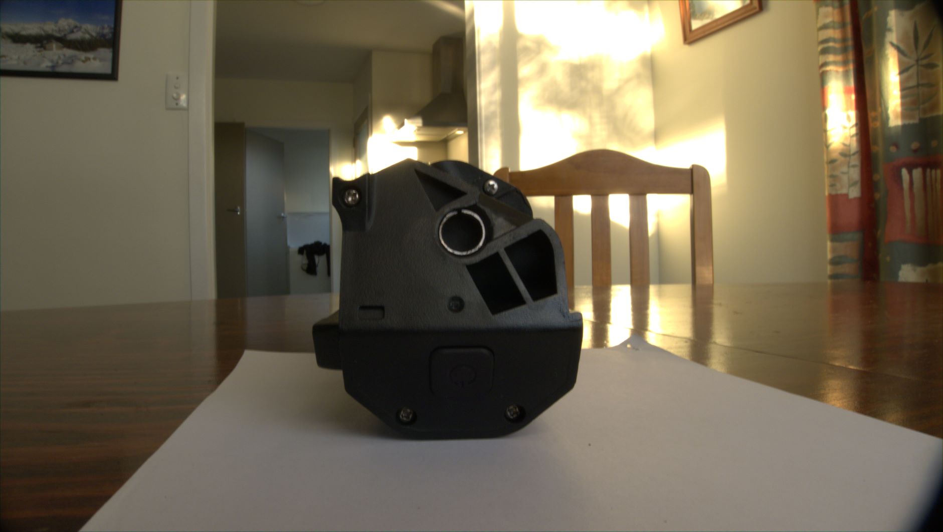

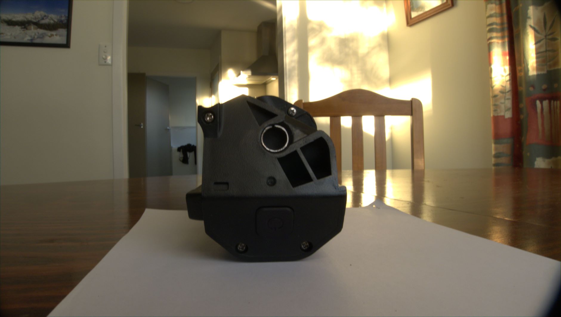

iv'e read about an issue with what is described as a power surge on the smartmotion pacer. I did experience this but discovered that it is actually a power drop-off and i have fixed this myself, it's fairly simple. The battery would shake slightly loose on rough terrain and when i reached the speed of about 25kph, the power would drop off, then kick back in at a lower speed. the problem is caused by the battery shaking slightly loose and disconnecting from it's contacts, i think this would cause a spark between the contacts and create a sudden power decrease.
I removed the battery and made a steel shim which fits into the recess on the battery where the locking pin locates which results in a tighter fitting battery. The battery cannot shake loose now and after a few hundred kilometers of testing I am satisfied that I have fixed this issue.
If you have a smartmotion pacer, you can check your own bike by simply locking the battery into the bike then try to pull the battery sideways from the top, if it moves just a millimeter then this is what can happen when you are riding the bike, all it takes is just a few bumps or pot holes in the road to shake the battery enough to slightly disconnect the battery contacts.
I can provide photographs of the shim that i made and how it fits into the battery locking pin recess if anyone is interested in trying this easy fix for their own bike.

...This collar/shim is made from a cut down 10mm dyna bolt collar and as you can see it fits into the recess on the battery where the locking pin locates, this simple fix will prevent the battery from shaking slightly loose, any disconnection of the battery could cause a spark between the contacts and result in an intermittent power loss.
