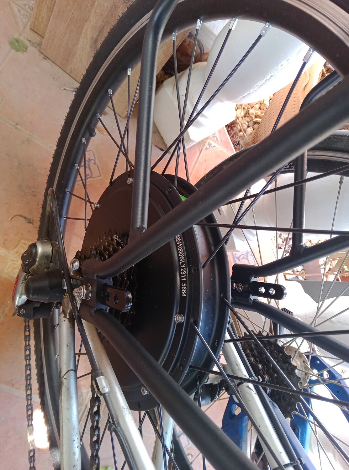

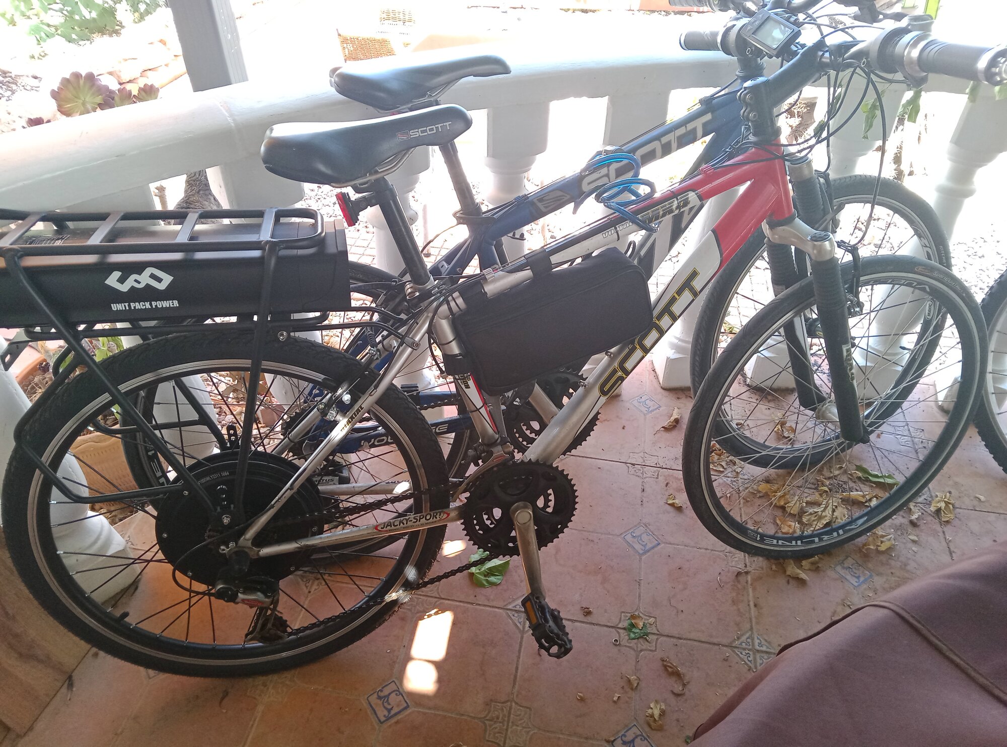

I converted my (old) Scott to an ebike . Drives well but really heavy . 48V 1000w
