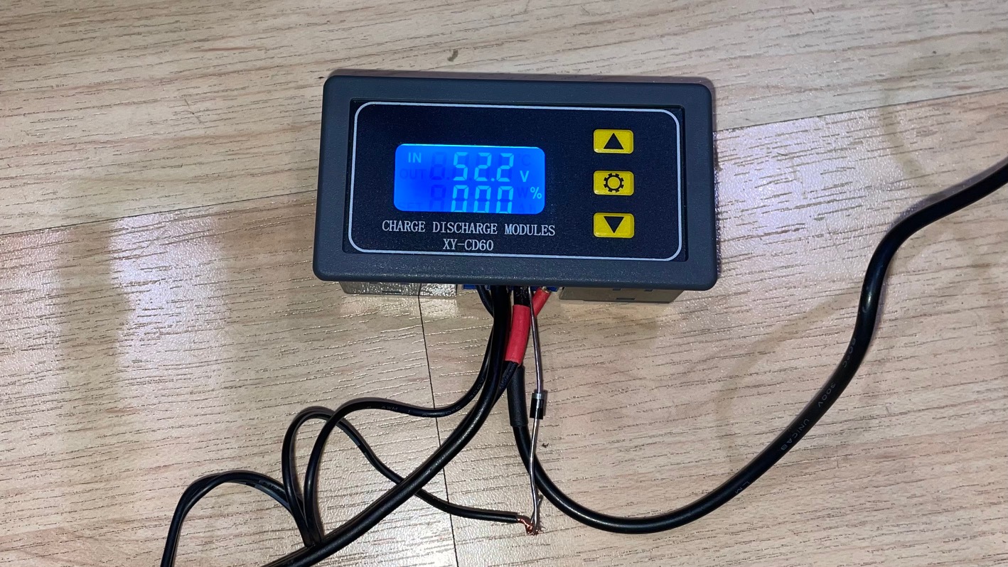

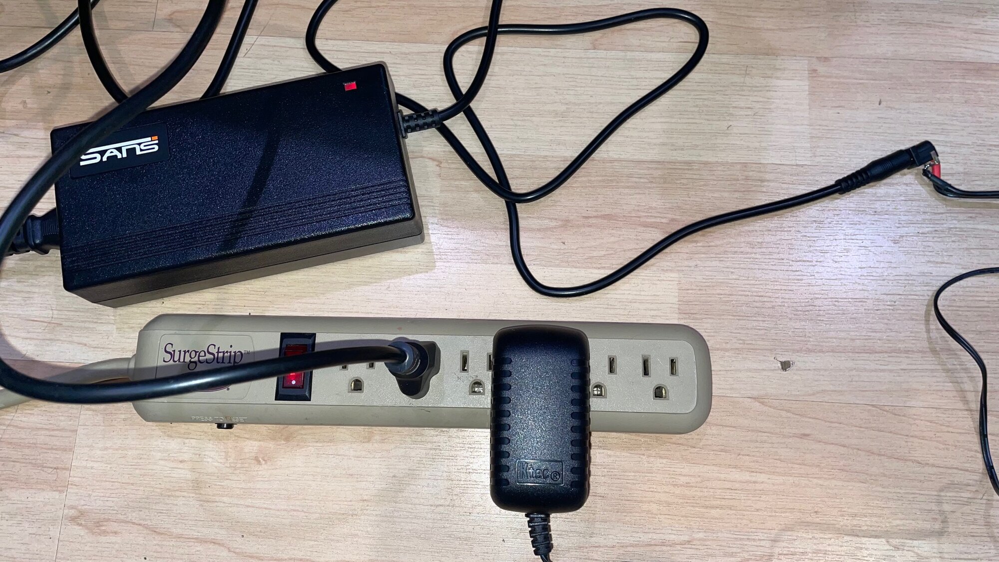

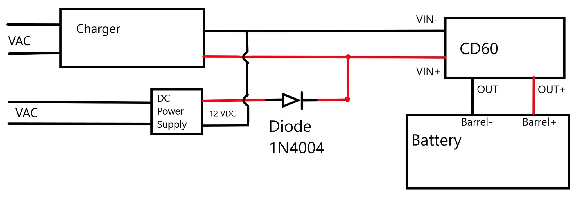

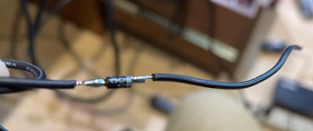

I just got it working in a round about sort of way. Please forgive the poor drawing quality, I only have Paint Shop on this PC.
Here is the mockup:
The diode is there to keep the charger current from going backwards into the 12 volt power supply (it may not be necessary, but why not). It also may be prudent to put a 2 amp diode on the charger as well, but I really doubt that the power supply will hurt the charger. The 12 volt power supply keeps the CD60 alive when the charger and battery both shut down. I need to experiment more, but I think this will work fine if but a little more tedious.
I'd welcome better ideas :)

Try the momentary contact switch (or even just any switch operated manually) with the battery as the CD60 Input.
Funny... I thought of the same auxiliary power supply solution but kept scratching trying to think of something simpler and safer.

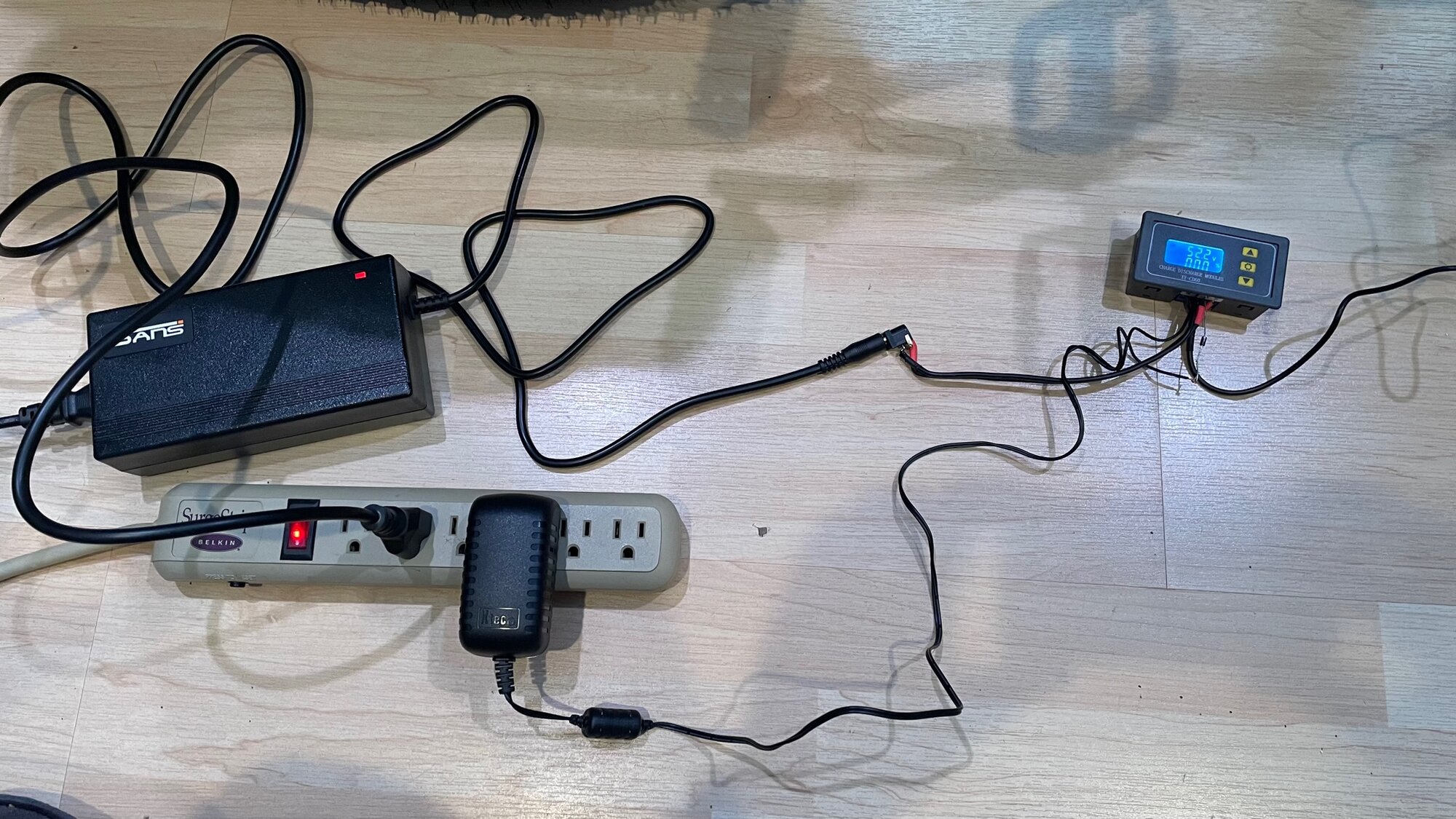

This mockup should be less likely to burn the house down:
I'll get a proper box once I've decided on how it should be done for sure. I suspect even a 9v battery would be sufficient as a supplemental power supply for the three seconds or less it's required each cycle (I have it set to 900 seconds now too). The 9v battery would probably last for years. I also went through my wall wart bin and found a 6v 0.2A transformer which takes the place of the 12v 1.5A that I had in there first.
I think the charging system this battery uses is pretty fool proof. I don't think anything bad will happen if polarity is reversed or it shorts. The barrel connection from the battery just goes dead the instant anything anomalous happens to its connection.

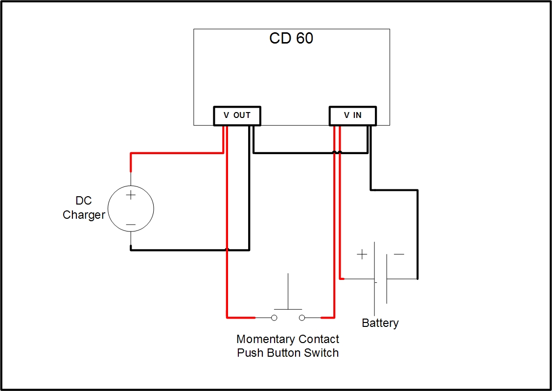

This is what I am thinking.
excuse the crude drawing as well 🙃
When you push the button you will in essence connect the charger directly to the battery. Once charging starts, release the button. It should only take a second or two.
You can test this with a regular throw switch before going through the trouble but I highly recommend using a momentary contact switch so that you don't accidently leave the switch in the wrong position on a final build. I can't guarantee that this will work, but if the battery charge port goes dead after charging stops, I don't see why not. Timing of this in the battery is the unknown...but the dOP can help here as well with any delay
What ever style it should be a Momentary Pushbutton Switch - SPST N.O. in function
let me know what you think or if something needs clarification
