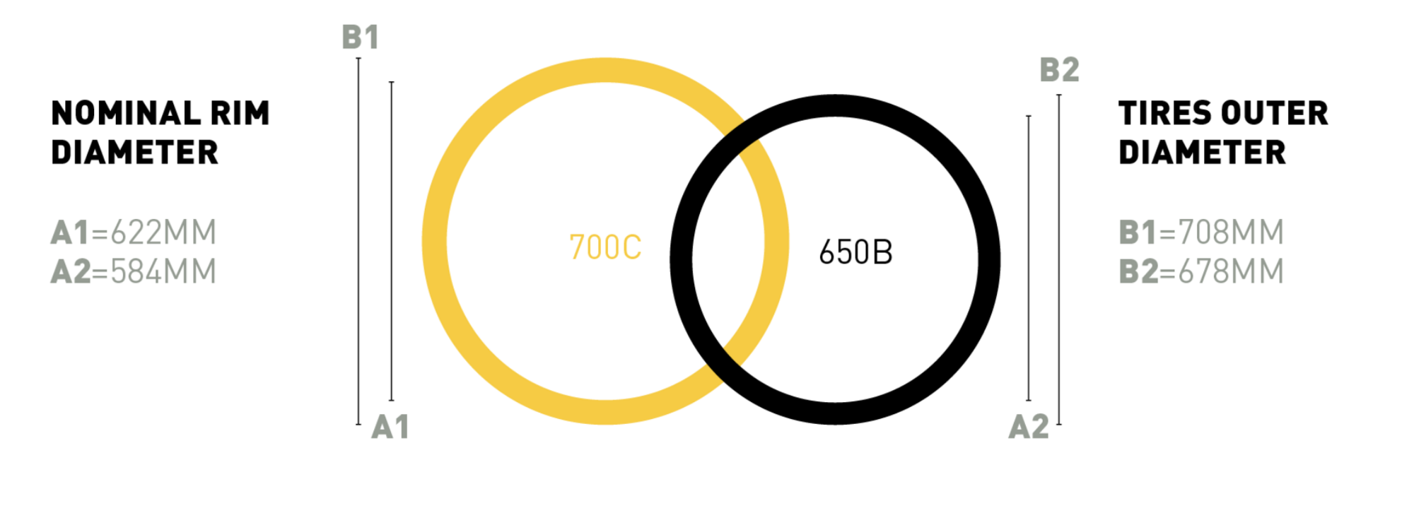

The Como has 650B wheels, the 2021 Vado 5 has 700C, the new Vado 5 (2022) has 650B and the Vado 5 SL (2021) has 700C.
The difference makes all the scraping and scuffing disappear (for me).
So, do I put on 700C?

A crank length of 170mm is standard on the Como and Vado, however, on the Vado SL it is 172.5mm
But the BB Height is 275mm on the 2022 Como, 285mm on the 2022 Vado, 270mm on the 2021 VadoSL, and the older Vado 5 (2021) 285mm
With all of the "geometry", I'd almost need to perform a specific visual comparison and real-life test to discern the variables.

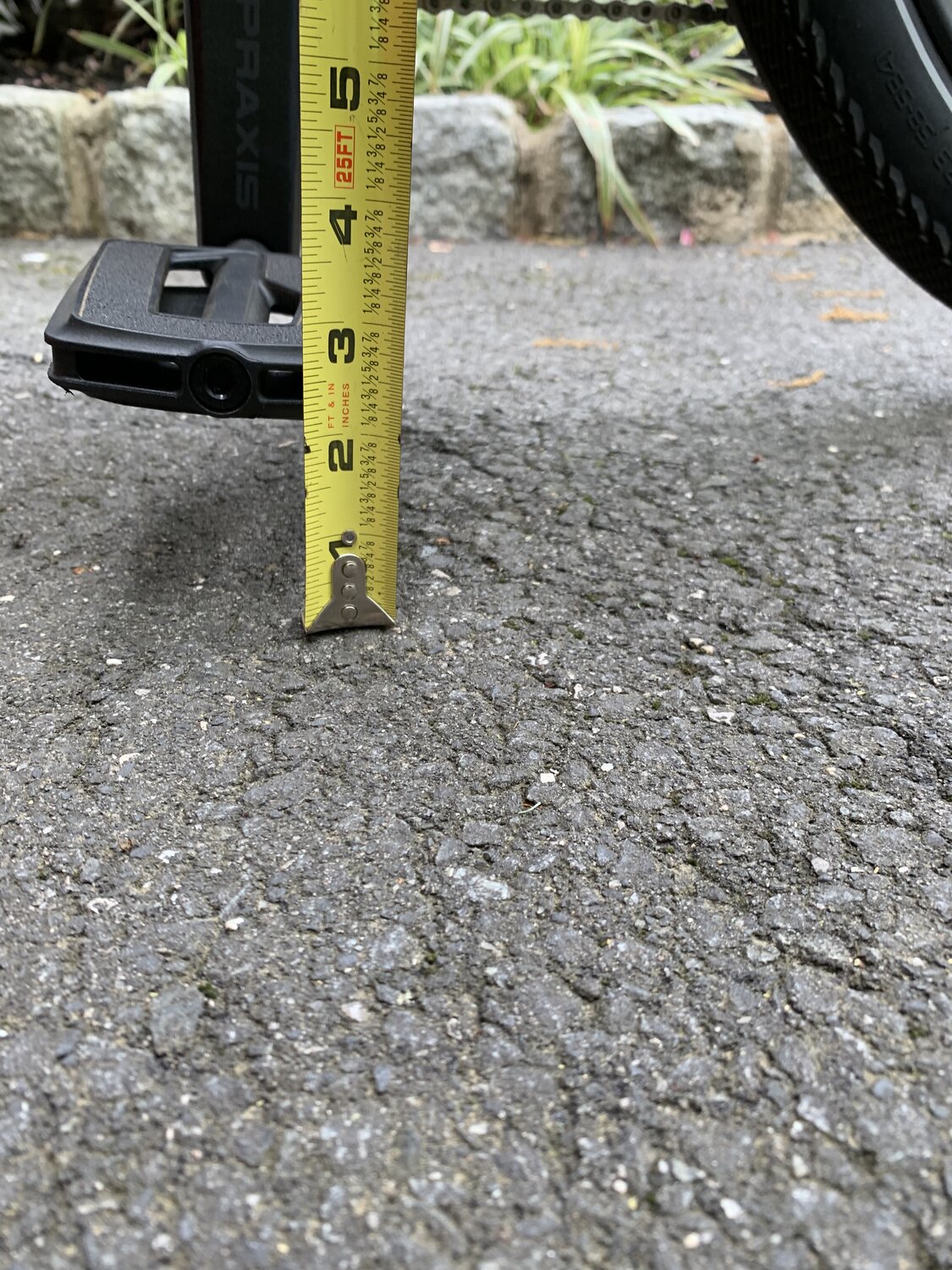

This is the pedal strike clearance on my wife's Como 3.0 Low Entry, Quite a difference.
