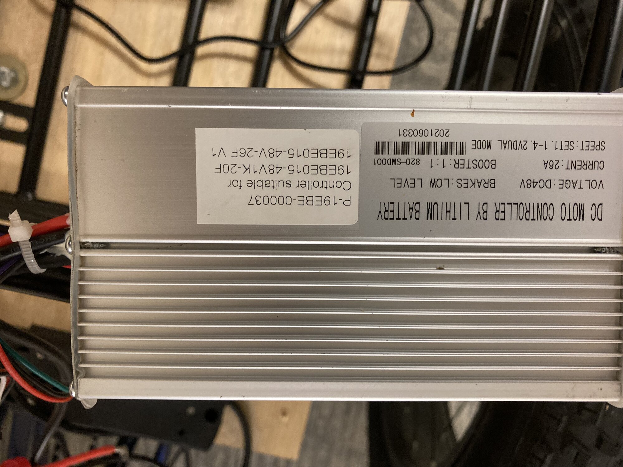

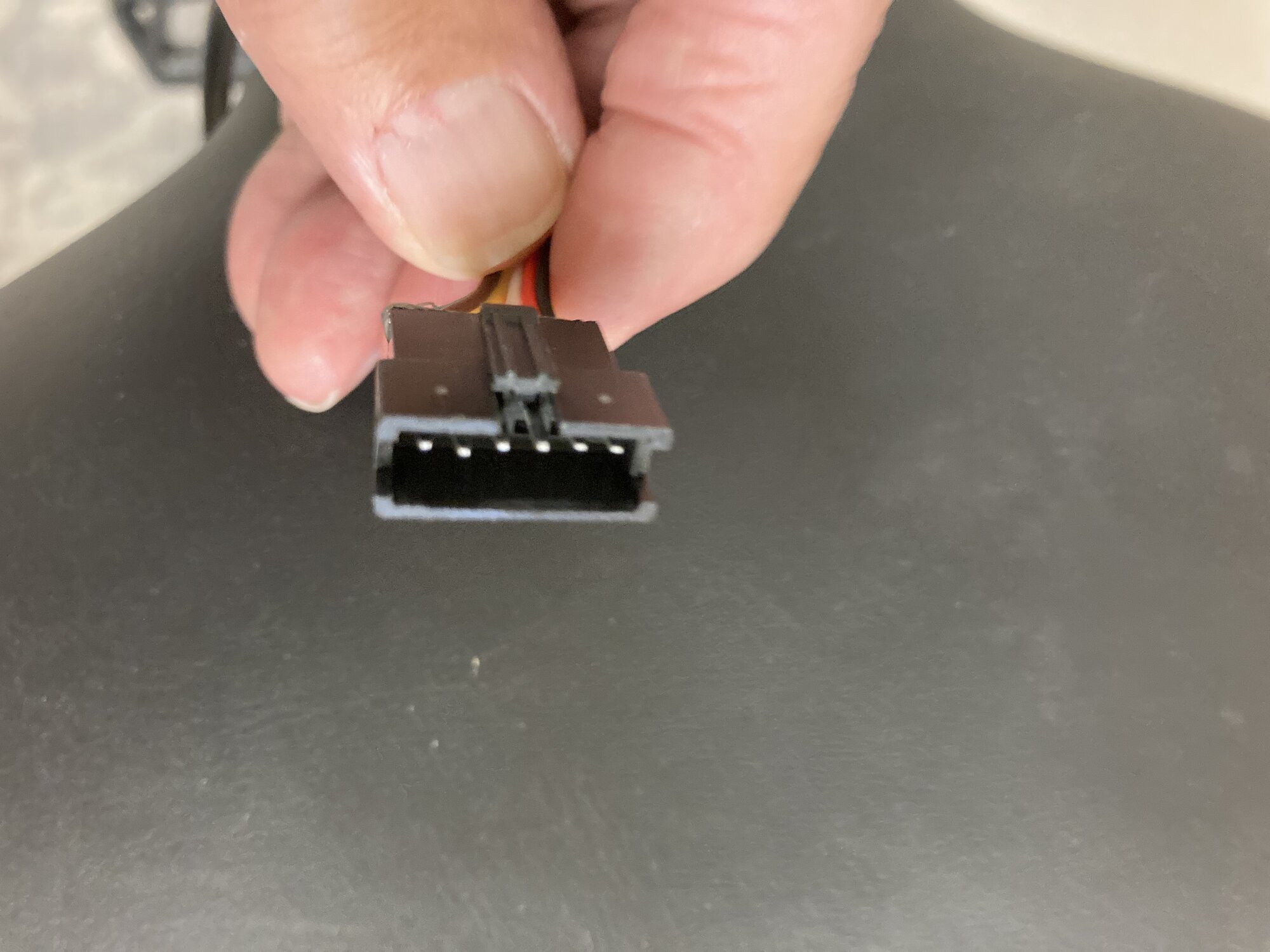

I need to find a controller with a 5 pin throttle connecter?
To put the question in context, he already built an etrike, and the battery life is poor.
He also bought a new controller, but I don't think he got the display for it.
As far as the throttle, he needs to post more info on the throttle. A basic throttle only needs three wires, and most controllers, including that Brainstorm model he shows in another post, has a three pin connector for it, When a throttle has a voltage indicator (LED light or LCD numbers), or a start button, you get extra wires, Those have to be broken out of the throttle harness and connected to the appropriate pins on the controller. Then more info on the controller inputs is needed.
