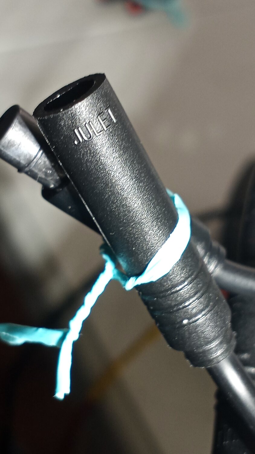

The problem I'm encountering is that the display uses a (it seems) custom 2-pin Julet plug that looks like this
with a Tektro EL555-RT lever. I couldn't find any brake system with that. Is cutting and connecting different wires the only way to do it? And how sure are we that it'll work?

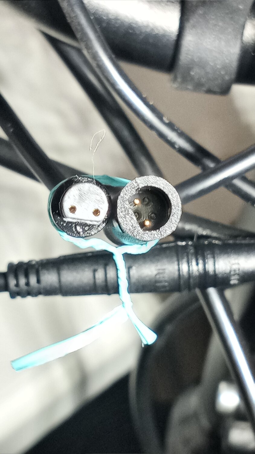

Yes the same bike as mine in the Plus variant has Tetro HD350 brakes with the same plug but with an additional pin (and another display).
If you can test the current connector and find the wring diagram of the other Tektro, you should be able to figure out how to wire the new connector on it to be compatible with your display.
Again, normally all the brake lever does is open or close a circuit, so as long as you run the existing two wires to both ends of the switch of the new brake it will work.
And if you cant find the wiring diagram, you can simply test the connector of the new brake when you get them, to find out which two of the three wires behave the same way as your current two wire switch.
One possibility is that the new Tektro have both a NO and NC switch, so they give ou three wires, you have an NO switch between two of them and an NC switch between the others. Once you test, you will know which two wires to use to rewire on the two wire connector.

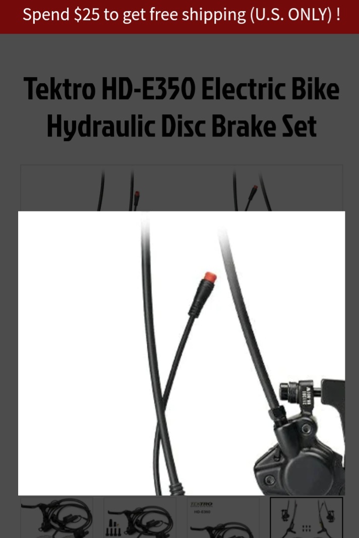

My ET Cycle T1000 has Das-Kit components and Tektro MD-E350 Hydraulic Disc Brakes.
It also has the weird Julet 2 pin brake cut-off switches,..
I searched for Tektro HD-E350 Hydraulic Disc Brakes and it appears to have the regular Higo/Julet 2 pin connectors.
Red connectors are 2 pin,..

I installed a KT-LCD8H display and controller on my e-bike, and the KT display has the orange 3 pin connector inputs for the brakes.
Only two of the pins are used though, and I just had to find which two pins to use.
I was lucky and had the correct NC/NO operation of the switch, so it's working fine. (I forget whether it's NO or NC?)

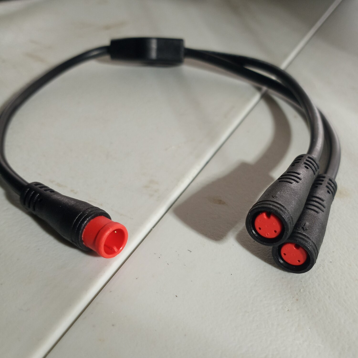

You could buy one of these Julet cables to cut into to make a connector,..
Or just a 2 pin Julet extension cable.
You would just cut the connector off that you need, bare the wires inside and connect them to the other side.
You could also just cut the red Julet connector off of your new brake levers, and cut the connector off the display brake input and just connect the two wires together, but you may not have enough wire length, and you wouldn't be able to unplug the brake switch.

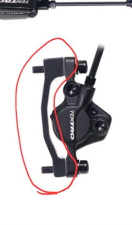

Keep your disk size in mind when you're ordering the hydraulic brakes.
My disks are 180mm and come with the appropriate sized caliper spacer included.
So, if you've got 160mm rotors you'll need a different spacer.
Or you can upgrade to a bigger brake rotor if your ebike has enough space to fit them in without hitting anything.
Some ebikes have different sized rotors on the front and rear.
Or, you might be able to use your old spacers on the new calipers, if they are a different size, but you might need different length bolts to fasten them down?
