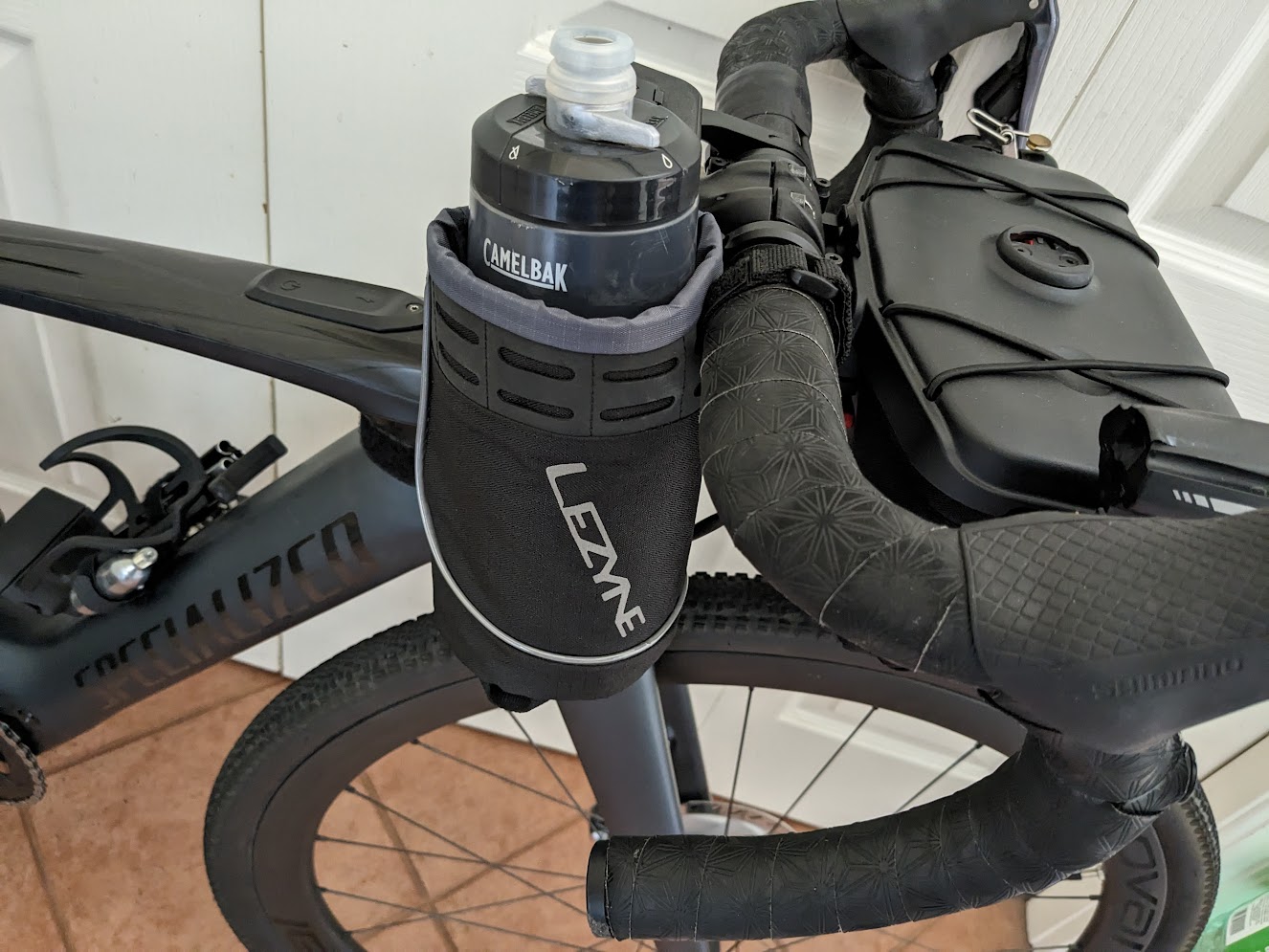

Insulation is just so-so in the bottle holder. I ended up adding a feed bag which adds a second bottle location and more insulation and it definitely keeps things cold longer.
Another vote for the feedbag. I ride with a Lezyne Stuff Caddy on my Creo that I use to hold a third bottle if needed.Insulation is just so-so in the bottle holder. I ended up adding a feed bag which adds a second bottle location and more insulation and it definitely keeps things cold longer.

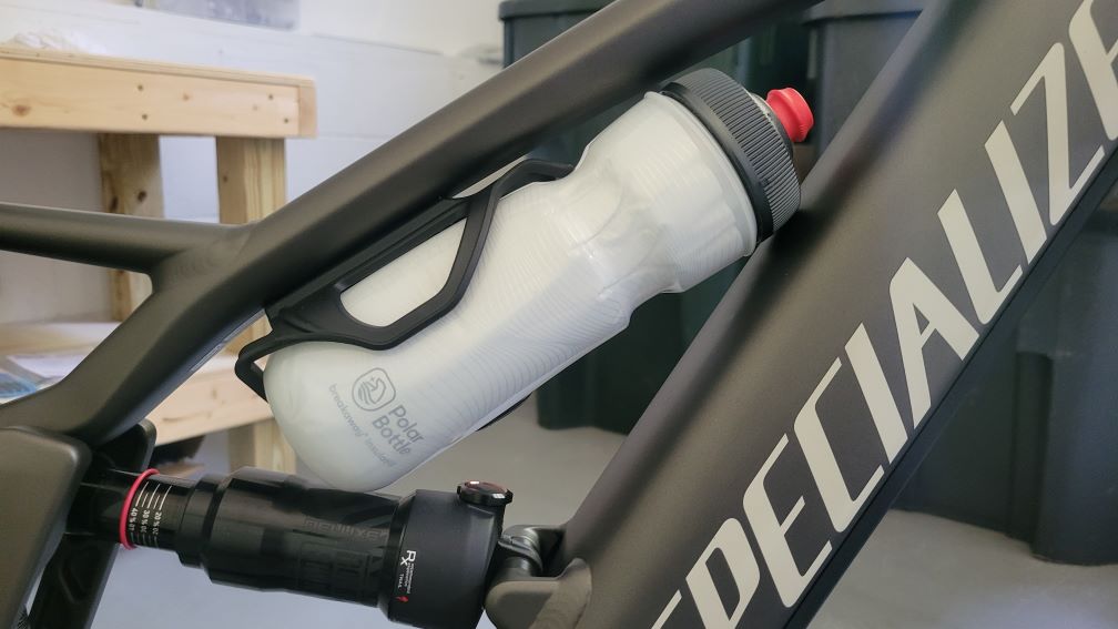

That's the ticket right there. And yes, that's a tiiiight fit. Thanks!I have the Tero X 4.0 too and finally found a cage and bottle that works. The cage is a Lezyne Side Load and the bottle is a Polar Breakaway Insulated. I ordered the left side load cage. Since it's mounted upside down, I grab from the right side. The Polar bottle is about 9.125" tall, so it's a tight fit but does work well. This bottle is a 20 oz size, so you don't lose much from the more common 21 oz bottles.
It fits on my Tero X 6 with this Topeak Ninja Master+ SK+ (left handed) bottle cage (note handedness is backwards from what you expect because the cage is upside-down). It looks like the one recommended by @RobSC would be better because it holds taller bottles. The slight advantage of the Topeak Ninja one is that there are accessories that mount on the bottom (I have the toolbox) which use the extra room between the bottom and the shock.*** I didn't think the bottle you mention above will fit on the frame of a Tero 4/5/6? On my 4 I have a right hand bottle cage and have to use a smaller mini bottle. The "feed bag" you mention above is it basically a steering stem mount bag of some sort? Thanks.
