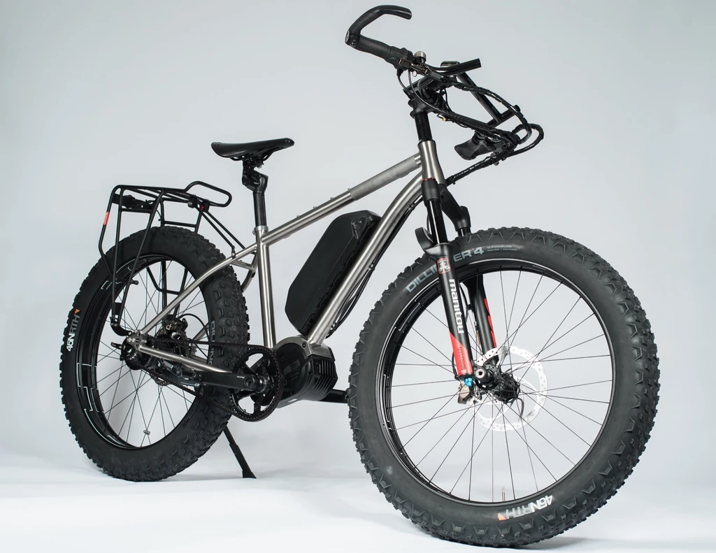

If you can stretch your budget, WattWagon builds a powerful machine available with a Bafang 3000W motor and dual batteries.
The Cross Tour is well equipped with the powerful Bafang Ultra motor, the Rohloff Hub, Carbon Gates belt drive train,
custom Miranda cranks, stopping power of the Hayes Dominion A4 brakes, with a 203mm front / 180mm rear rotor.
