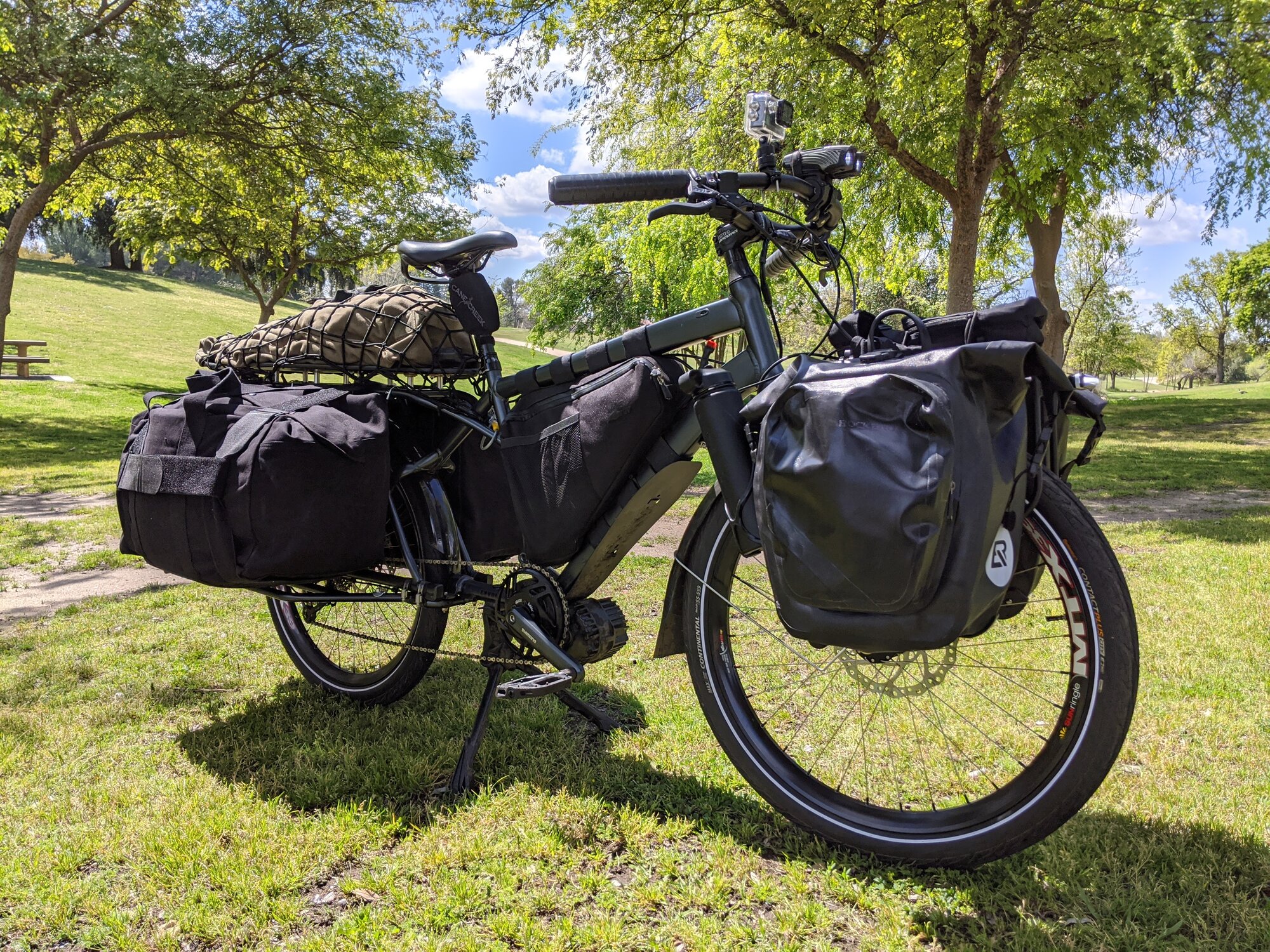

I love my bike! Zoom in on it. This one is steel. Just took it for another spin, smooth as hell. Quiet. I just winterized it. The whole drivetrain is new including the motor. Tire rotation and new battery. Ceramic lube on the extra-wide chain.

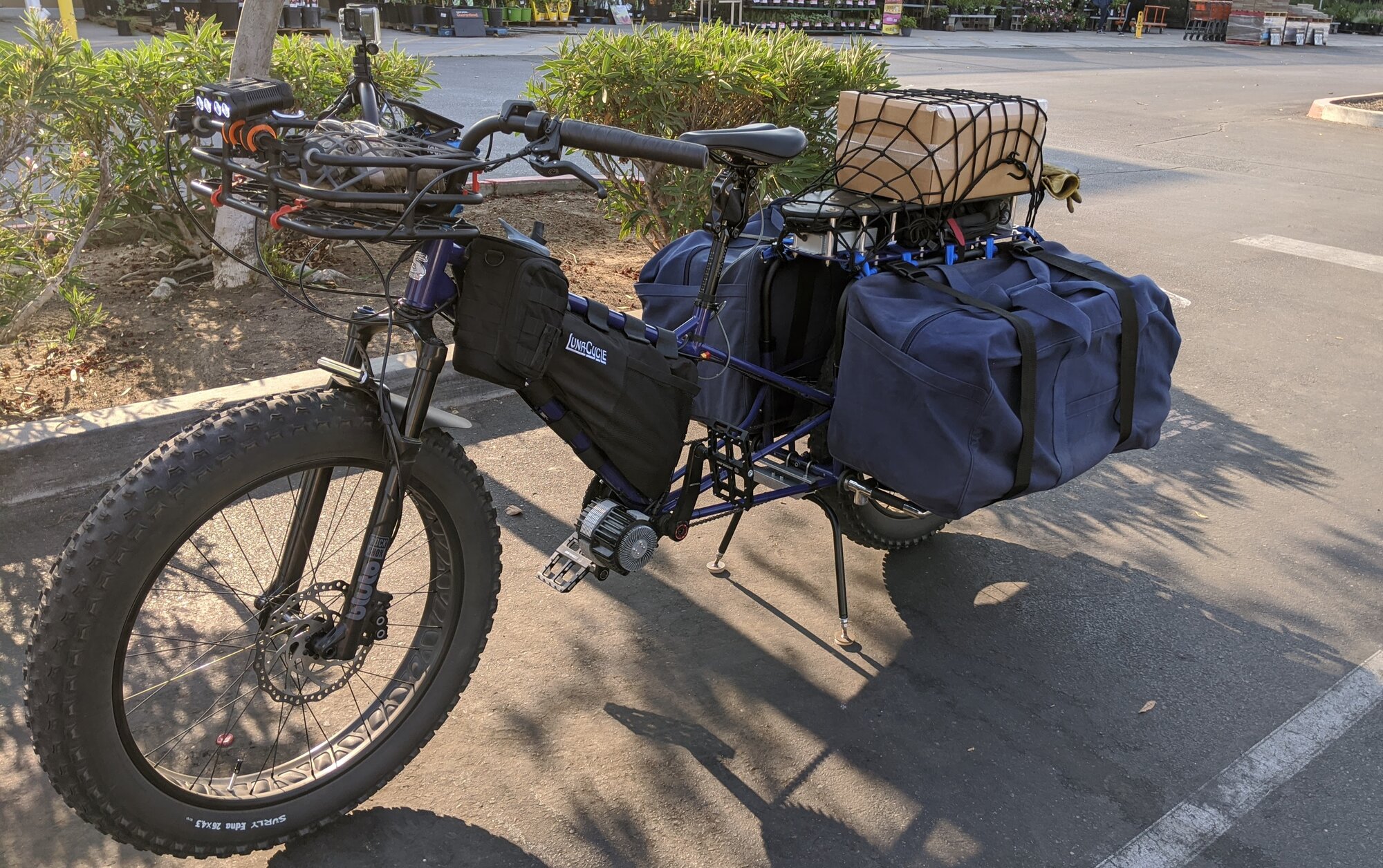

Yes we do :) Try carrying the contents of your Costco cart :) . Costco is in Seaside down in the flats and I'm at the top of the hill on the tip of the peninsula. Heck, just the trip down to Lucky in PG and back with a full, normal sized shopping cart is enough to answer the question. The one on the left is my Monterey Bay bike. Smallest of the bunch with only 78L cargo space per rear pannier. About 20L each for the front bags although since they're on the front, you want to load with just bread and chips to keep the steering easy. The bike on the right is my former Costco bike and I've had it filled with 36 paks of soda that turned out to weigh over 125 lbs. Those bags unfolded carry 138L *each* and are supported by the wideloader framework under them in addition to the dowel suspension and the straps. Weight of the bike with me on it was in the ballpark of 525 lbs and riding speed was 8 mph when I worked up the courage to go that high.
here's a shot of it more fully loaded, albeit just with pillows and sleeping bags on this trip. The BFD on the right just had storage bins in it on this trip so not heavy. But no 41 lb bike is going to have this level of auto-replacement utility.

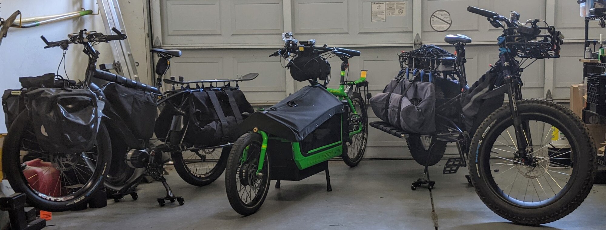

Back on topic sort of... the green bike in the middle is a 2wd. 32ah, 52v 21700 pack in the box under the floor. Carry capacity of 180 kg works out to just under 400 lbs, but max system weight is rated at about 450. This one is a bit scary as since weight is low and centered there is no balance issue to limit speed - only a momentum increase which you have to manage responsibly with your brain.
