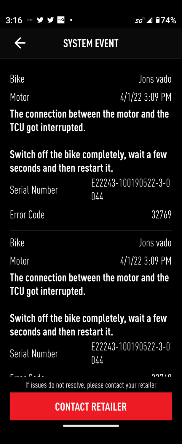

I know this is a bit old but found this researching as I have a similar issue with my vado 4.0 and looking for ideas. I get this error code.... Any updates to others power loss situation? I do feel that the battery seating mechanism is not good and a likely culprit but interesting to hear about the control unit fix.... My dealer is at a loss as to what to do and my 1 yr warranty is up soon....
Have you tried a contact cleaner on both the contacts inside the frame and on the battery contacts (with battery off)?
No but they look pristine and dealer checked that out. It's less than a year old with only 500 miles. Like some others it seems to only happen uphill....
