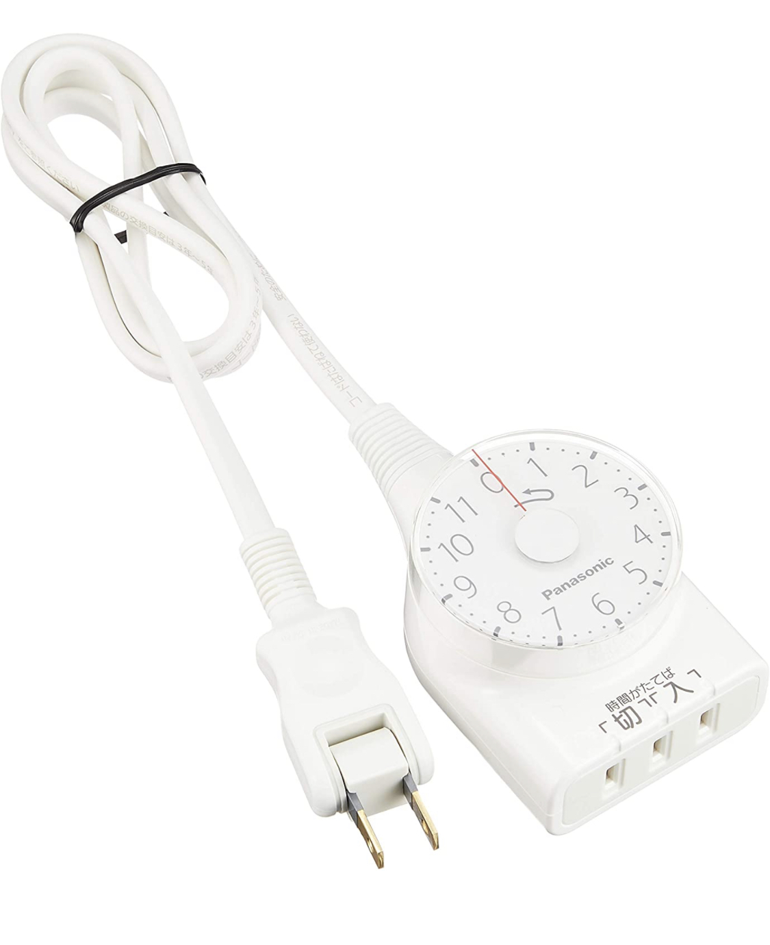

Perhaps many of the items that you’ve had in the past dozens of years were NiMH, or battery and charger combinations of lower voltage and power equipped with an overrated charger. For me, this is the first charger I’ve actually been concerned about simply because of it’s size in comparison to (for example) my Dell 17” portable workstation “laptop” which has a charger bigger than my bike. In any case I’m not worried about the durability of the charger, it’s covered by warranty. But I do have huge concerns about fires. That’s why I’ve put mine on a timer. These days I’m also running around chasing my wife’s lithium chargers too - but she’s getting to the point where she unplugs them after the charge.

I think that’s a good summary. Stefan says that the charger disconnects (electrically) and I believe that it may too, However that means you’re trusting your life and possessions on something mass produced in China or elsewhere with components of an unknown lineage. What if the charger didn’t disconnect (failure) and the fusible link worked = bricked charger. Anyways, I think they’re pretty cheaply designed and built, and I don’t trust them 😁.

Ohhhhhhhhhh. I like that neat timer. Where can I get one in the good ol' USofA?? (g)
