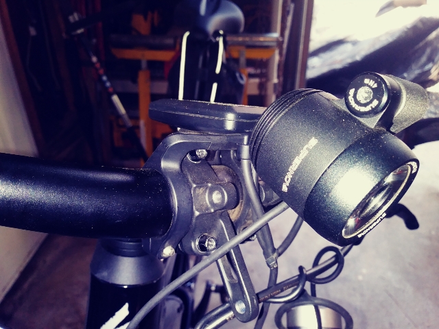

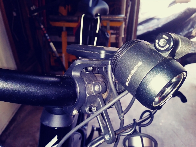

My stem mounted Super Nova headlight uses a T25 headed bolt.
My light is mounted to an extension to clear my handlebar bag. The original mounting position can be seen at the bottom of the pic.
The T-25 is for the 'side' screw which adjusts the up/down angle.
