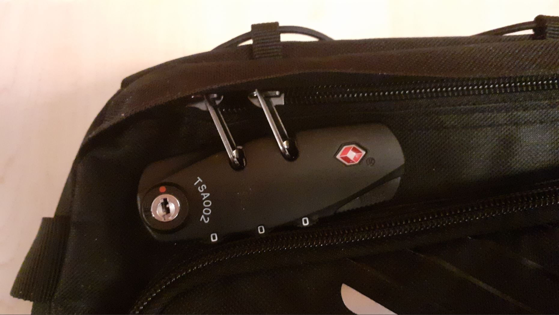

To avoid the hassle of hauling around yet another key, I picked up one of these TSA suitcase locks from Amazon and mounted it to the side of my carry bag. This is probably the smallest bag you'd want to do this with as there's not a lot of room to work with.
Adding the lock was pretty straight forward, the trick is to lock the zippers in it first and see how to best position it. Once that's done mark the holes and then make the holes with a soldering iron or hot wire. Use the screws and mounting plate together on the inside to secure the lock in place.
Obviously this isn't intended to secure the bag to the bike, but it keep sticky fingers out of the bag when your back is turned.
If you're worried about the TSA key lock being exposed, just cover it with a dab of black RTV, epoxy or hot glue to disable it.
