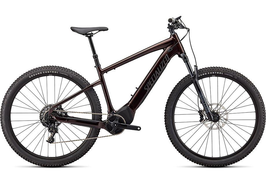

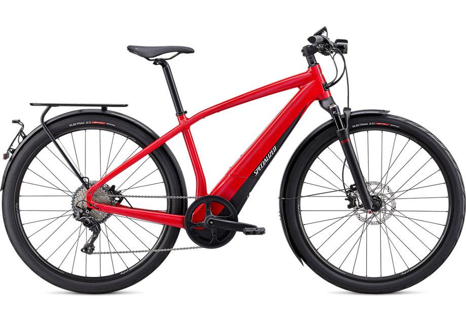

Tero 5.0 is equipped with the motor that is even more powerful than the one in your Vado 6.0. It is of course restricted to 25 km/h to be a "European bike". (Do not please think of the U.S. Classes, as these are not relevant for Norway).
Your Vado 6.0 is currently the only legal 45 km/h L1e-B Specialized e-bike. You can "go to the Dark Side" by derestricting the Tero motor. I do not want to elaborate here on the matter.
You should however consider a certain technical limitation of the Tero: it has been designed as an e-MTB. The drivetrain there is equipped with a smallish chainring that might not be replaceable with a bigger one. If you go to the Dark Side, you will soon discover you'd need to spin the cranks at high cadence to just ride past 30 km/h!

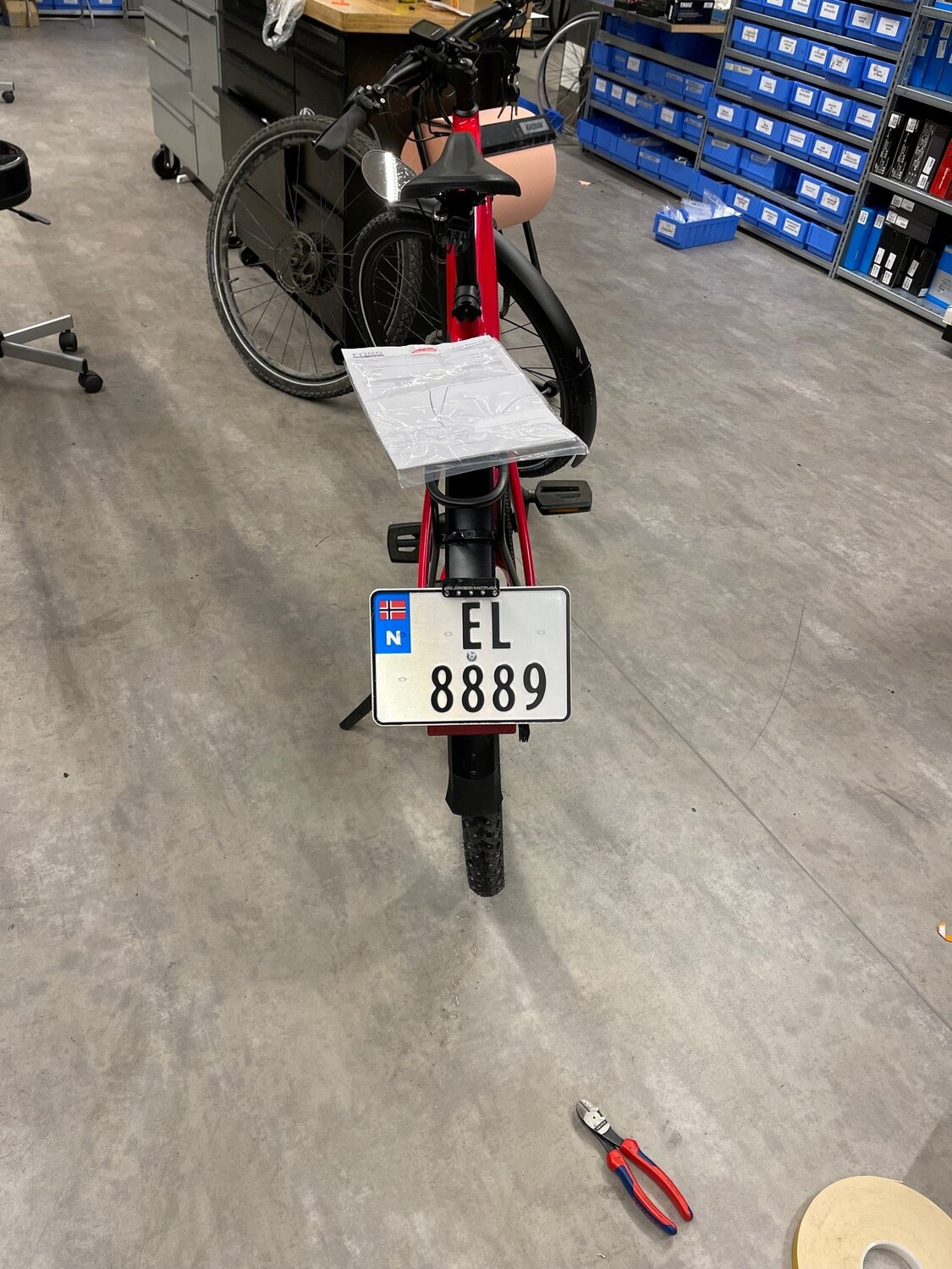

Do feel a need to update that I comply with current Norwegian/EU regulations on class 3 bikes.
My Turbo Vado 6.0 is registered as a light moped, I have plates (that I do not use) but more important is that I have the mandatory liability insurance.
Even though I prefer riding on the road, the number plate restrict me from riding on cycling roads and more. Only advantage would be that I can ride in tunnels ;)
Se picture, do look funny
