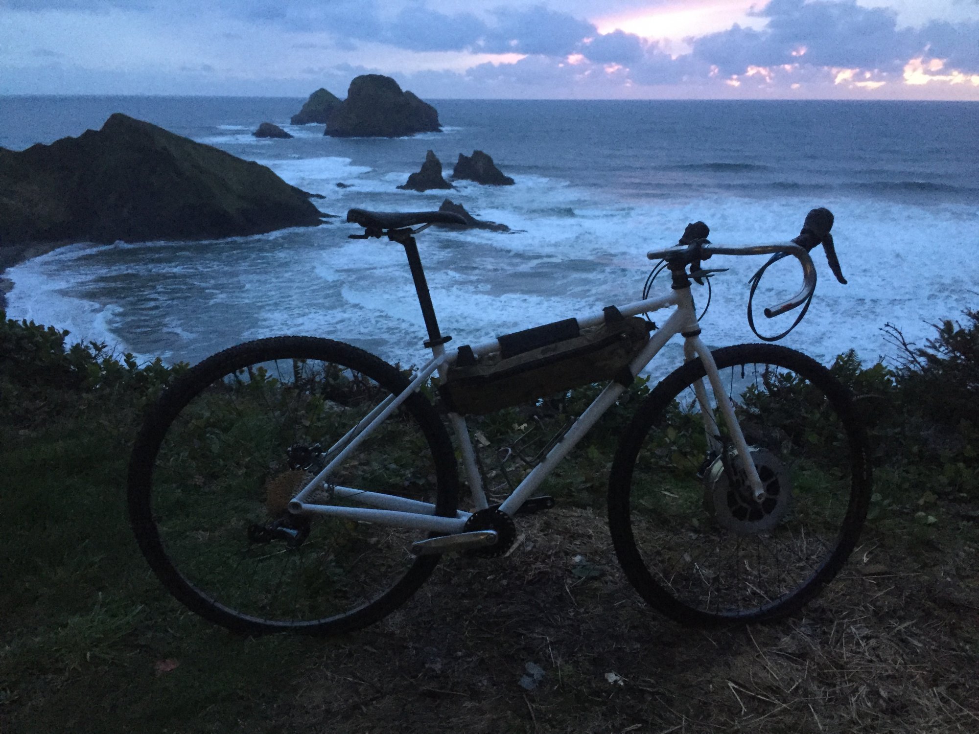

As much as I like mid drive on my mtb I prefer a front hub for the road, any road. I am just building up a bike with a Grin AnyAxle, the one front hub motor that does have QR but also adapters for any standard from 10-20. I am using a 12mm one that they were nice enough to chef up for my during a visit, my son lives in Van so it is convenient to stop in and highly recommended if you have the opportunity.
Rolling Chassis:
44963
I don't use any PAS on my road bikes but the Grin system has a cruise control feature that you can basically set your watts desired with a simple thumb throttle and pedal away as you normally would with no motor influence in the drive train. Not popular but it works, at least for me.

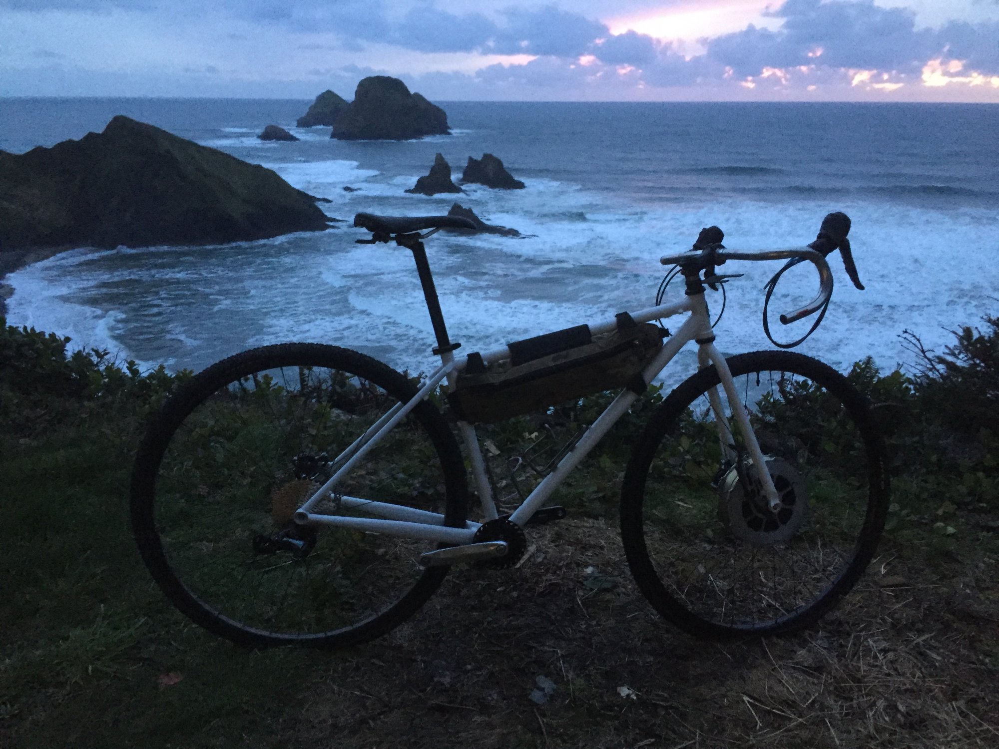

Rolling Chassis:
